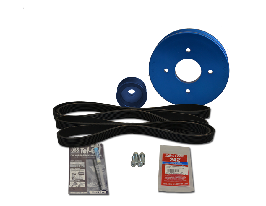

I have the standard Hitachi 55 amp alternator with a stamped pulley. I have a spare 80 amp alternator with a machined pulley, and the bracket to mount it, but have not done so yet, as I was worried about using just a 1/2" belt for this. I have looked at the Balmar Serpentine Pulley Conversion Kit 48-YSP-3GM-C, but $453.60. for two aluminum pulleys and a belt just feels like too much for my budget now based upon the other projects I need to work on on the boat.
