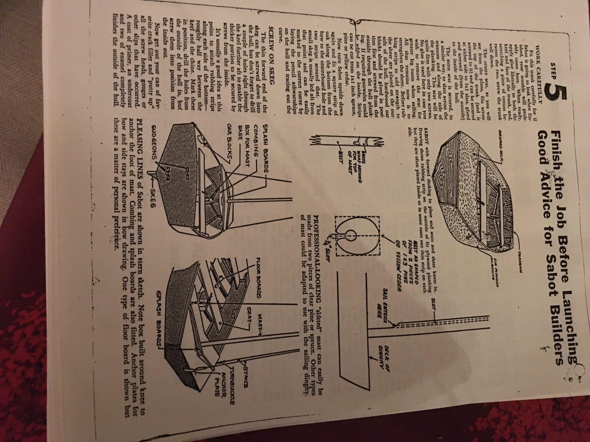

I used fir for the last one I made. Made in two halves so you can route the bolt rope slot then glue it together.
Jan 5, 2017
2,502
@9C4A65CE-F44B-4E5F-83C2-B984760E7209.jpeg the plans recommend pine or yellow cedar but.......
they don’t give a lot of detail but I think you can get the idea from this. Mast is 13 feet.

Well that brings another question. Does anyone have some plans for building a mast and instructions on how to rig it ? By the way the diameter of the hole it fits into is not 2" but about 1 7/8
Jan 5, 2017
2,502
I have complete plans. If you would like a set pm me with your address.
