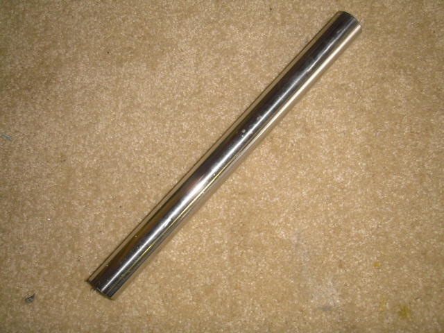

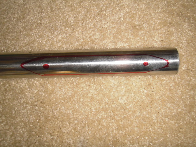

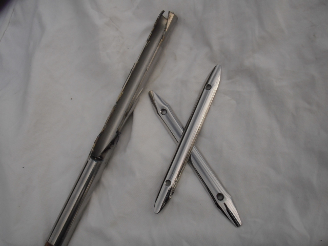

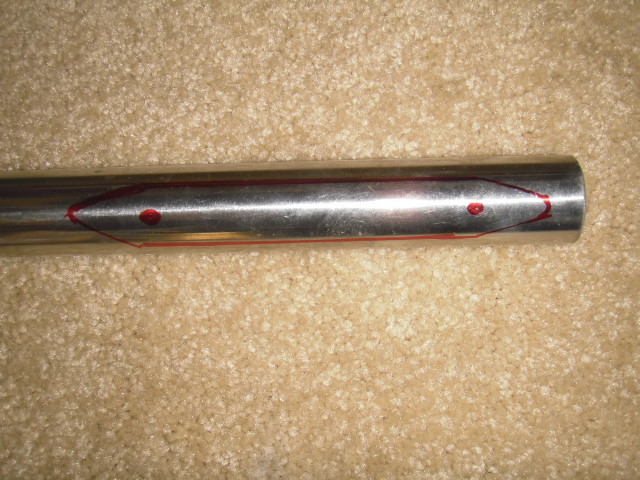

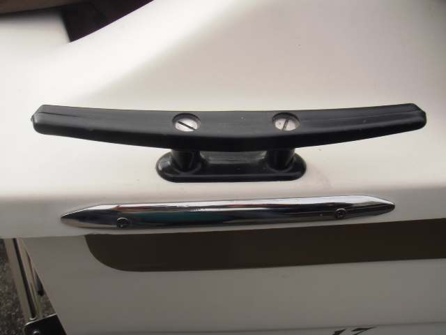

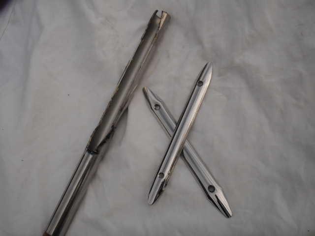

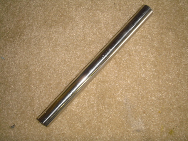

hello, i decided i needed some dock line rub strakes for my sailboat, i had a piece of 1 inch stainless steel tubing and would try make some strakes I marked the tubing with a marker, used a angle grinder and a thin blade to cut them out Bench grinder to clean them up and polish bend the ends down a bit to fit better, easier than i thought safety first cheers make your own.
