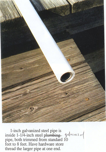

For some time, I've been mailing photos to sailors interested in building a sturdy, inexpensive bowsprit for their 29/30 Hunters. The bowsprit does a great job throwing an asymetrical spinnaker out from the mainsheet, preventing blanketing and opening up slightly more angle downwind. Here is one photo to get you started. For more photos, email me directly and I'll transmit all six. (HOW only allows one photo here, evidently) bodonovan@vagazette.com

Uhh.. did I miss something?
Sorry, I opened a pic of a pipe, is that what I was suppose to see? Guess more info and pics would be helpful. Thanks

I wonder what the weight of such a system would weight not to mention the location of all that weight. Cliff

Photos re-posted as "Bowsprit photos grouped." Weight is simply 2 pipes x 8 feet = 20 lbs.

stem fastening of bowsprit?
