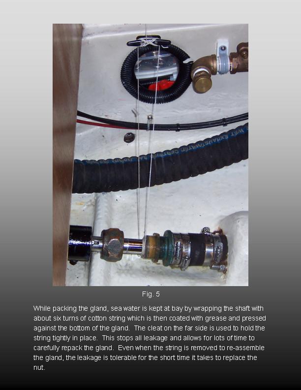

Sorry to see your predicament. THAT is the stuff from which heart attacks are made.
Without any other source of water leakage other than what you mention, I would suspect the gland to be the #1 culprit.
As Stu mentioned, the gland can be easily packed in the water as long as you have everything at hand. An assistant who is mechanically inclined would also be a good accessory to have along for the first try. After that, you can do it with one hand tied behind your back (both hands when you really get good).
Likes: jrowan
24,812
Friend of mine showed me an old mechanics trick. Get a rod of suitable length. Position the end on the nut in a way so when you wack it it applies pressure in the direction of untorking the nut. Several sharp raps on the rod had my leaking stuffing box unscrewing. We did the job with a rag wrapped around the shaft to reduce the water ingress. Not much water. Pumped the bilge. Saved $$$$ on the haul out as no other projects were planned.
Good luck. It can be done safely. Good bilge pump and battery suggested.

Well I want to do it in the water Stu, but we have tried to loosen the packing nut numerous times, but it is absolutely frozen on from pretty bad corrosion. Spraying on lubricants like PB Blaster to free the nut have contributed to causing the shaft packing to leak worse, because PB Blaster is very corrosive to anything made of rubber, plastic or fibers. The next step is to apply heat via a torch to the nut to get it to fee up, which I don't dare do in the water. If the rubber seal around the back of the prop packing gets melted, it would be a real disaster. My year of C-30, a 1980 does not give very good access to the packing nut. You have to reach it with the two wrenches at an angle where the rear access panel is, & it gives you little to no leverage to apply turning pressure to the packing nut. I salute those who can get it done in the water. But with all the problems I've had with the boat leaking lately, I don't dare risk anything else that may make the problem worse. I really need to haul out anyway to do a proper bottom job. I am also sold on a dripless shaft seal at this point!
