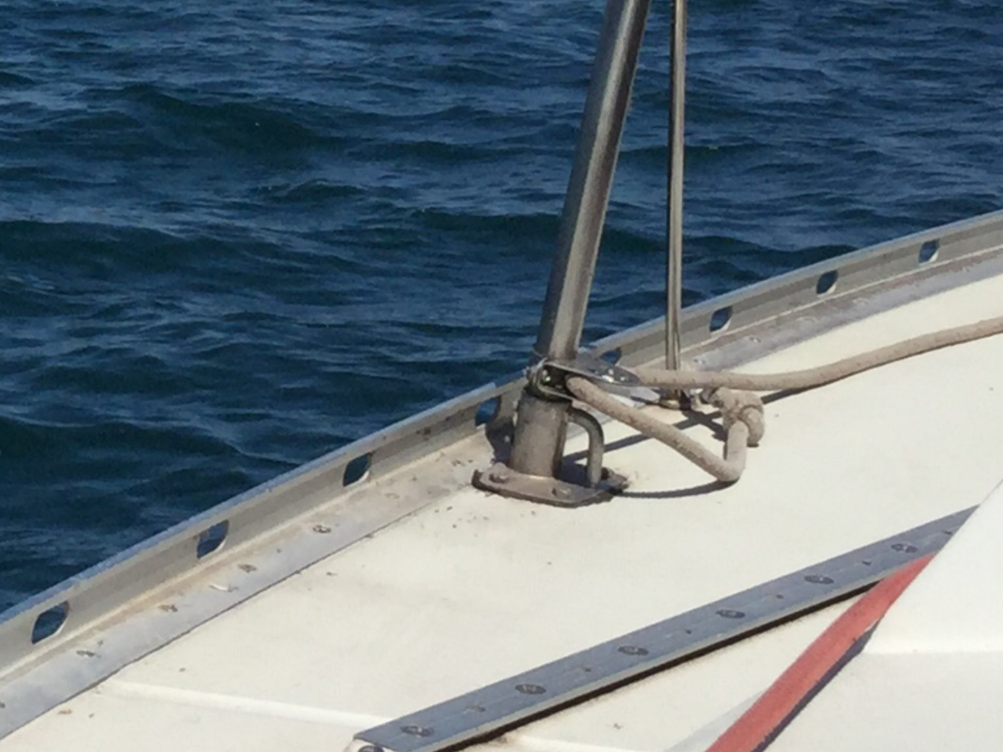

My stanchions on my O’Day 322 are removable.
I don’t have a great photo, but you can see where the base and mast are in this shot. There is a set screw facing outward that keeps them together.
I think it would be a pain in the @ss to remove them very often, you would have to remove the lifelines from the bow and stern pulpits, etc.
