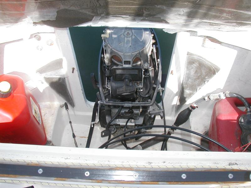

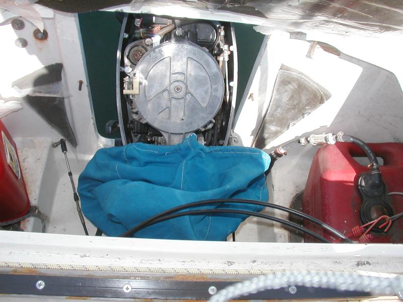

Why do you want to change it? All outboard model Catalina 27's came equipped that way. So, unless you're planning to go blue water sailing, or just want to use the space for something else, there isn't a huge reason for changing it. Look at my pictures. The biggest inconvenience is that I must remove the motor cowling to get it tilted up into the cavity. Notice, though that I have a Tohatsu remote control, electric start motor....... well worth it, the convenience of an inboard. I considered modifying the hole years ago after looking at some other owner's projects. Just never got around to it.... quite frankly.. I'm used to it now... I leave the motor down when sailing.... except for the few times we've raced... then we kick it up.

Quickly to motive. . . This is not the stock factory cutout. This was done by a previous owner and I'm not thrilled with it. Also, with the outboard up, we're measuring 28' 10" LOA and that puts us in a slip that costs about $900 more per year. That alone is somewhat compelling argument as it pays for itself in year one and keeps on paying. I understand the benefits of the engine placement but I hate the open hole in the transom and the fact that the motor blocks the rear cover from sitting properly. We'd probably have to cut some more away to seat the motor properly.
