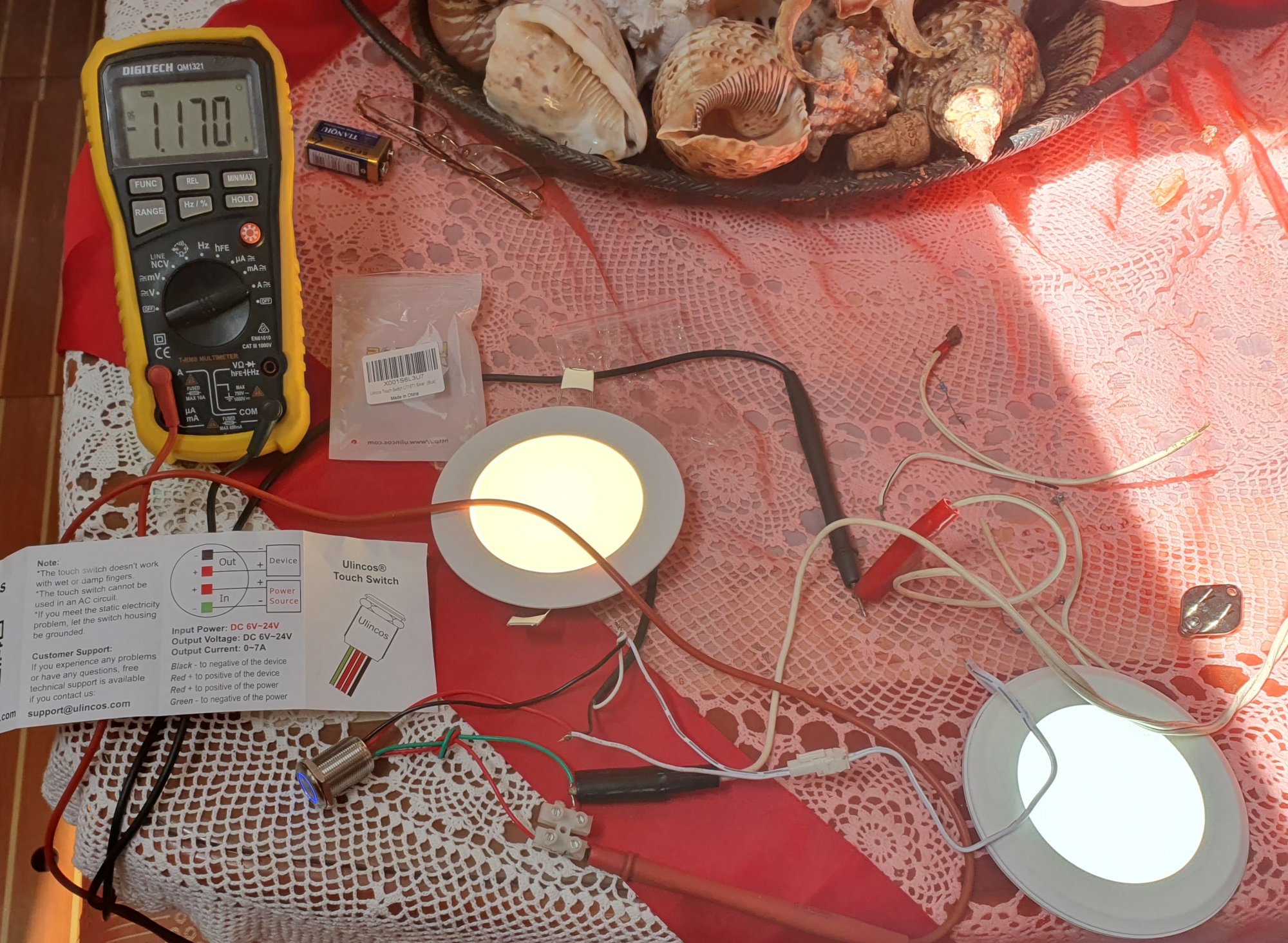

Yep same boat H49. replaced all the dimmable and non dimmable fluros with LEDS.
Very simple.
Remove the original fluro, by pulling down chrom fitting holding the strong spring clips so not to damage head linner
Remove fluro from chrom fitting by slight twist
Unplug fluro and insert almost any led light. I used 120mm dia 9W, 7500k bought in pack of 6 from Amazon
Drop in replacement fits inside chrome housing. Mine are not secured just dropped in, but probably better to secure
Connect led light via existing wiring.

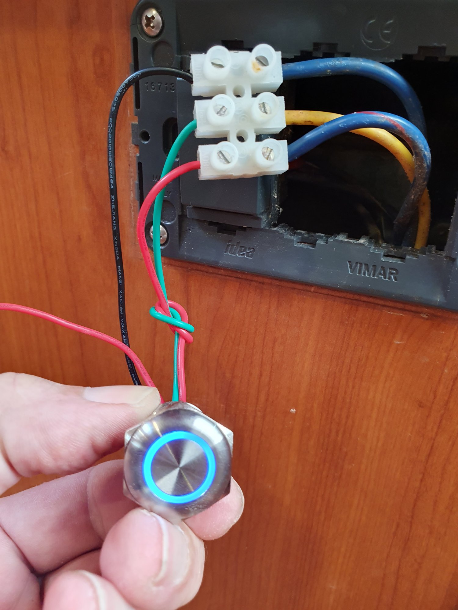

Remove old dimmer, replace as shown in image below.
I just need to clean up mounting of dimmer. I will likely replace all the VIMAR switch's
