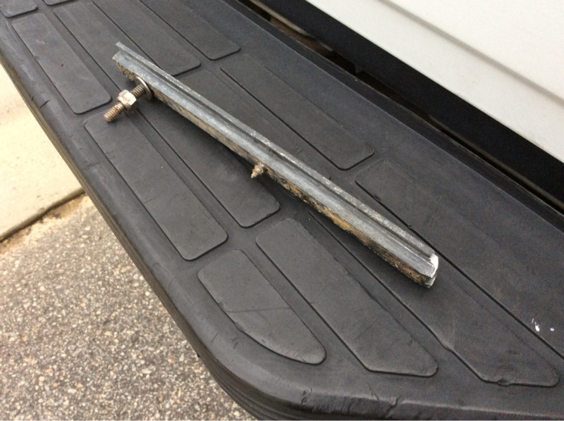

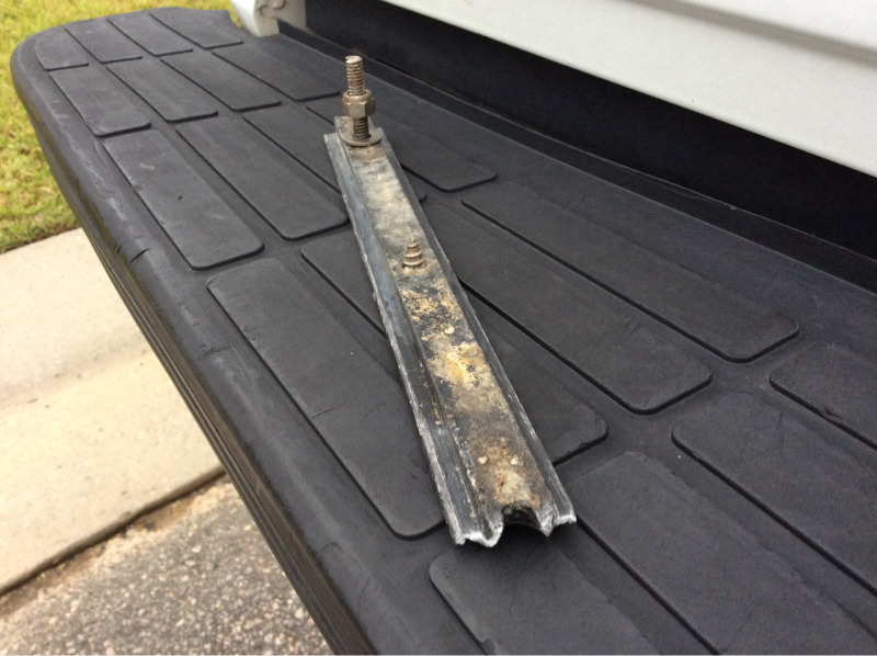

I thought I might jump in on the tail of this thread. Just a heads up, but I went to repair this track on an OD28 a couple days ago, and this is what I found. The bloke had this detach while standing her on its ear, and he says when it turned loose, it was a super nasty piece of shrapnel flying violently about the boat before he got lucky and snagged it. Take a look at number two. A damn self tapping screw that the heads match, and it was no more than a half inch of threads, and I'm being generous. I'm not picking, I swear I ain't. But if I had one of these, I would pull every plug on the bottom side and make sure it is the 1/4"-20 screw(bolt, it's technically a screw), and a nut on it. Even so, this bolt had only a standard S.S. washer for backing..

Wow, that's scary. Was the screw in a place with very limited access? Looks like somebody just plain cheated.

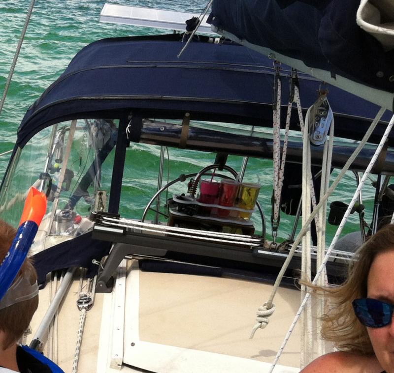

I have a Harken on mine and its been moved over the companion way hatch. The real key to the system is the track risers. These are cast aluminum and super heavy duty. What you can't see from this side is I have a curved peice of tubing on the other side and that is where the rollup window from the dodger attaches. The whole thing works pretty well.

Thanks for sharing CP...My track is a different cross section. I can imagine track flying around would be a mess!!!

Ward, that track is laying right on the bridge deck in front of the companionway. The heads of the screws looked identical, so there was no way of telling without pulling the bungs from inside. And so short even. Not that it would have helped any, but it could have been a lot longer. And some kind of backing plates.
That bridged traveler is what he has intimated would be his choice, and by the present location I would tend to agree, what with stepping past the main sheet on the way in or out. (Nice setup by the way). Truth is, this may have broke the camels back. He is now looking with his left eye for another boat. This guy knows no fear, seriously. He will sail the DOG $&@: out of a boat, and that one shook him.
