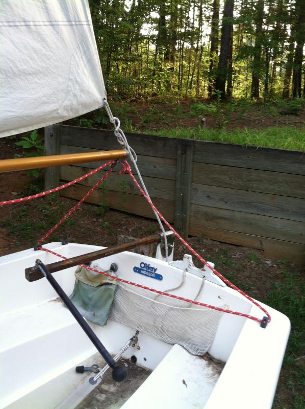

Last week I purchased a 1976 Widgeon. Today I joined the forum seeking your advice. The boat in it's current config and as shown in the brochures uses the triangle config of 1)mainsheet dead ended at end of boom 2)threaded down and through stern port fairlead 3) across to the starboard fairleads, then 3) back up to a turning block end of boom. Web lore indicates older boats used turning blocks instead of fairleads on the transom corners. There just seems to be a lot of friction with this setup. Is it appropriate to go back to turning blocks? Complicating the consideration is having seen the rope bridle setup where the mainsheet block is fixed in a central position on bridle rope whose ends are secured to the stern port & starboard fairleads. AND THEN there is the rope bridle that incorporates a free roaming traveller block! Is there a right way? My ultimate goal is to relieve friction so that when releasing the mainsheet in a gust, the mainsail will quickly dump the wind...not me! Thanks guys.
