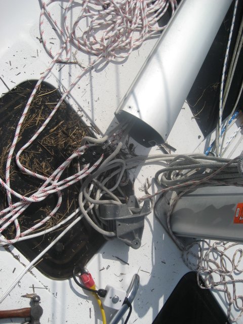

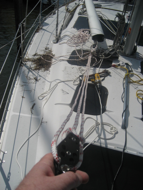

I replaced the outhaul in my 35.5 with a cascading internal 6:1 system. The original floating double block inside the boom is piece of garbage. It is responsible for a huge amount of friction and should be eliminated. Use ONLY ball bearing blocks in your new setup to minimize friction.
I replaced the entire setup through the aft end of the boom without removing the end caps on the boom.
