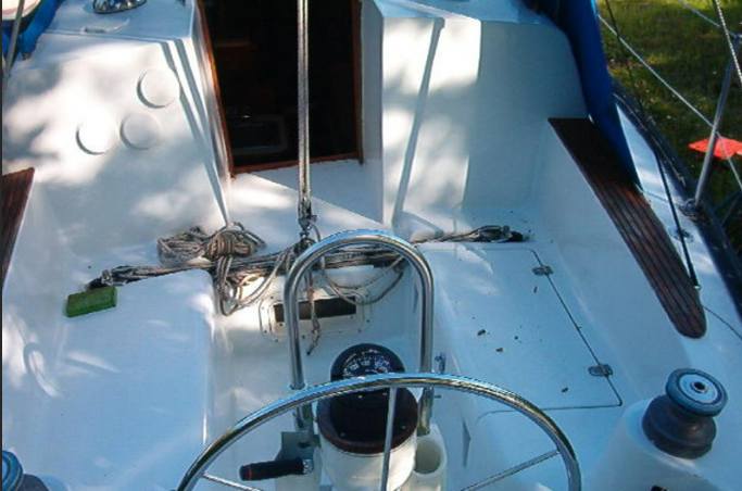

Any clever way to run the mainsheet control line away from my guests siting in the cockpit?
I would prefer not change the traveler is at this late stage in the boat's and my life.....

Sorry, I am a considerable distance from our boat. I swiped this from the net...
As you can see-the traveler is a deadly item for non-sailor guests.
Just getting the control line rerouted would be helpful.
Anyone done anything like that???

Many people move the whole traveler to an arch over the companionway, but you don't want to do that. You could switch to twin mainsheets, which doesn't use the traveler.
Oct 6, 2007
1,180
Hunter H30 1982 Chicago IL
A double ended mainsheet on the cabintop or end boom sheeting with twin mainsheets just in front of the helm are the only two options I can think of if you don’t want to move the traveler to the cabintop.
You would be getting rid of the traveler with either option.
Double ended on the cabintop gets it out of the way, except for two cabintop mainsheet lines.
Twin mainsheets would be within reach from the helm, but are still a bit of an obstruction in the cockpit and add some complexity to tacking.
