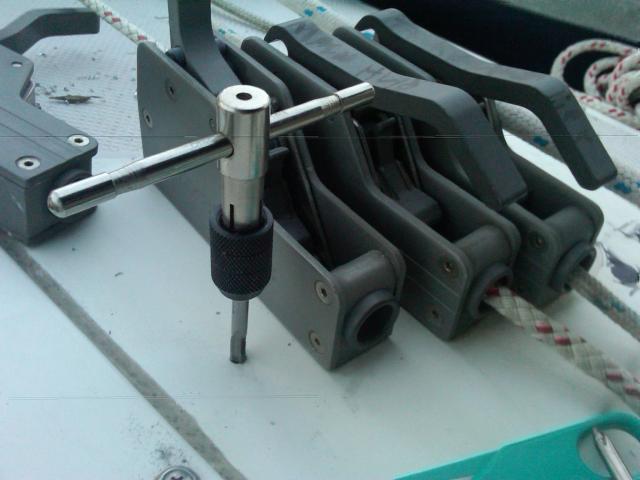

Witz, Silvio, I do usually sail with my Dodger on. It has slits cut into it to allow me to work the traveler lines and pop them out of the cam cleats when I need to. Still working on modifying my traveler to get the lines to one side. When racing it would be a big help to the crew to have the controls for the traveler on one side. All of the new boats (309 and 355 for sure) have them set up that way. As for the main sheet I have my addition with the jam cleat and the cam cleat both there using the original holes. I just don't have the talent of a PaulJ to tap a new hole for just the cam cleat everyone else is doing, but my tablesaw helps me look a bit more talented.

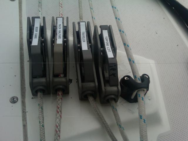

Harry,

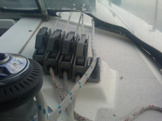

Mine is #223. I purchased the boat in December from the original owner. Everything that I have encountered looks like it came from the factory. The PO may have made requests of Catalina that I am not aware of, but it all looks original and not modified. I never met the gentleman in person but looking at the boat it would appear that he was set up for single handing which works with me since I am usually solo.
This weekend will be my first outing with the new set-up. I suspect it will work really well for my sailing style by giving the option of cam cleat or winch to control the main. I don't race or sail very agressively, mostly I go from point A to point B ,fire up the grill and toss out a fishing line. One thing that I did notice while adding the cam cleat is that the rope clutches were all individually aligned but they don't seem to point very accurately. Makes me wonder if the PO may have juggled a couple of the lines in the clutches, I have them now so they are leading as fair as I can get them without re-bedding all 9 clutches.
Silvio
Dec 1, 2010
61
Catalina 310 Solomons Island, MD
Silvio
Did not look close enough.:yeah:
paulj :troll:
HAHAHAHA, excellent label !!
After seeing the pics that I posted, and the other magnificent labels displayed, I actually removed the labels from my rope clutches, cleaned off the black sharpie writing and re-labeled them all (straight thistime). Talk about peer pressure :redface:

Hey Stu,
The 310 comes standard with a CLAM cleat on the cabin top to control the main sheet, many of us are replacing this Clam cleat with a CAM cleat, either with a swivel or an extreme angle fairlead to get a fair lead to the winch. It is WAAAAYYYY too easy to make a typo when talking about the two. The first pic I posted is my original set-up from Catalina using the CLAM cleat, you may notice that the cleat is missing the spring rope keeper, probably due to the lateral loading it would be subject to the first time the sheet is loaded and led to the winch. I am probably not alone in thinking that this is a horrible design from Catalina. :naughty:
Silvio
Dec 1, 2010
61
I should make clear in my last post that I am not implying that the main sheet should be led UNDER the spring keeper on the clam cleat, only that the mainsheet applies pressure to the side of the cleat when led either to the winch or the helm with the factory set-up. I could find only a VERY limited angle that leads the manisheet OVER the clam cleat and it was nowhere near a winch.
OK, now I'm just bitching about the darned cleat:eek:

Had the chance to try out the new cam cleat set-up this weekend. Saturday morning I went under the Destin east pass (stupid bridge, gauge showed over 50 ft and I still rattled my vhf) and out to the Gulf of Mexico. Winds were light and seas were running 1-2 knots eastward with waves about 1 foot. The cam cleat worked really well in the light winds as I worked my way off shore. I seemed to be constantly tweaking the main from the helm as I tried to keep the main working while dodging the fishing boats. By the time I got 2-3 miles out the wind was stiffening and developing a southerly component, about as good as I could hope for. I headed for Panama City aiming for the St. Andrews entrance. The winds picked up and stayed around 12-16 knots with the seas following 3-4 feet. Most of the time I kept the main sheet on the cabin top winch. Occasionally I would push the main sheet into the cleat so I could use the winch for tweaking the boom vang or something. The cleat was easy to engage with the main sheet loaded and on the clutch, there was no need to pull the sheet, a gentle push and in the cleat it would go. When I put the main sheet back on the winch the cam cleat would disengage as I tensioned the sheet on the winch. I couldn't be more pleased with this set-up. The fairlead on the cam cleat is the biggest improvement of all. The main sheet works as it should on the winch and leads nicely to the helm in light winds.
