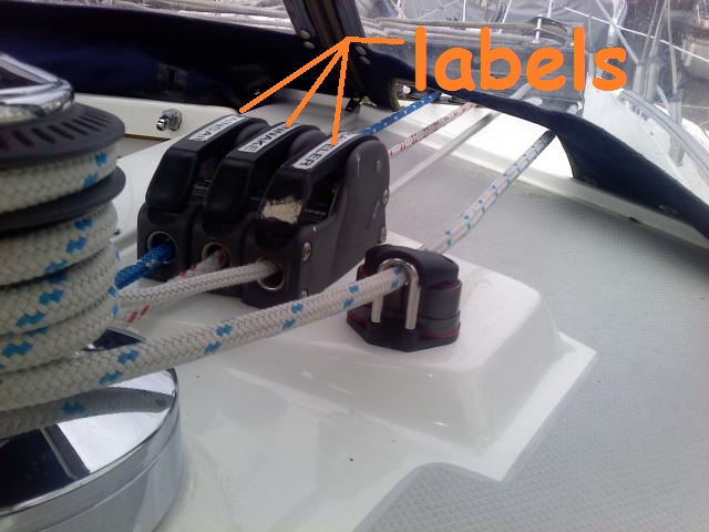

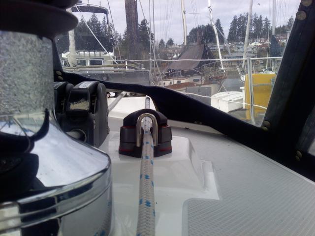

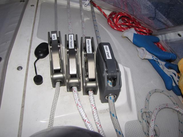

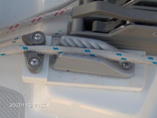

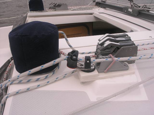

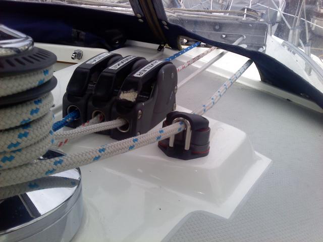

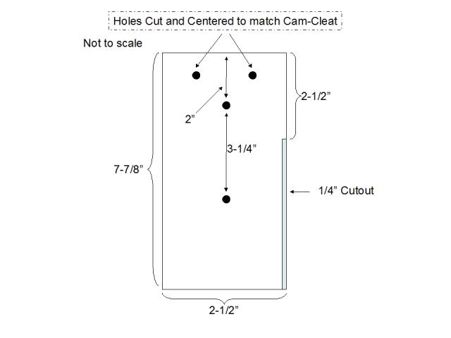

This weeks project is similar to the set up that Truckman posted only I had to make a little room to mount the clam cleat.
