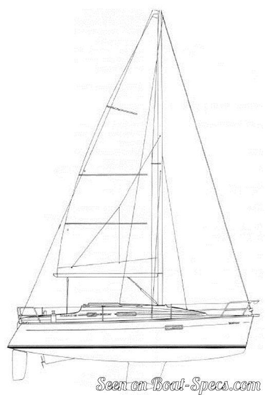

Hi everyone,
We have a 1997 Beneteau 281, with the mainsheet blocks attached directly to the coachroof, no traveler. The mainsheet loops between the boom and the coachroof and then back to the cockpit. Please see the attached illustration.
We find that pulling on the mainsheet typically just trys to pull the boom downwards, there is very little movement port and/or starboard. It's not unusual to have to move the boom by hand when centering or changing the angle of the sail.
Does anyone else have this problem and any thoughts on how to improve the performance of the mainsheet, given that we do not have a traveler?

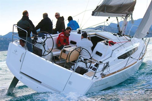

The Third solution is to rig a bridle between the two aft-most blocks, and rig the sheet from the boom to that. Dyneema and a good block. It will greatly limit the downward pull and allow the boom to get very close to centerline. I'd draw a picture but I'm focusing a great class of wine! ;^)
EDIT - Like this Jeanneau..

The image I included is taken directly from the Beneteau 281 manual.
Thanks for your advice, will look more closely at these options today.

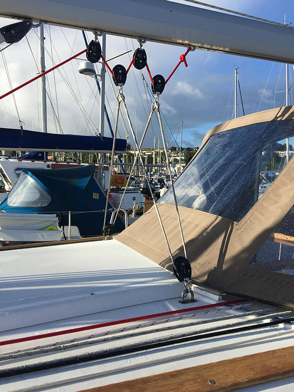

I've also seen this setup suggested. Would very much appreciate your thoughts on it.

I have the same problem on my boat, so I rigged a bridle similar to the one shown in Jackdaw's Post #3. It was a big improvement in performance, comfort, and safety. Keep in mind that the main sheet will lose some of its functionality as a leech shape controller and will serve more as a port/starboard trimming control. In other words, the mainsheet acts as a pseudo traveler. The vang then takes on more duty as the leech shape controller. I found that my vang was inadequate for that duty and I needed an upgrade.
I think that the rig shown in Post #5 will work about the same as the one in Post #3.
I offer this information to you as anecdotal data. My boat is much smaller than the Beneteau 281. The configuration of my boat allowed me to rig the bridle at the clew end of the boom and I bring the mainsheet forward to mid-boom so it is easy to reach from anywhere in the cockpit.

That’s basically identical to the Jeanneau picture I posted. It’s just uses more blocks on the boom, probably to help support the load of mid boom sheeting. The blocks on the cabin top are probably unnecessary. Those individual lines could either be terminated there, or simply let the dyneema roll over the stainless steel.
