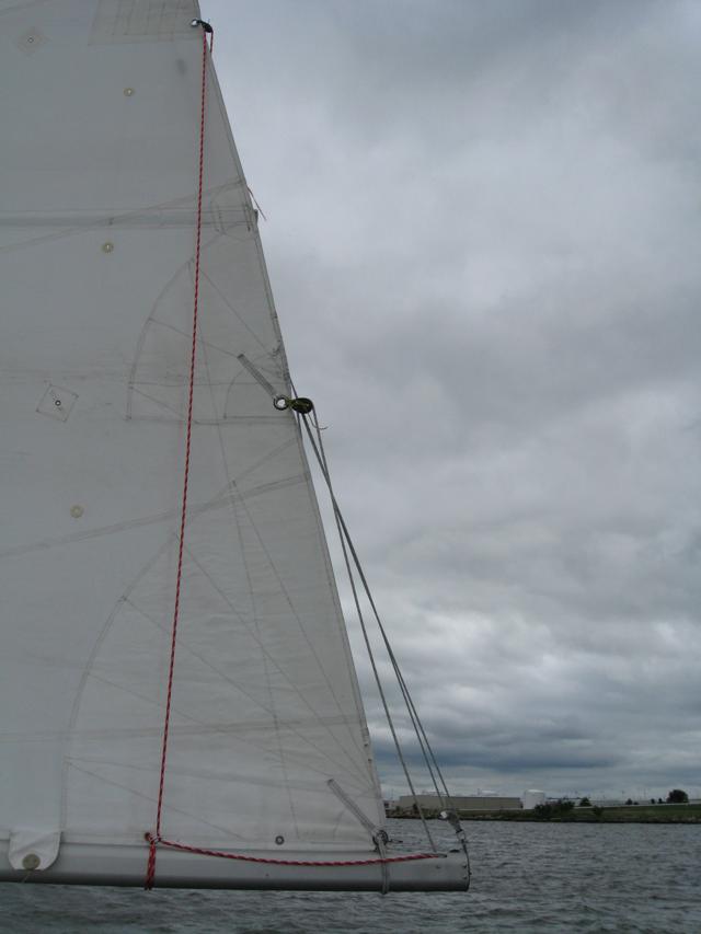

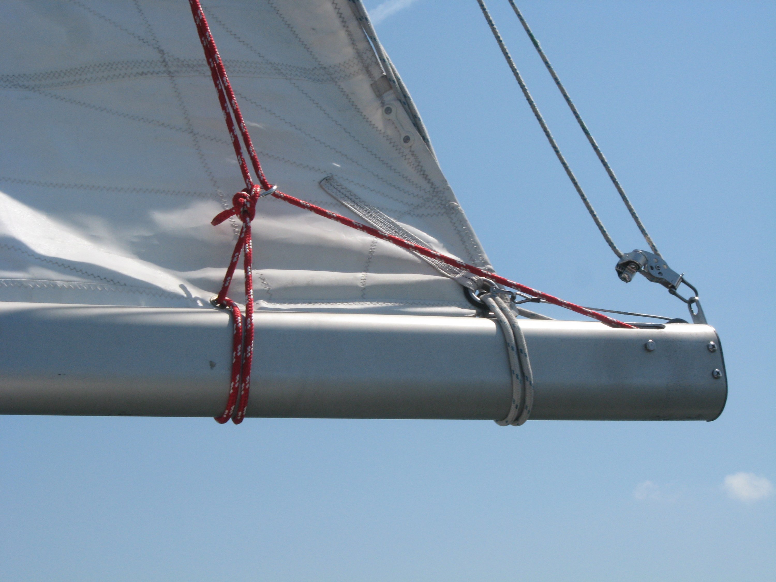

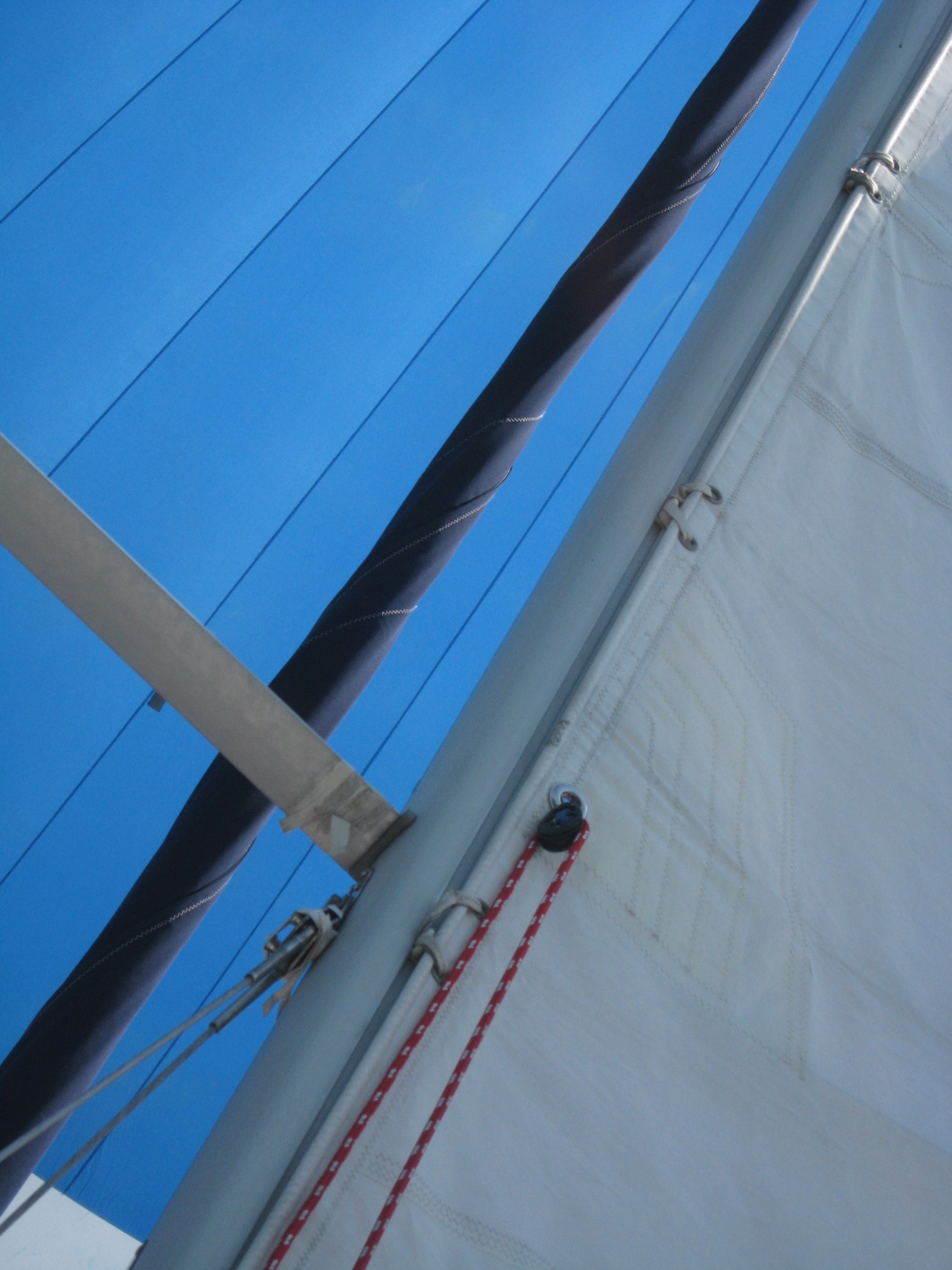

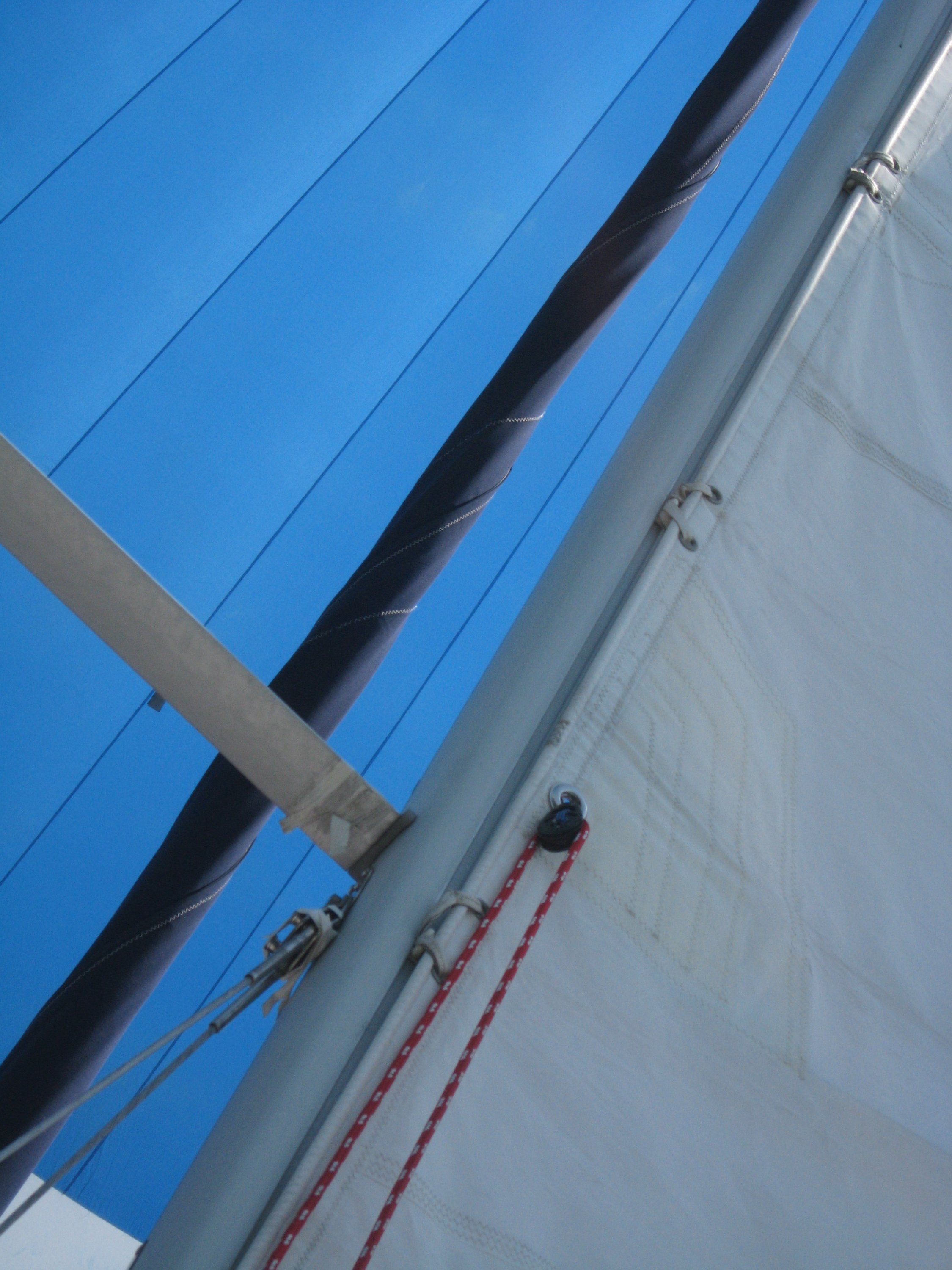

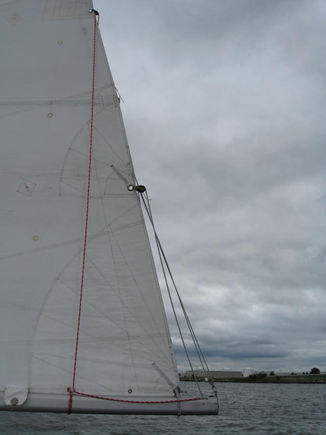

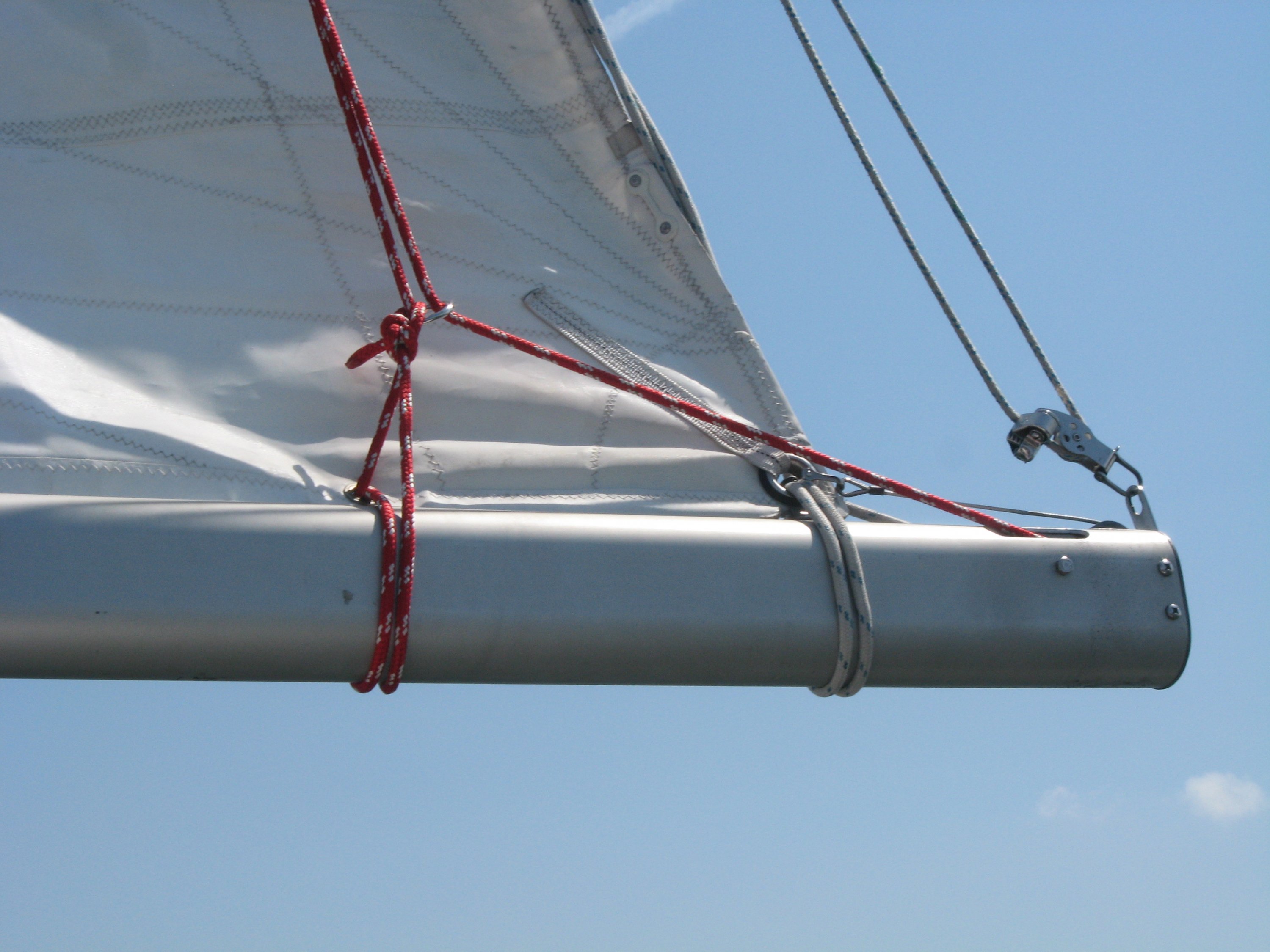

I used some harken blocks and it makes it much easier to tuck in the reef. Don't recall the exact cost, but certainly worth the effort. After these pictures were taken I subsequently removed the blocks and retied them to a small stainless ring on the opposite side of the sail from the block through the cringe , which makes it much more flexible and the reef line leads much better,
