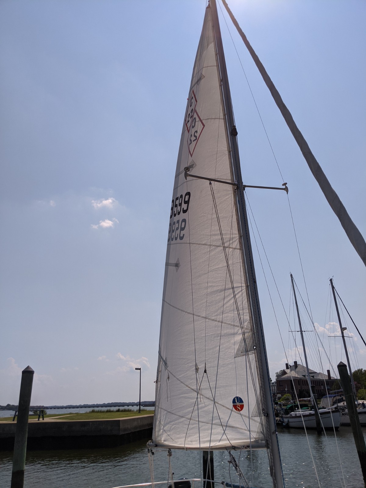

I just purchased a '80 Catalina 22. I got all the rigging up and everything seems to be working correctly except the mainsail. The luff side of the sail is completely tight when extended, but the leech side doesn't seem to be. There is a good bit of extra fabric at the bottom that hangs out from the boom. Tightening the Vang doesn't seem to help as it pulls mostly on the leech side, and I tightened the outhaul as far as I could. ll try to get some pictures but I will have to resize them to upload.

from what you wrote, I assume you saying that you can’t pull the foot of the sail tight along the boom, right? This sounds to me like the bottom of the sail ( the foot) is longer than the available space along the boom.
If I understand what you wrote, one of two things is problematic
The foot of the is stretched out or was cut too long
Somebody added extra hardware at the aft end of the boom, maybe an unnecessary pulley (block)
This doesnt sound like a a shrunken bolt rope, in my experience.
let’s see some pictures, please

Need a picture of the boom end of the sail... looking forward, and looking up. I see an extra cringle just above the clew. Why don't you try rigging the sail with the cunningham as tack and that one as the clew... see what happens. You may have what's called a "flattening reef" but I leave that to the experts. Anyway, using those cringles to shorten the foot will definitely help flatten the sail. What's really important is how the boat behaves. If you're having trouble with too much weather helm, or excessive heeling, then the sail needs modifying.

As @Gene Neill said, the foot of the sail is equipped with a “shelf. Way back in the day, the Catalina 22 one design Class Rules required that the fool of the mainsail to be attached to the boom. But that complicated easing the foot of the sail for more power in light air. So sailmakers added a “shelf”, a lens shaped piece of fabric between the foot of the main and the boom. The shelf construction allowed the foot of the main to be eased while still being technically attached to the boom.
building the sailwith a shelf foot begets a second problem: you cant pull the foot flat to depower the lower section of the mainsail. The solution to this problem is to put a reef ring a few inches upon the leech, abocve the clew. This is called a flattening reef (As @Joe suggested). To depower the lower section of the mainsail, you rig and tension the flattening reef. (This is done independently from adjusting the cunningham)
At some point, at least 20-30 years ago, every One Design class rewrote their Class Rules to allow loose footed sails, and foot shelf construction fell completely out of favor.Nowadays, people prefer a loose foot, with a few inches of roach added to the foot, and an outhaul. It’s simpler to operate and just as powerful.
The sail does look rather baggy to me, but you can’t be sure how bad it is sitting at the dock. it might look better ( or worse) under sail.
