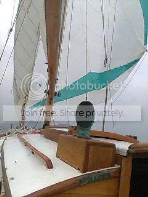

The best sail I ever had with my Asso was with the chute flown "by the lee". I had everything else up on a broad reach and the chute ended up being happiest by the lee after a gybe. The main and staysail seemed the feed the chute and keep it happy as seen below.

So something of a 'wing & wing' right Charlie? I do plan to experiment with a number of configurations. I have a little experience with an Asy; just wanted some tips for getting higher on the learning curve.
May 5, 2006
1,140
Knutson K-35 Yawl Bellingham
Yep, it was by accident as the chute didn't want to fill after a gybe. We gybed back, were slow with the chute and noticed it was very happy where it was. I later hoisted the staysail for grins and it was even better. The wind was 8-12 and we were doing 7 knots under this configuration or just over hull speed. We gybed a few more times and brought the chute to the lee on purpose each time. I have flown that sheet as close as 60* apparent on a reach at times with it sheeted in hard like a big Genny effectively. It's easily one of my most effective sails. Just go out and experiment with it in wind to 15 knots. I will fly mine up to about 25 knots offwind if wanting a rush but that's pushing it with an 800 sq ft sail. I did have it self deploy in a 50 knot gust once but that's another story entirely.
