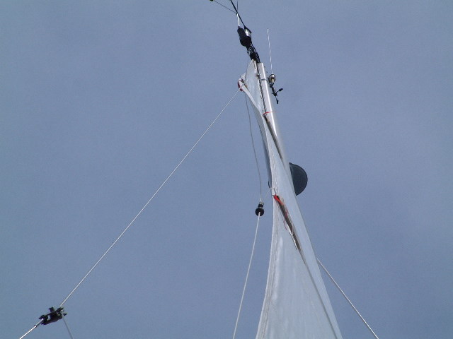

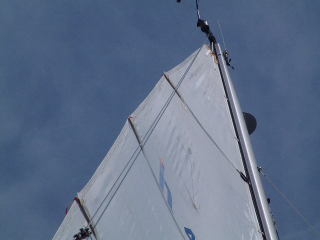

Feb 10, 2004
4,235
Hunter 40.5 Warwick, RI
Same problem on my 1997 h40.5
My large roach main would hit the back-stay at the head of the sail.
I took the sail to my sail-maker and told him to straighten the leach of the sail to avoid the back-stay.
Problem gone. I don't race so I have not noticed any performance decrease, and the reduction in sail area is minimal anyway.
See the pix below for the problem before the sail modification.
