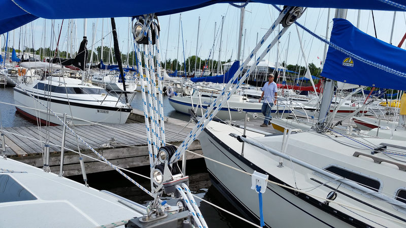

Our search for a better system led to Guido at Garhauer making a rather nice 3:1/6:1 block. There's less blocks, and the 6:1 adjustment allows exceptional mainsail trim and has yet to require the use of a winch. This setup uses the modified factory setup, except it does not use the routing to the mast base and back to a clutch.

That looks and makes sense. Thanks. I need to talk to Guido.
https://meriachee.wordpress.com/2014/08/01/archimedes-palimpsest/
Nice setup. We use two-speed mains on both our boats; our 260 has a 3:1/6:1 mainsheet setup very similar to yours. But I would forgo the endless line. The spice creates a 'bump' that does not like to go through the blocks as easily; and if you put a mark on the sheet at mid-point, it is very easy to get into the habit of re-centering the sheet.
No bump. :) I got a fantastic little tool with the Ronstan furler for making butt splices, and it works like a dream. There isn't any whipping in it, and through an entire summer it has yet to show any signs of separation. The 1/4" line needs to have a strand taken out of the cover, but the larger sizes do not.
The downside to endless loops are they seem to have an affinity to get wrapped up on anything, and everything - a totally unforeseen scenario

I have the same set-up as Meriachee, minus the splice. No issue with two ends. I never run out of one of the ends.
The 6:1/3:1 is better (IMHO), because if you go for a single speed (6:1), you end up with plenty of line and it might be inconvenient for things like a (controlled) gybe.
