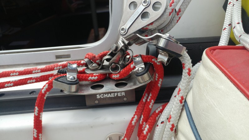

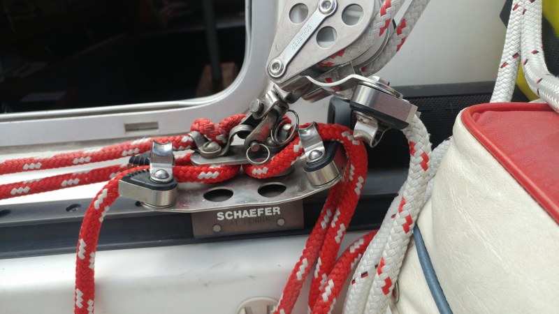

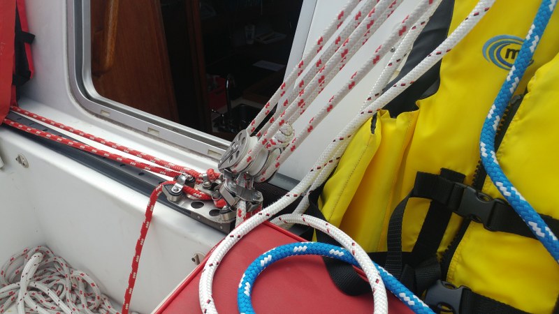

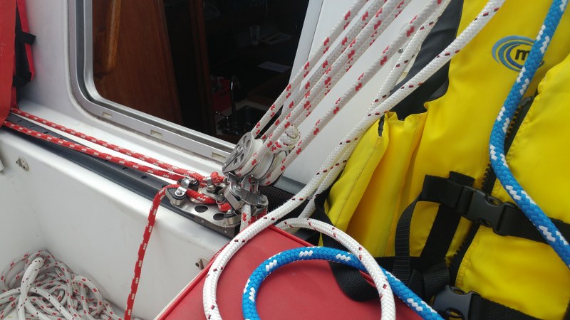

I finally got some pictures of the Traveler and the equipment for my Main Sheet.
As you can see, there are 3 pulleys connected to the traveler, and the traveler is a Schaefer, which I'm assuming is original equipment from where the boat was build (88).
My boat also had 1/2" line on the main sheet when I bought it, but I replaced it with 3/8" line which is nice to handle and works very well. I'm pretty sure that it was a 50' length that I put on, which gives me plenty of length for letting the main out on the down wind run.
Let me know if you need anything else.
Mike

I don’t see any reason to use 1/2” line. Keep in mind the you are multiplying the pull with the 6x factor of the pulleys.
3/8 really should be just fine.
