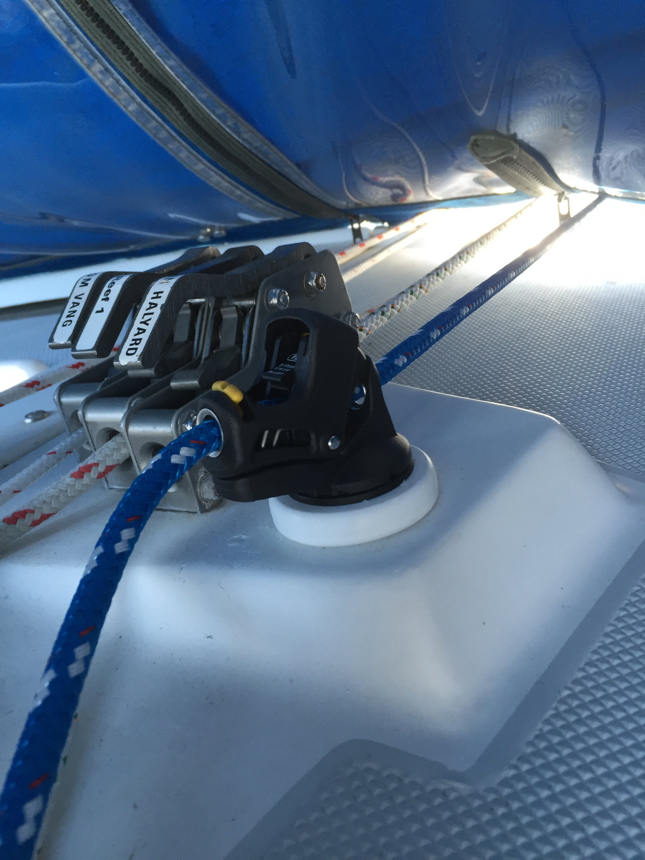

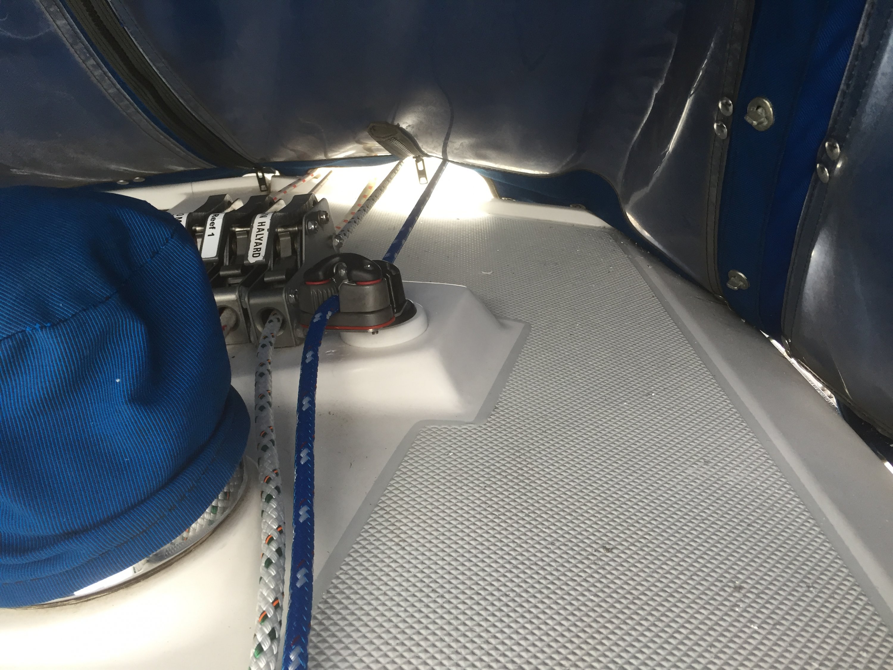

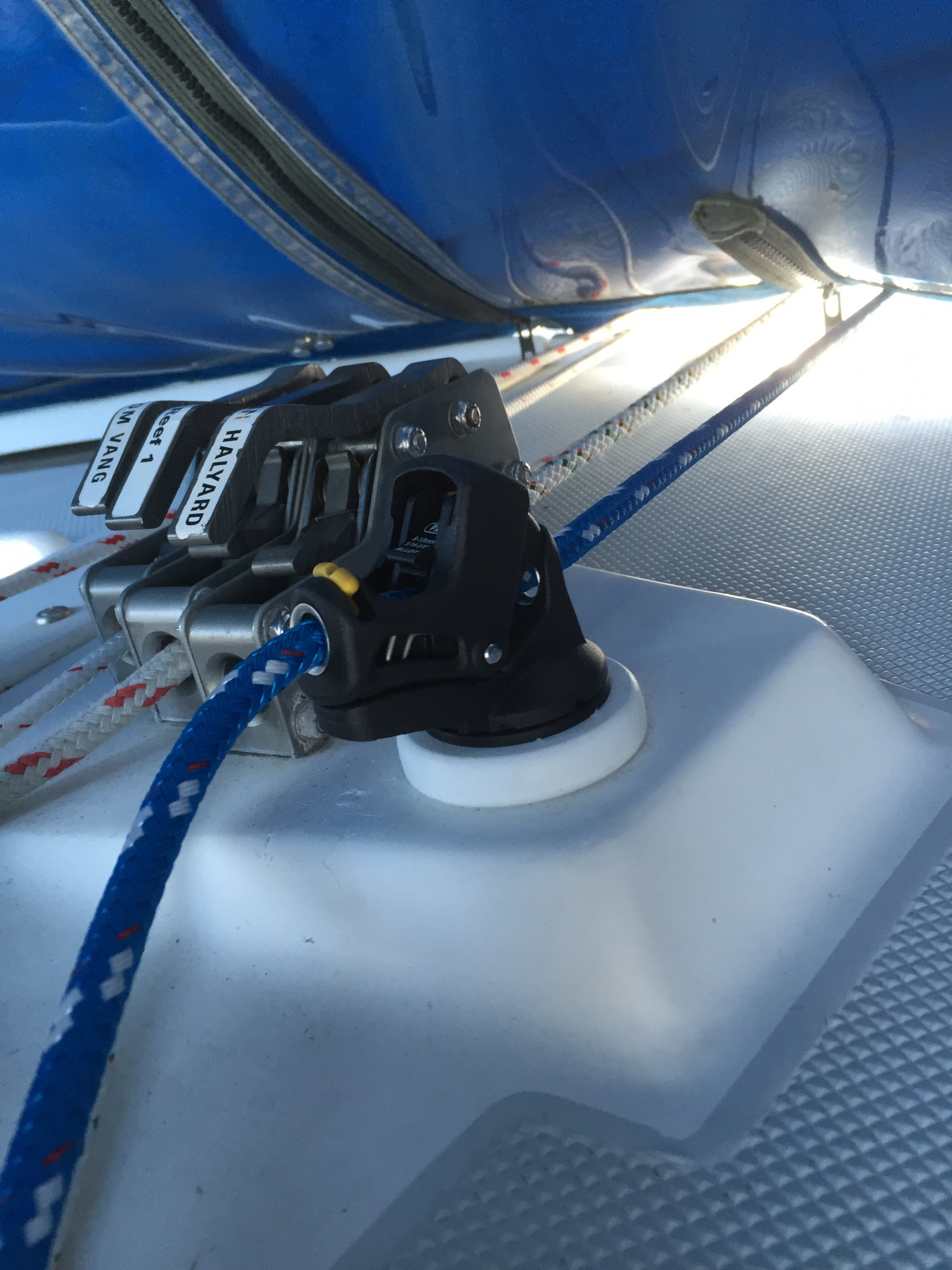

Depending on what sort of cleat you've got for your mainsheet (hopefully not the original clam cleat), and what sort of sailing you will be doing, you might want to change that cleat to something that's easier to work with. There are several threads here about that; here's a picture of what we tried (Harken cleat) and what we ended up doing (Spinlock cleat Spinlock PXR0810/SW). The Spinlock cleat is for 8-10 mm, 5/16-3/8", and I'm pretty sure we went with 3/8" line for the main sheet, rather than 7/16". The swivel works well, and it's much easier to release the Spinlock than the Harken and clam cleat.

Yeah, ours has the clam cleat with bail. Having just got the boat and only getting her out a few times I can say we were less than impressed with this set up. Changing out the mainsheet cleat is on the to-do list. Thanks for the suggestions.
