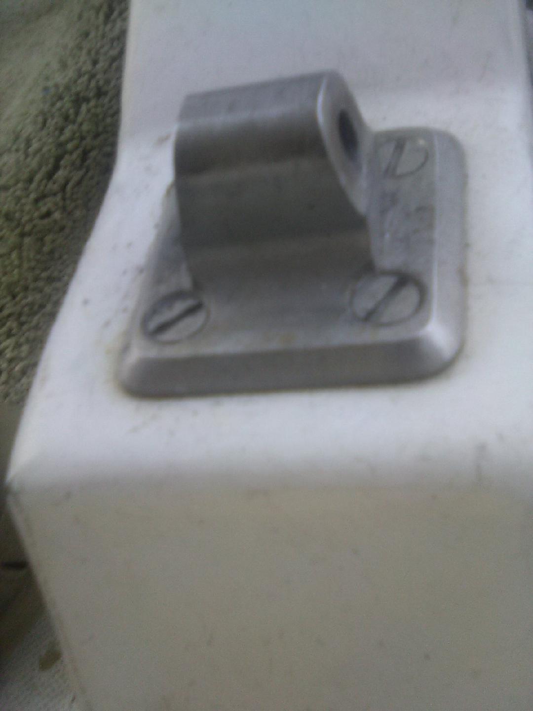

Thanks,Joe. I'll try your suggestions. It's been difficult to get the correct mounting. I'll take a picture and send it to you. Perhaps you can help me write a correct description, you seem very familiar with sailboat jargon. This particular one has four(4) mounting screws. My base bracket only has two(2).
Perhaps I'll have to change the base mount. Do you know if the base mount is through bolted, or just screws?
Thanks,
Del

There are many ways to handle this. In the end you want something to attach a modern mainsheet block to. You can modify your existing hardware or you can install a pad eye. I would try to find a four screw pad eye but I wouldn't exect the screw holes to line up. You'll likely have to fill in the old ones and drill new ones

So holes are not through bolted?
Not necessarily.
Screws may be installed into fiberglass or into tapped metal threaded holes beneath fiberglass, as well as through the deck, where a backing plate, washers, and nuts are installed.
Screws into fiberglass would be the weakest design, not likely to be used for a mainsheet block.

Thanks . Guess I'll have to try to unscrew to see if there's a backing plate. Area is unaccessable so it's either screws or bolts w/plate.

Not trying be a pill here, but that picture is TOO close. back up a bit so we can see the entire assembly, then... you may add a close up to a particular area that concerns you.

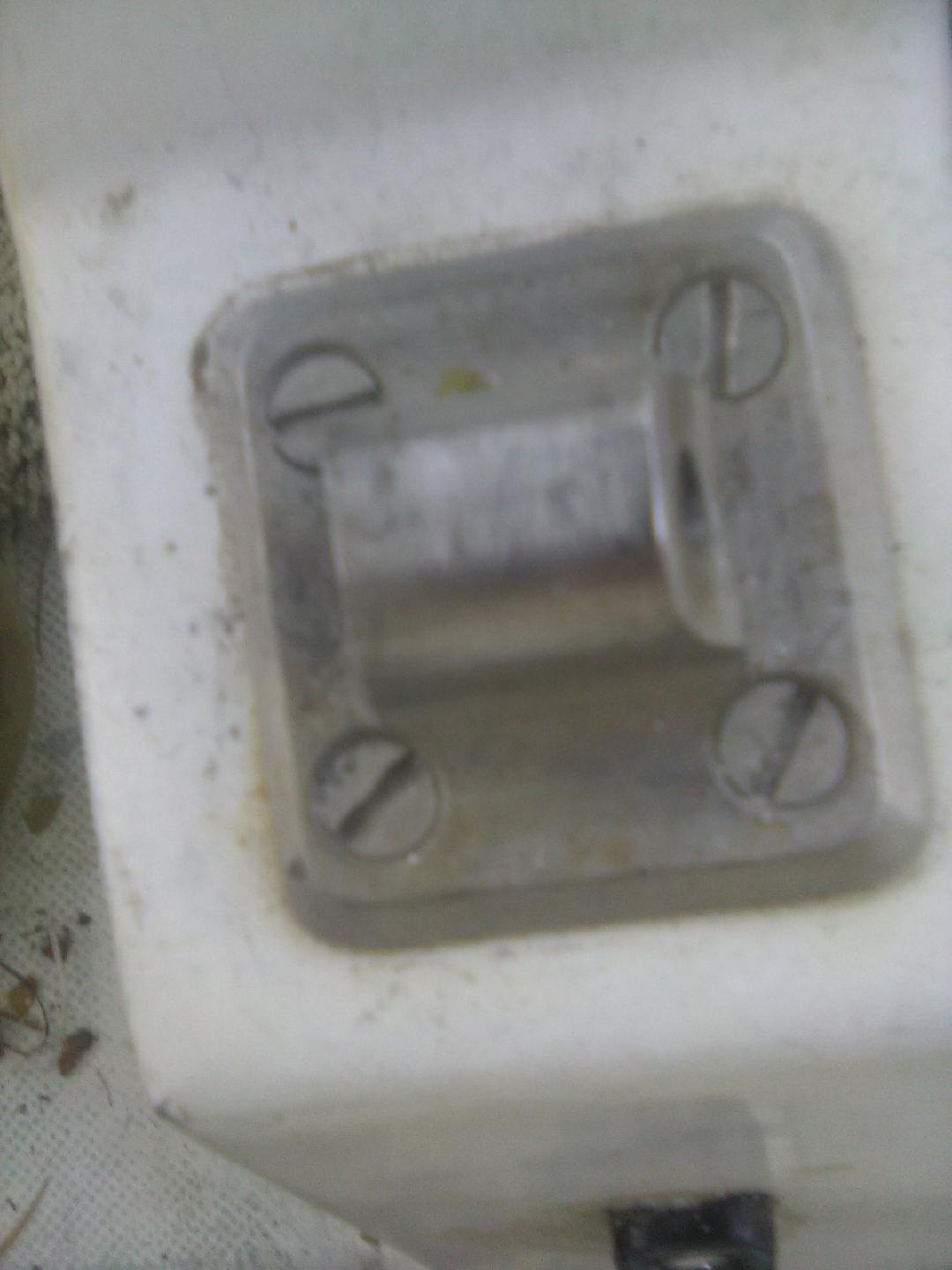

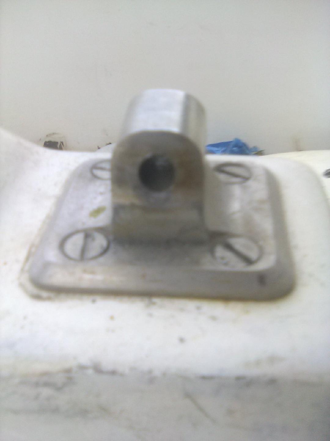

Here is a pix of actual mounting bracket. It measures 1-3/4" D x 1-1/2" W x1 " H hole is 1/4" diameter.

Attached are pics of actual mounting bracket. Measures.1.0" H x 1-1/2"W x1-3/4"L with 1/4" Hole. I need to find or purchase the Standing Main sheet Blocks that accompanys this mount. Does this help?

That attachment looks fantastic! All you need is a shackle and you can put just about any mainsheet block you want on there!
23,579
That does look good.
