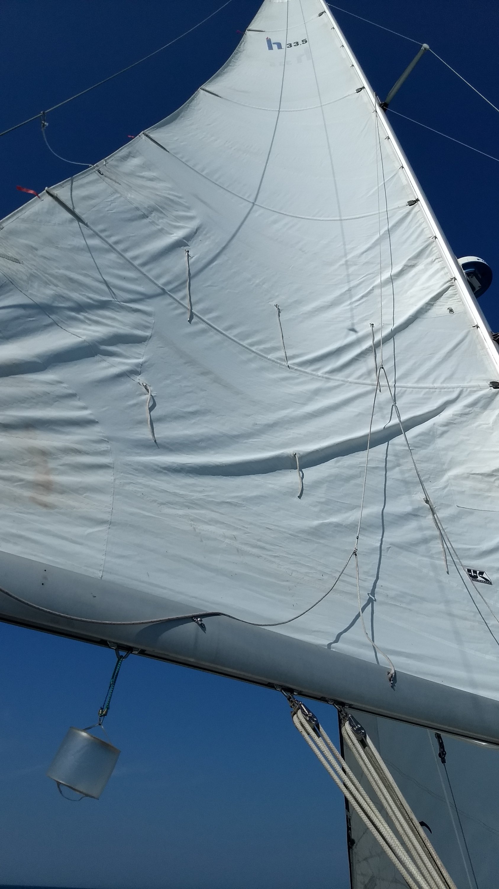

Ditto to what Roland said. Also, make sure all the sail adjusting lines are loose, mainsheet, vang, outhaul. Possibly the main will go higher....
May 12, 2004
1,505
Yes, if the mainsheet or vang are not loose the main will not go up all the way. Don't know what your experience is but, this is a common mistake easily made by newbies and occasionally by some non-newbies. No insult intended.
Feb 17, 2006
5,274
Yeah, I forgot about the topping lift once. Couldn't get my sail up until I removed the topping lift. After that, piece of cake.
Feb 17, 2006
5,274
Also check the leach line going up the leach of the sail. Make sure it is also loose.
Ted
Jan 26, 2005
1,280
C&C 110 Bay Shore, Long Island, NY
It looks like the bolt rope in the luff shrunk. Bring the sail to your sailmaker and have them ease it.
Jun 6, 2006
6,990
My money is on the leach line to tight or topping lift not let out. The picture shows scallops all along the leach (free edge of sailfor you landlubbers).
Joe
Jun 1, 2004
8,361
Why is there a line on the leech clipped to the topping lift? Or am I not seeing correctly?
