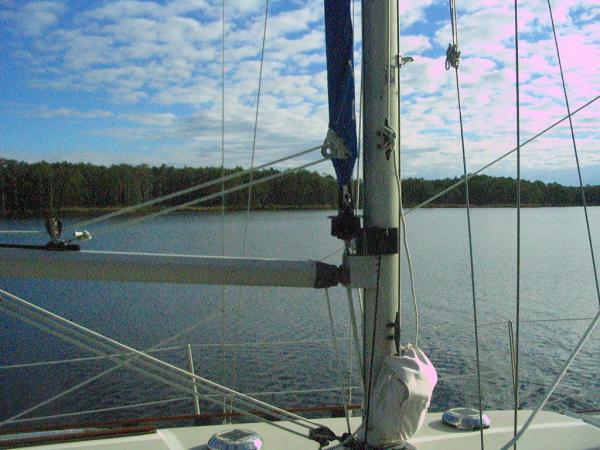

One of the boats I sail for the company I work for has an aft mast main furling system similar to a roller furling headsail. Very easy to deploy and furl. Also, very easy to adjust the outhaul. I know I'm going to take some heat for this, but I prefer the aft mast setup over the in-mast because of the ease of furling. My experience with in mast furling has not been so great. The need to have the boom at the exact right angle to the wind to furl is a pain and if the main gets a wrinkle while furling you usually have to start over. Also, if the furling line or some other piece of equipment fails and you have to get that sail in right now there is no way that I have found to quickly drop it. I like keeping things simple. Just my opinion. Don't beat me up.

When I bought my O28 it already had the behind the mast furler. I will say I was skeptical at first, I was already making plans to remove it before I signed the papers. During the 4 hours sail home that day I was sold on it. If I bought another boat it would be the first thing I added.

Thank's Tom for your update. I have decided to add the CDI main sail behind the mast furler to ZEA in the spring ready for next years season. Many factors stick out. A fraction of the cost for say a Schaefer or Forespar boom furler while no jamming problems like an actual in mast furling system. Installs easily and allows for a DIY project if desired.A six year warranty speaks to reliability. CDI is now a Canadian company in Winnipeg Manitoba and should make it a bit easier for shipping eh!
