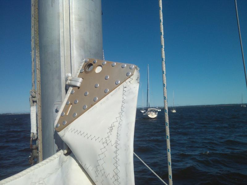

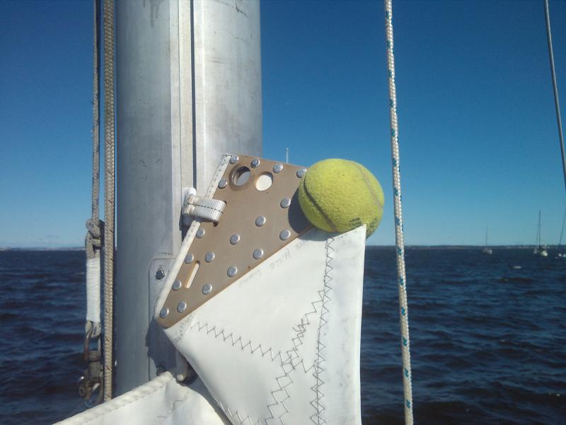

Another tip is covering the headboard piece to protect it from ripping thru. I take a regular tennis ball and give it a slice thru, looks like" Pac-man" slip it over the headboard piece before you cover,works great...pics....Red
