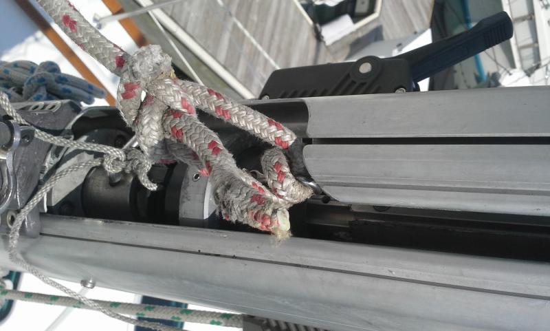

I just wanted to let everyone know hat I found multiple things wrong with the roller furling, the biggest was a double bowline that someone tied for the main halyard. Every time the roller mechanism turned, the knot would follow the roller and bind in the mast. I replaced the main halyard with a spliced halyard loop and its working free. Thanks to everyone. I attached a photo of the knot and you can see where it was chafing against the mast. Hopefully this helps others.
