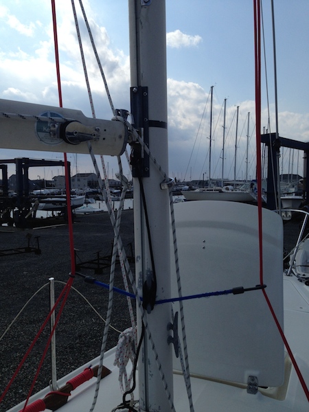

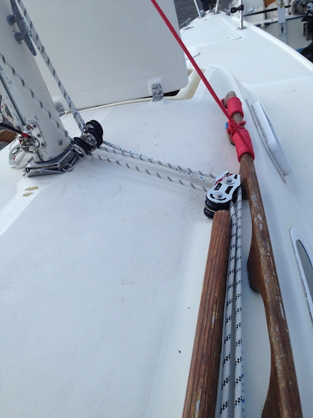

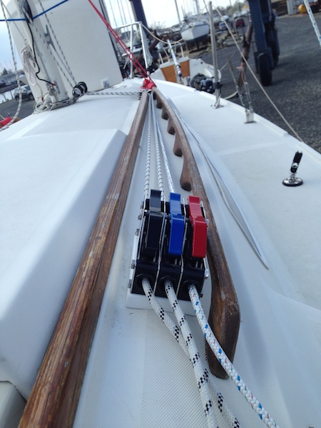

Ward H
Nov 7, 2011
3,833
Here are some photos of what I did this spring.
I like Garhaurer Marine hardware so I used their blocks, organizer and rope clutch.
From what I learned in studying what equipment to use, you could use Harken 150 cam cleats instead of the clutch. The minimum line size for the clutch is 5/16".
As Brian said, I found a lot of people who like the lines to the cockpit and others who would rather go to the mast.
It's a personal choice. Read my "First Sail of the Season! Thanks Guys" thread. While I was not afraid to go forward, I just was not comfortable doing so in all conditions. I may have gotten use to it but I've sailed twice now singlehanded, handling everything from the cockpit. I was much more comfortable and found it was so easy to reef and shake it out I did it several times each trip as wind went up and down. I'm aware that at anytime I may need to go forward for something and will but the less time spent on deck the safer I am.
I went with a two line reef system but others have done well with a single line system, which cuts down on the expense.
Do a google search for "running lines back to cockpit" and you will find several threads and a couple of articles about doing so.
