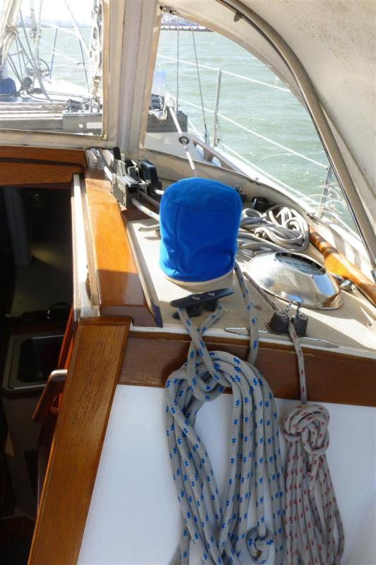

23,358
Here's a picture.
Our 10" handles don't go around. Joe's right, it's a ratchet. Back and forth, Easy peasy.
Under the traveler bar are three bullet fairleads, by Garhauer. Even the old Nicro traveler track had those. Holes in or cuts through the dodger let the lines lead back.
