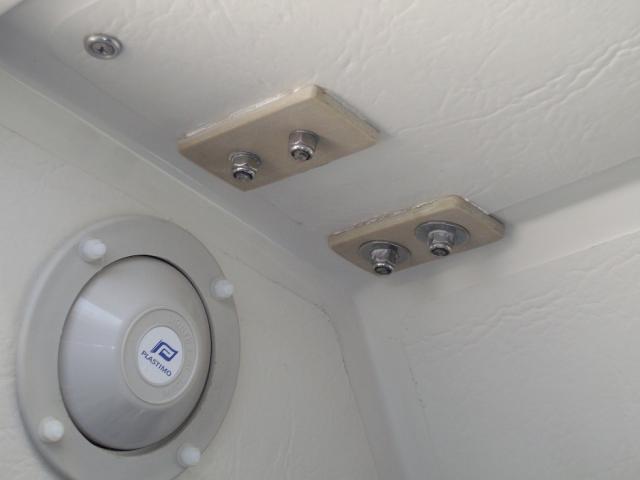

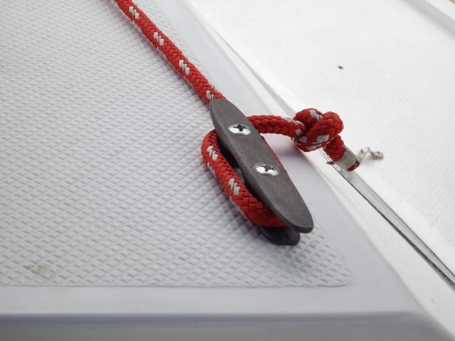

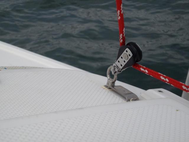

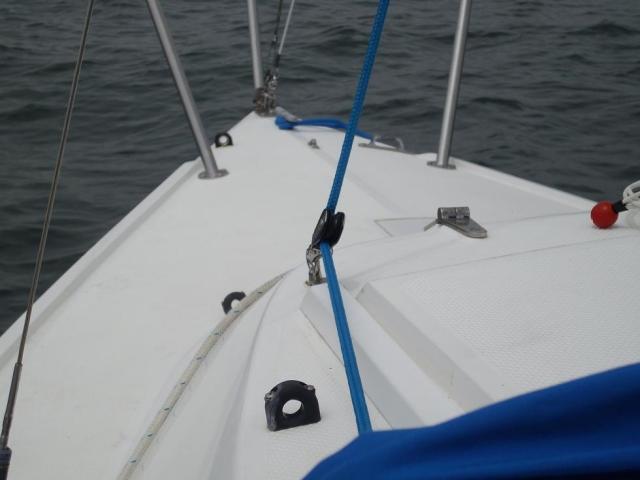

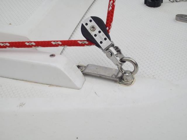

Here are some photos of how I accomplished this on our Capri-18. Now, this was a 97 model, with the factory mast raising system. As you can see in the pictures, I attached eye-nuts to the baby-stay mounts for the mast raising system. I simply took one off a machine screw and turned it around. This brought the line smoothly down, and let it turn to the cockpit. The line was just above the hatch rails. I like things simple, cheap, and effective. I used jam-cleats from Catalina Direct. They match the factory original hardware, and are inexpensive. They work very well with no slipage. As you can see, I had two cleats on each side of the cabin top. The additional cleats are used for single line reefing and mainsail cunningham. Take your time and drill the holes properly, and seal the hole with epoxy to prevent the plywood core from getting wet and causing problems. Go to the WEST Epoxy web site for their instructions on how to seal mounting holes through fiberglass with a wood core. Another thing that I do is use different colored lines for different functions. This way in the heat of the battle, if I have a green-horn onboard, I just tell them to pull on the red line, or loosen the black line. We'll use the proper terms later, plus, it looks cool! The Capri-18 is a fantastic boat, and will take more than you can. Go to my albums section in my profile and you'll see a lot of photos of the boat.
