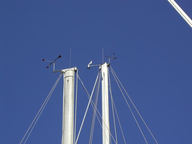

There must be something out of alignment, Sailoff.. :confused: When I release the halyard, my main collapses pretty much on the boom.. In this shot you can see the bolts..(the right side one is the 34's mast in the pic with two) Are the sheaves free? Binding in rope way? (like twisted on the other stuff inside? ) The yard ought to be able to figure that out by looking down inside with a light and correcting whatever is giving so much friction..

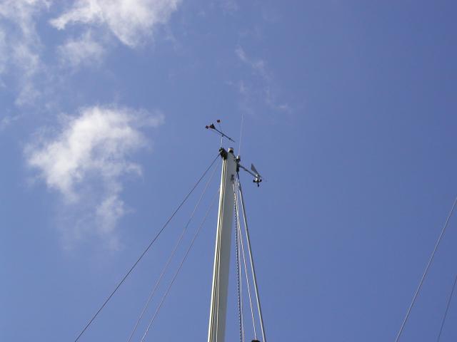

Our mast is a Kenyon. From my memory, it looks like the pictures that Kloudie1 posted.
