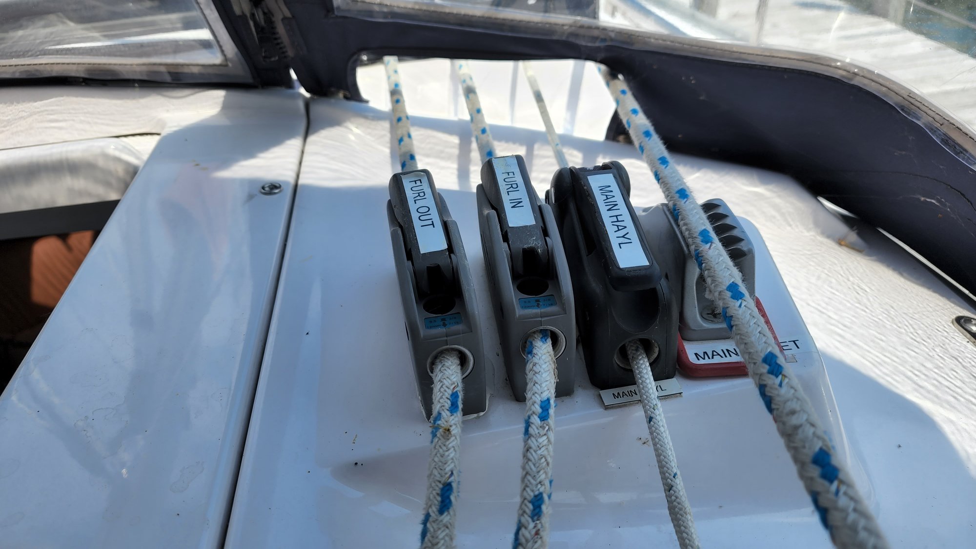

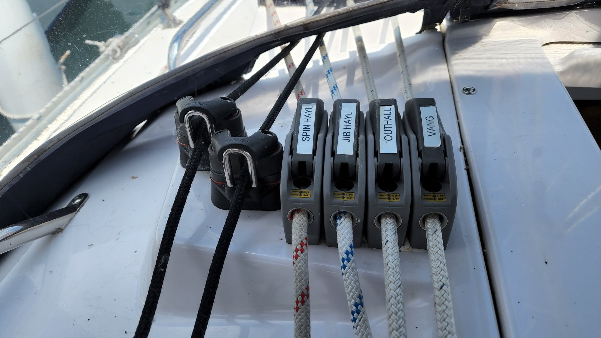

As you can see from the pictures.
On the cabin top, port side, there is: traveler, spin halyard, jib halyard, outhaul and vang.
On the starboard side: main furlers, main halyard and main sheet.
