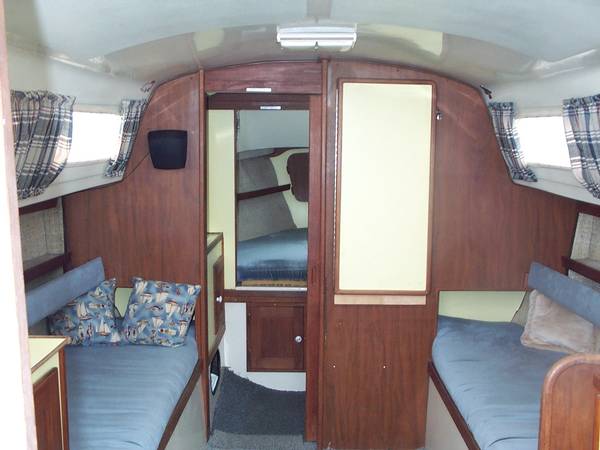

I am refurbing the interior of my Hunter27 (1979). I am replacing the old curtains with shades and want to paint over the old screw holes after I have filled them. Can anyone suggest a paint to use or should I use gelcoat? Steve

If your inside gelcoat is as nice as mine(1979) I would not paint it. Just fill the holes with a dab of epoxy paste and cover it with a dab of gelcoat. If you start painting you will have to do the entire surface to get a match. Maybe you can mask off an area? Does yours look like the picture(not mine)? Where would you stop?

Steven: I'd agree with Ed. I'd just use a little Marine Tex and then put up your new shades. You may find that you do not need to do any painting. I doubt that ANY paint is going to give you the shine/luster of the original gelcoat.
