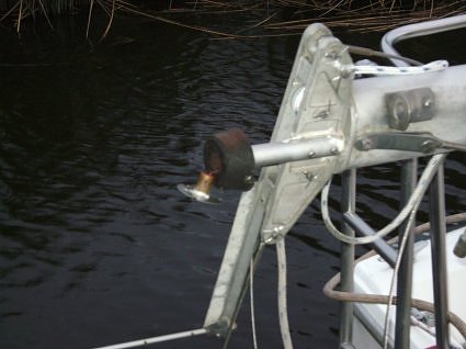

This used to happen to me on a Cornonado 25' I used to own. My issue was I had a piece of aluminum that slipped between the main and jib sheet sheaves of the chicken head (see attached pic for what a chicken head is). That piece of aluminum had gotten worn and it allowed the cable to slip off of the sheaves. I used the old piece as a template and cut a new one.
