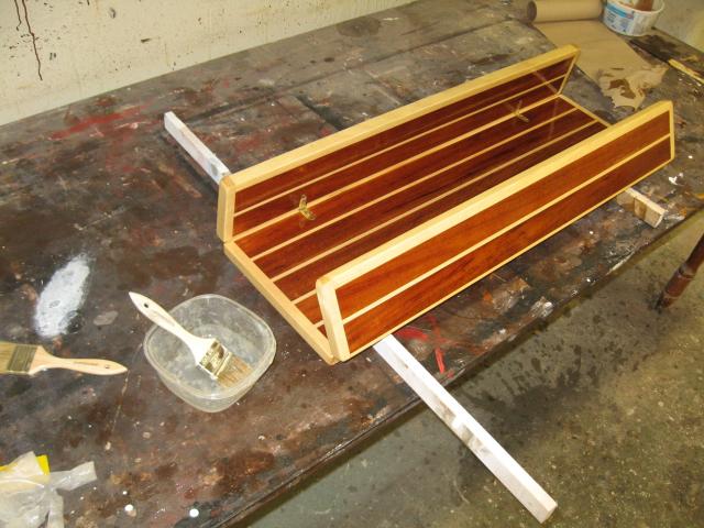

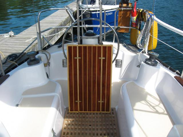

I had plans to add a cockpit table and figured I'd make a nice one.
I made it with African mahogany and ash with two leaves using 180 deg hinges.
I "sun conditioned" the wood for about two hours on each side to give a nice golden color to the mahogany instead of the pinkish color when freshly planed.
It has 4 coats of special clear epoxy and probably 6 coats of spar varnish on top.

Nicely done indeed, Sylvain. What did you use for mounting hardware abd where did you buy it? do you have another pic of the hardware or the table set up? Thanks

Beautiful craftsmanship. Notwithstanding the shear gorgeousness of your cockpit table, it sure beats the little tiny thing that Hunter supplied on my 1980 H36.
I've modified mine only so that it can be easily/quickly removed/attached to/from the pedestal when needed or not. I keep it stored inside when not in use.
One problem with your wonderful table. From your last picture, you've now got to brightwork the cockpit grate so it matches!

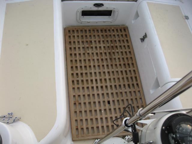

The cockpit grate was/is a trial version.
I used western red cedar in traditional dado joints. I copied the shower grate inside for construction except that I double spaced it in one direction.
It survived the summer. Cedar is light, cheap and easy to maintain.
It would break my heart (and my wallet) to machine this much teak. It's a bit sun stroked but I'll treat it this winter and see how it does next summer.

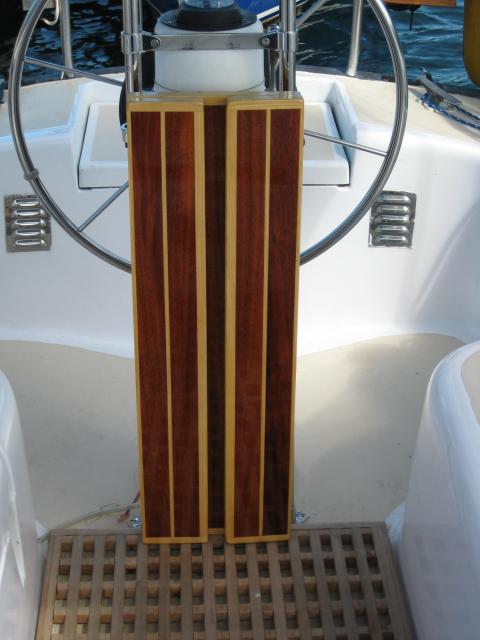

As for the hinge system, I bought these locking hinges before starting the project but that would have limited the length of the table. Right now, I'll used a post and a hooking system. More on this later.

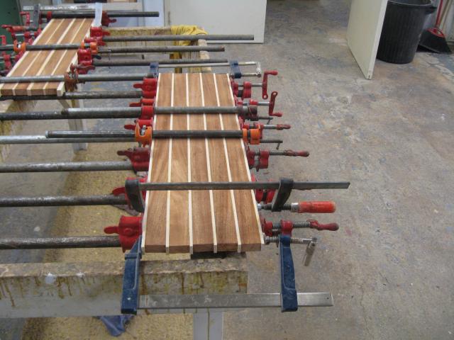

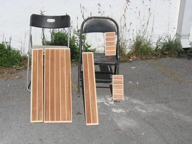

I used a 1 inch stock African mahogany and planed it. It's probably around 7/8 in.
The white strips are made of ash 1/4 wide.
I used Gorilla Glue but really, it's so well sealed that regular carpenter's glue would have been fine.
Hinges: I'm getting to it. I'm almost decided in a folding post that would rest in one of the groove in the grate.
I made the grate. The cost of a custom teak grate is much too high for me and I don't see why cedar isn't appropriate for this. It's very time consuming to make one of those with the interlocked method and that's also why they cost so much.
Why I made a grate: Water always puddled forward in the cockpit. I filled the area with some plywood bedded in thickened epoxy so that the water flows back to the cockpit drain. I still need to paint this area but the grate covers it for now and it looks better.
