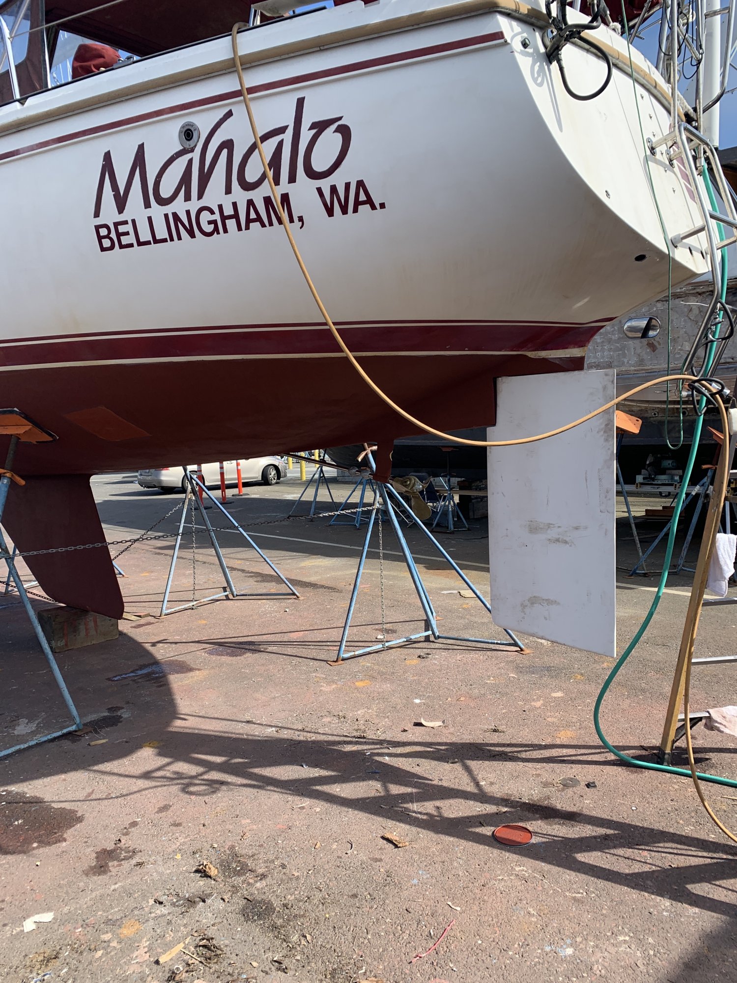

Just got the rudder head bolted up. Looking good. So far new to me autoprop, shaft,cutlass, PSS dripless, coupling, steaming chain/wire rope. Also polish/wax hull. And fixed hole where rudder crushed some glass
Need to install quadrant and tiller for autopilot. Paint under pads.
I’ll be happy camper when I splash on Sunday

As dmax said, looking read good. Nice upgrades!
23,636
Congrats Les. Not an easy task.

Also, you'll be pleased at how the stern floats higher with the new rudder. My last two boats were sagging at the stern because of water intrusion in the rudders (my picture of the O'Day is pre-new rudder, you can notice it there) - new rudders straightened them right out.

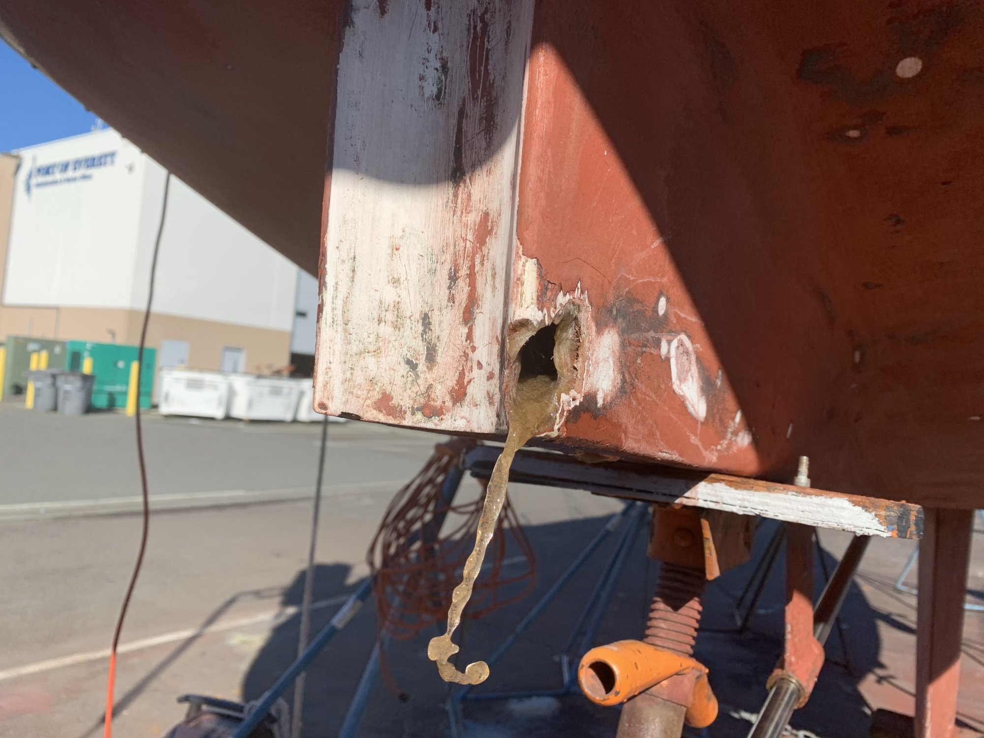

Here is the hole I mentioned earlier. Small intrusion of water. But big hole developed upon probing with screwdriver (5 months after I bent the rudder). John on inside pushing water out hole to dry it.
23,636
Yes... Over that past 5 months Les has wondered about the increased volume of water being pumped out of the bilge. Once out of the water the source became evident.
You never really know what damage has occurred until you inspect the boat.
You can be sure it is solid... now...
