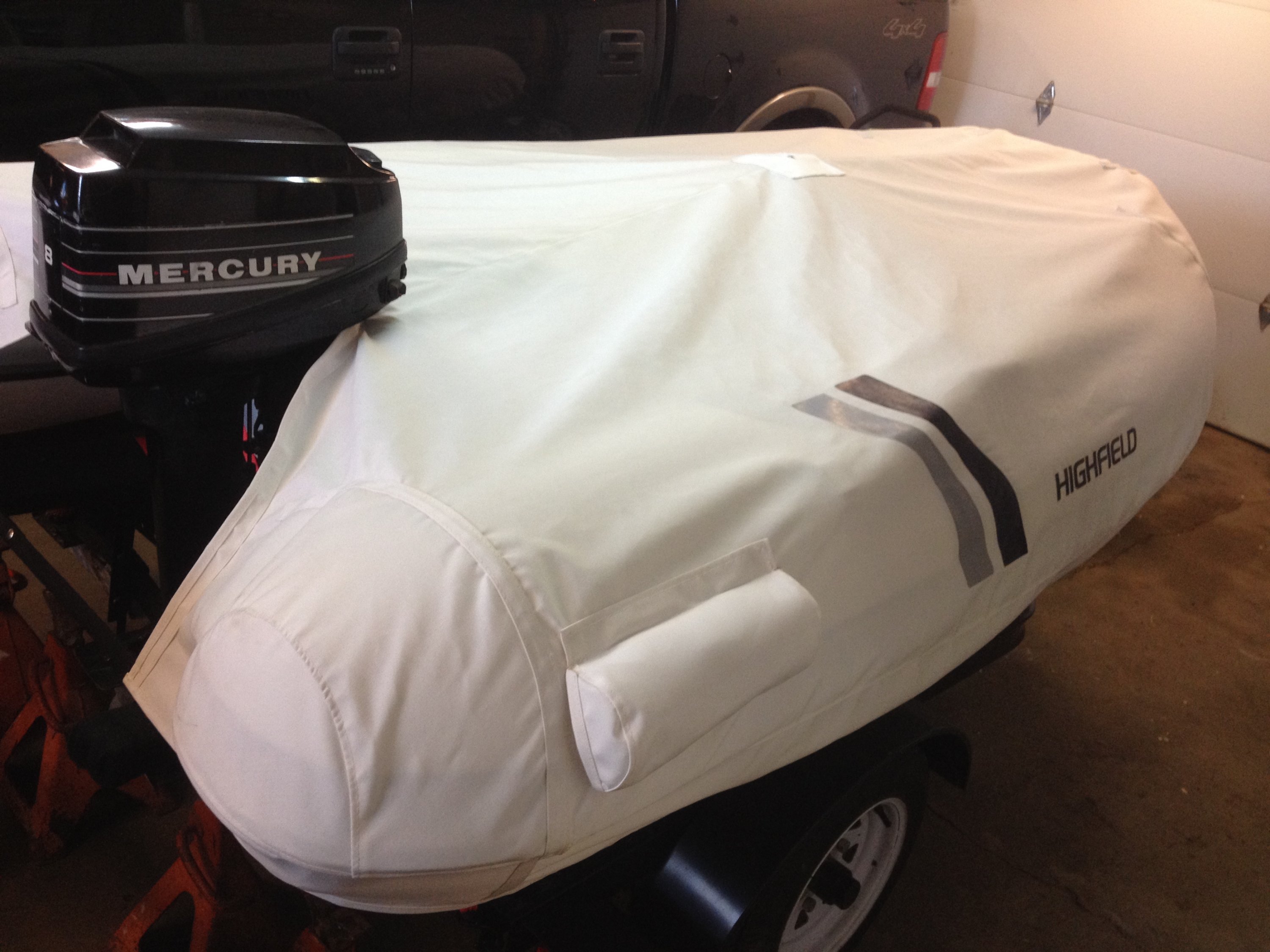

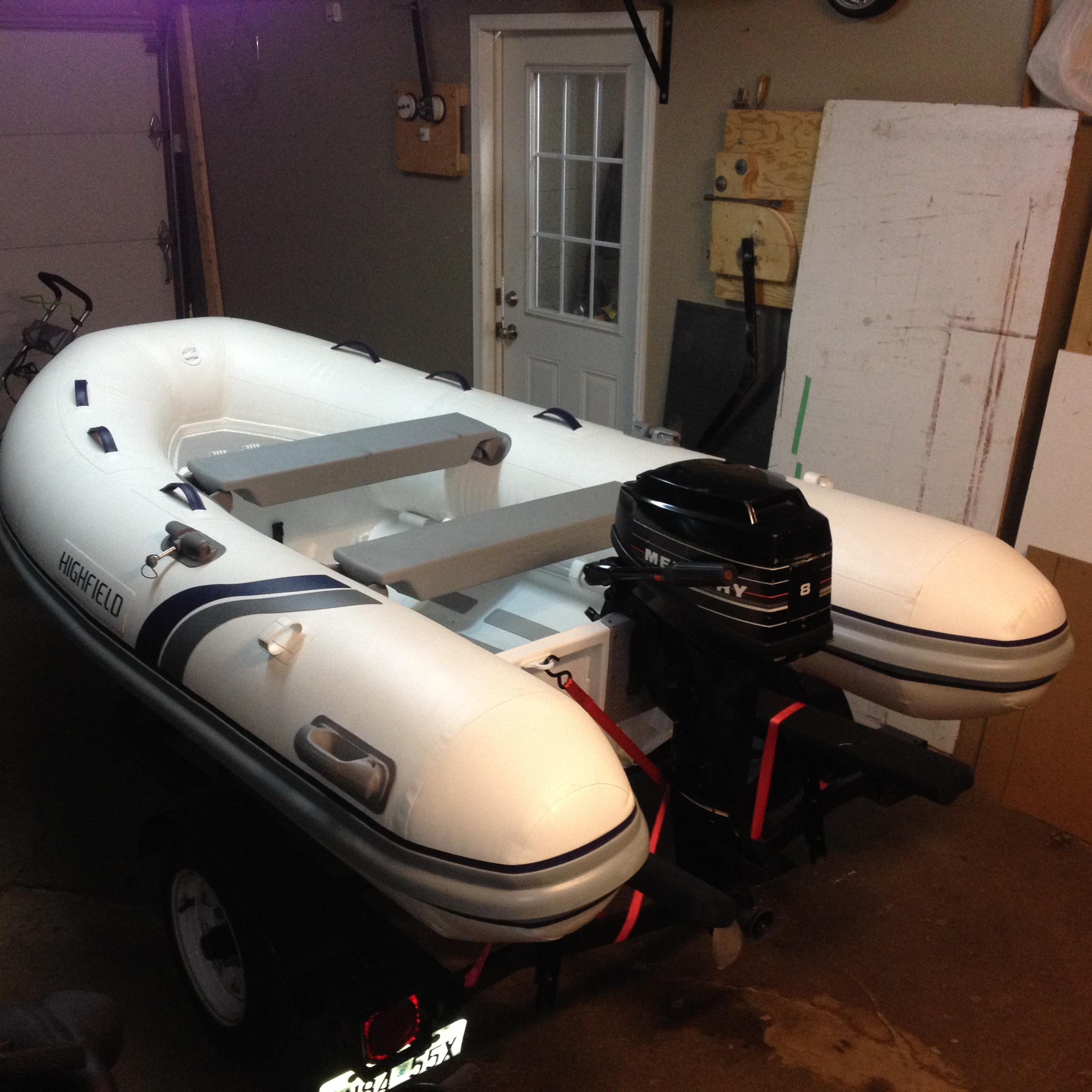

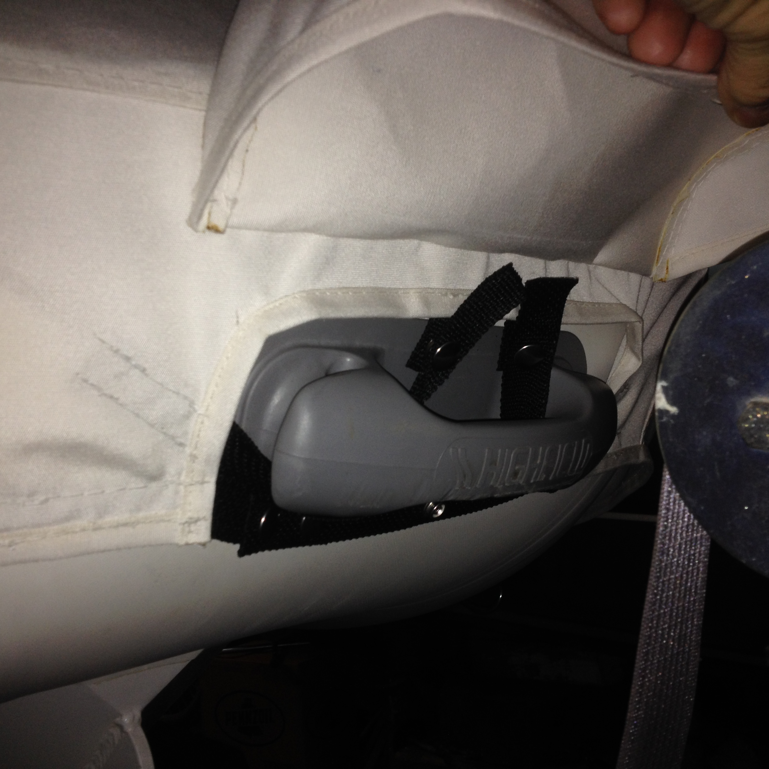

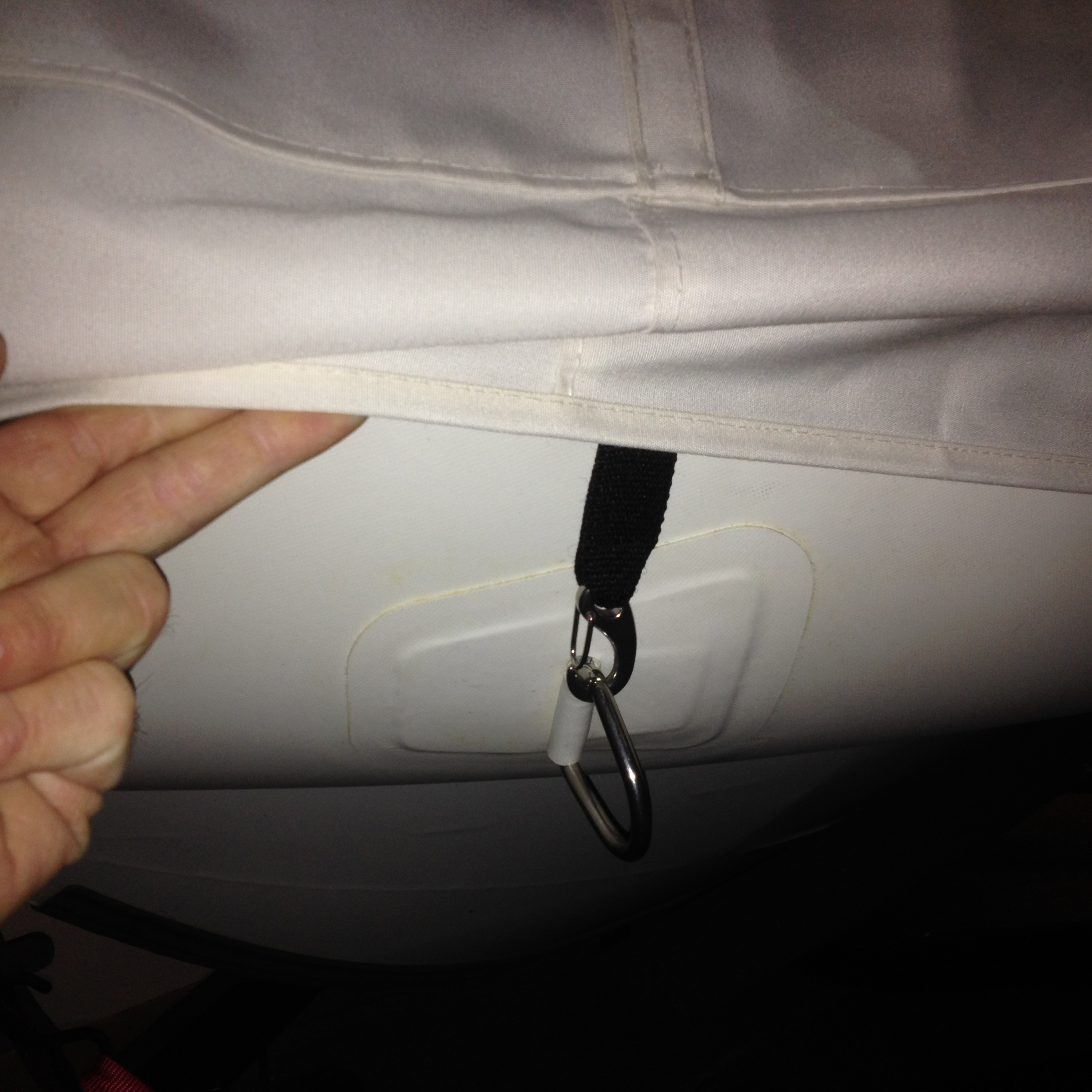

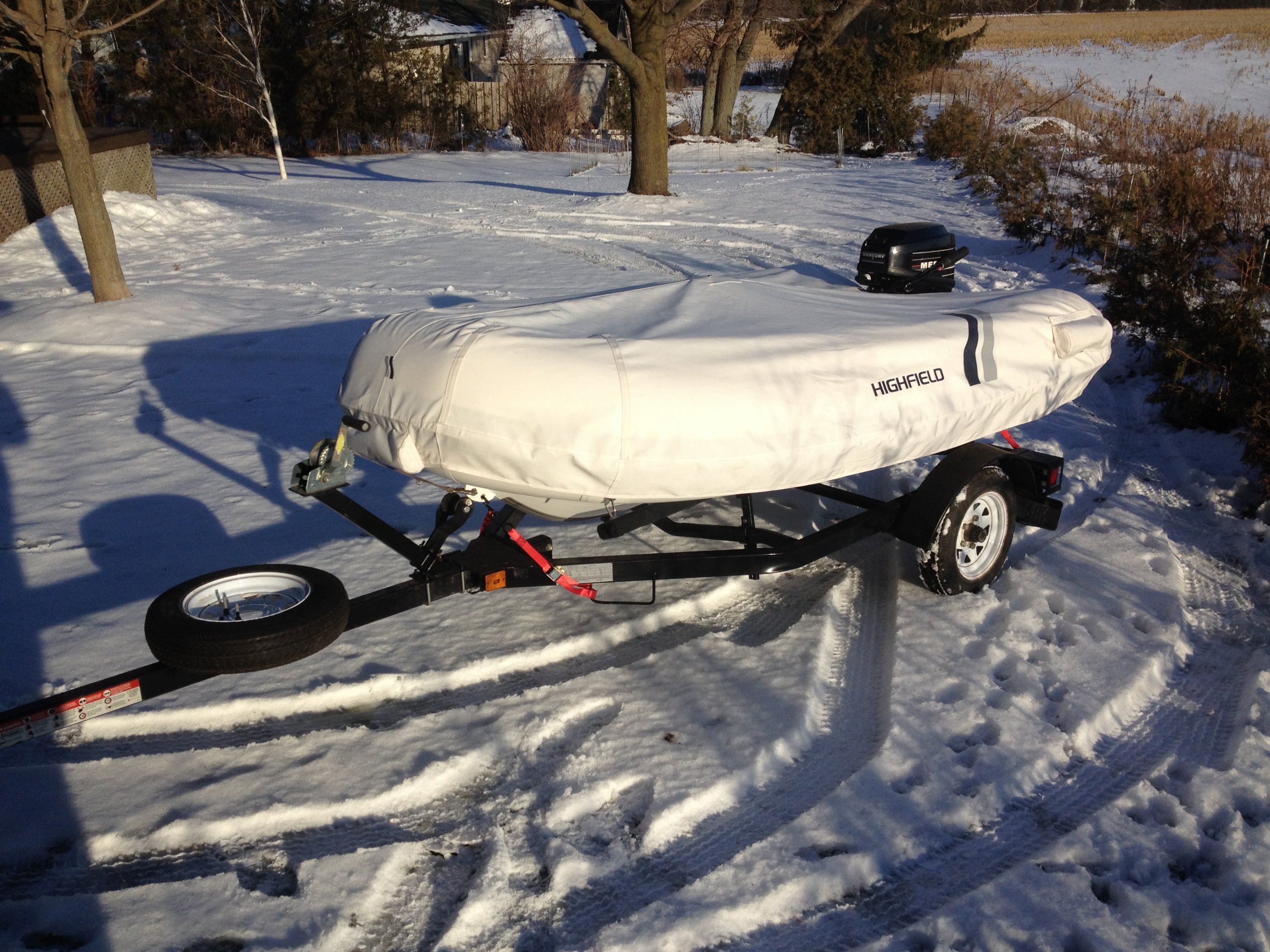

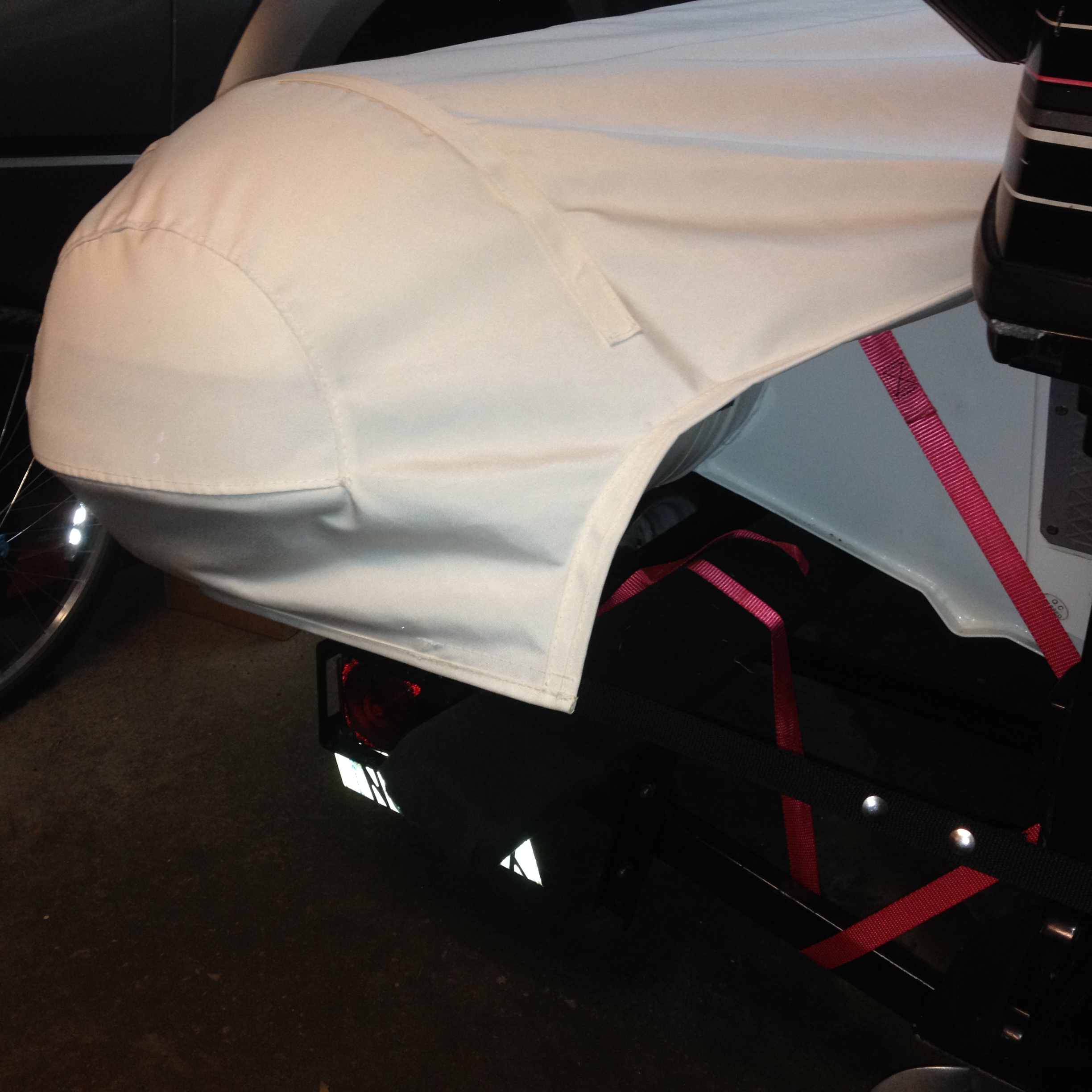

Last year we invested in a new Highfield RIB. The factory cover near basically fell apart after one season.
Sooo...bring in some Sunbrella Marine, add a bit of good UV thread...finish off with some heat press vinyl insignia...
And whullah!...A durable, yet pretty outfit for our tender.

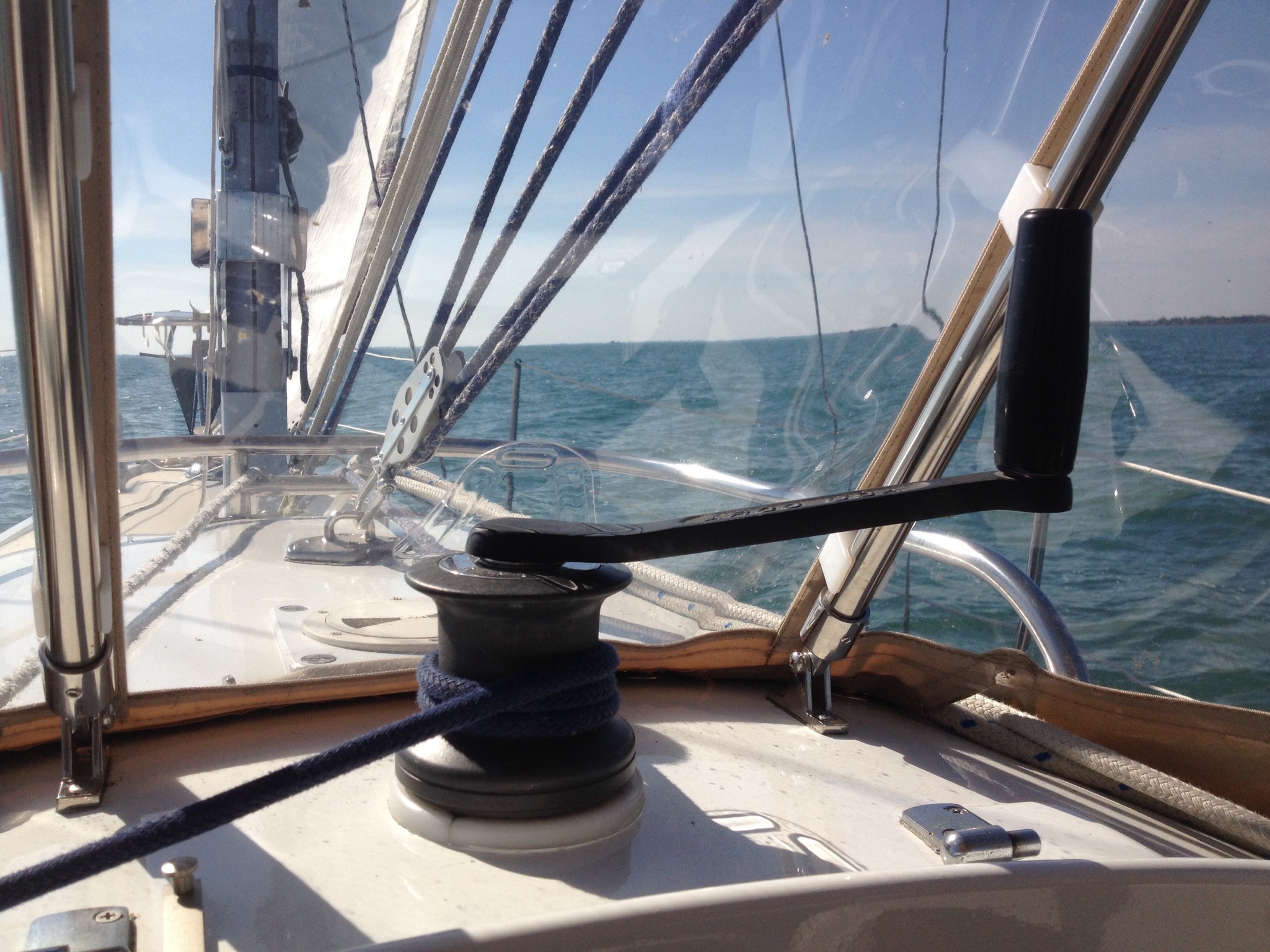

I'm far from a 'seasoned' sailor, but we ventured easily above 6 knots many times on different reaches, over the summer. Had some fun downwind with our chutes too.
With regards to pointing to the wind, I found it performed well...certainly better then I was lead to believe for this boat.
Some might have noticed that I decided to run a single point cabin top mainsail sheeting arrangement...obviously restricting my ability to completely centre the boom (while maintaining ease of trim) a natural necessity for pointing....
but with such a large sail area I wanted to run full time gybe preventers - with those in place I am able use the windward preventer to bring the boom to centreline or further when I want to heave to.
This resulted in a very functional and safe mid boom sheeting set up (including the boom vang)
My best friend of 34 years and I played hooky one afternoon and spent four plus hours burying the bow during a small craft warning North of Lake Erie's Long Point. Not another boat in site the whole time.....what a rush! :yeah:
Have to say, the high freeboard, narrow beam & and flared bow made for a confident & comforting sail that day. Although the decks were soaked,we stayed dry the entire time.
As mentioned above, we had to heave to for 20 mins while my friend (&VP) had to join a conference call on his cell.....I relaxed and ate my lunch, and was totally impressed with the stability that 2250 lb bulb keel provided us as the wind howled.

Nice cover, you should send the pictures into Highfield and let them know how to build a better cover, never know they may contact you once they know your original cover didn't last.
