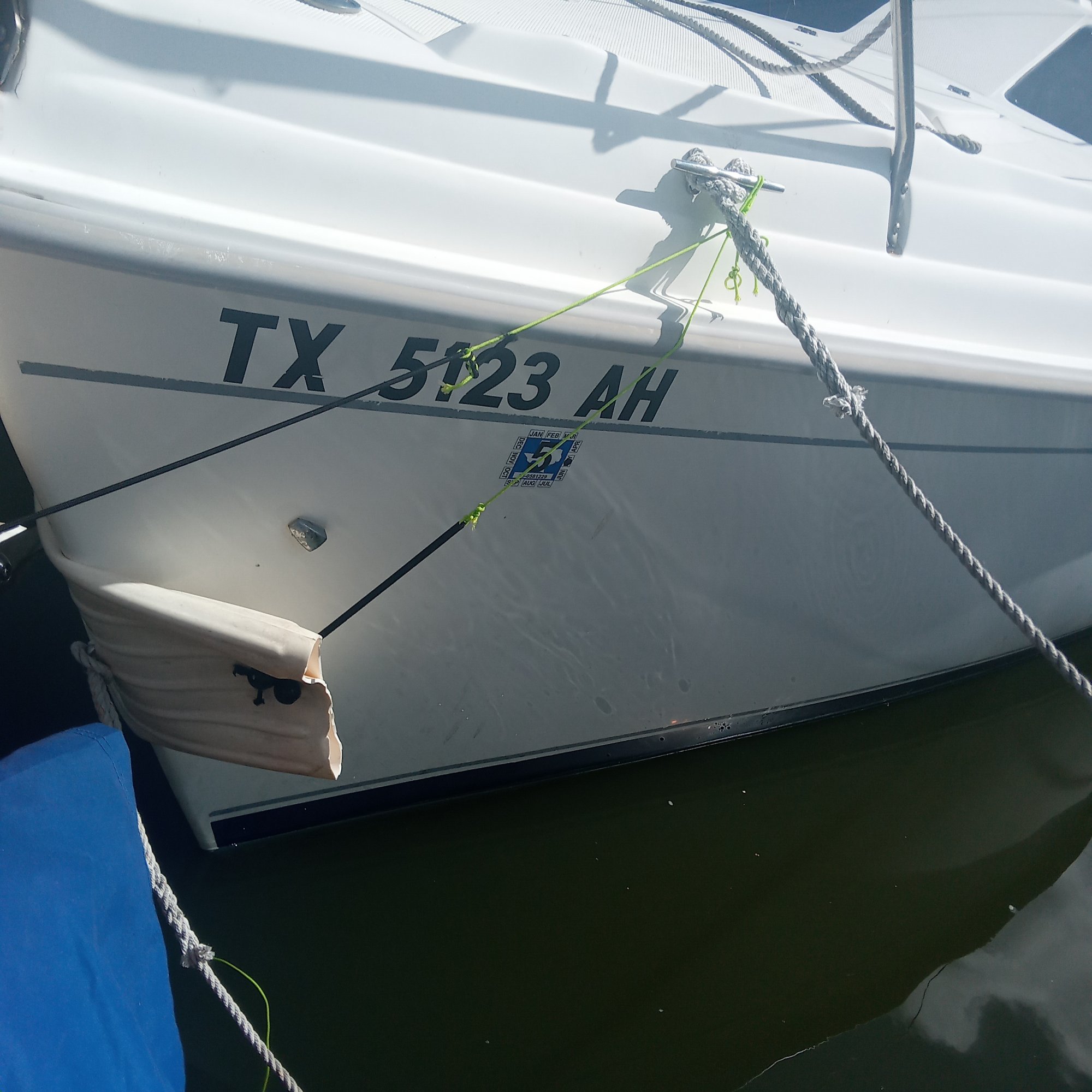

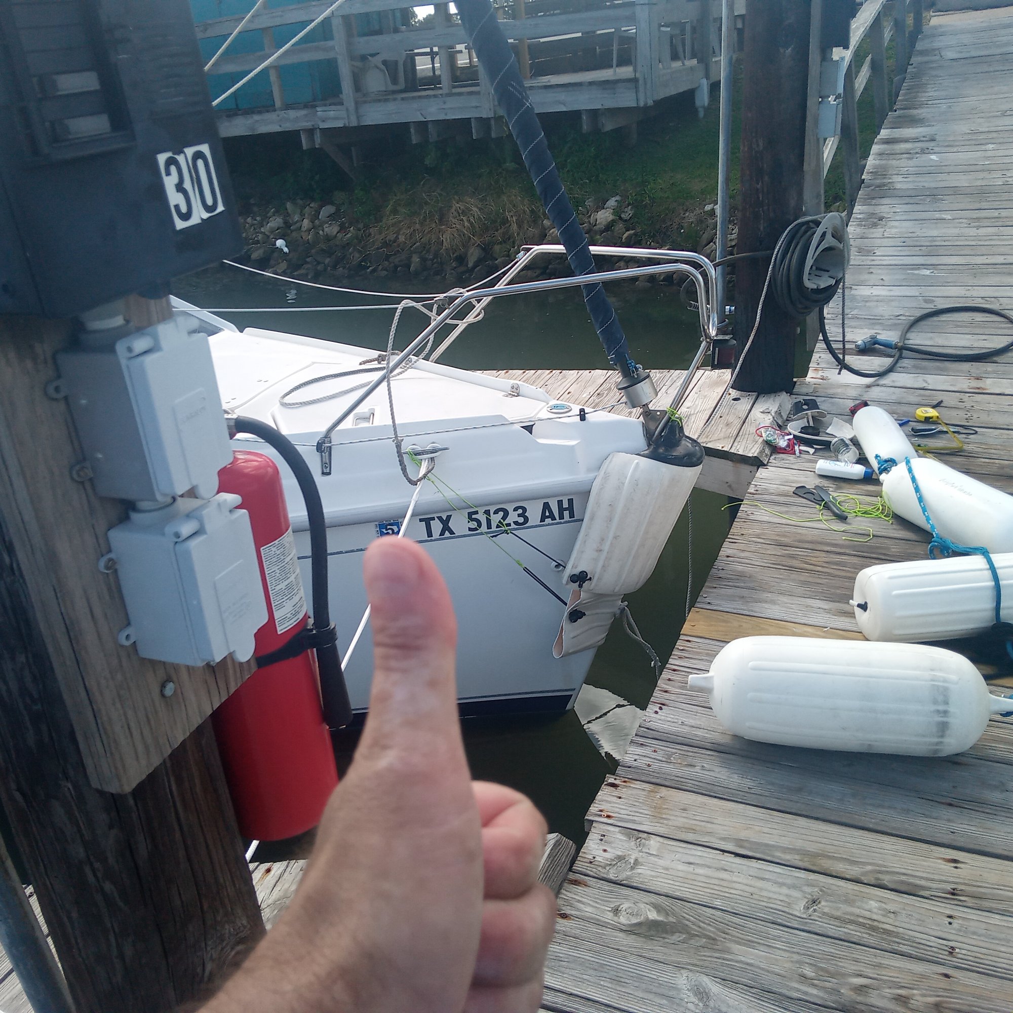

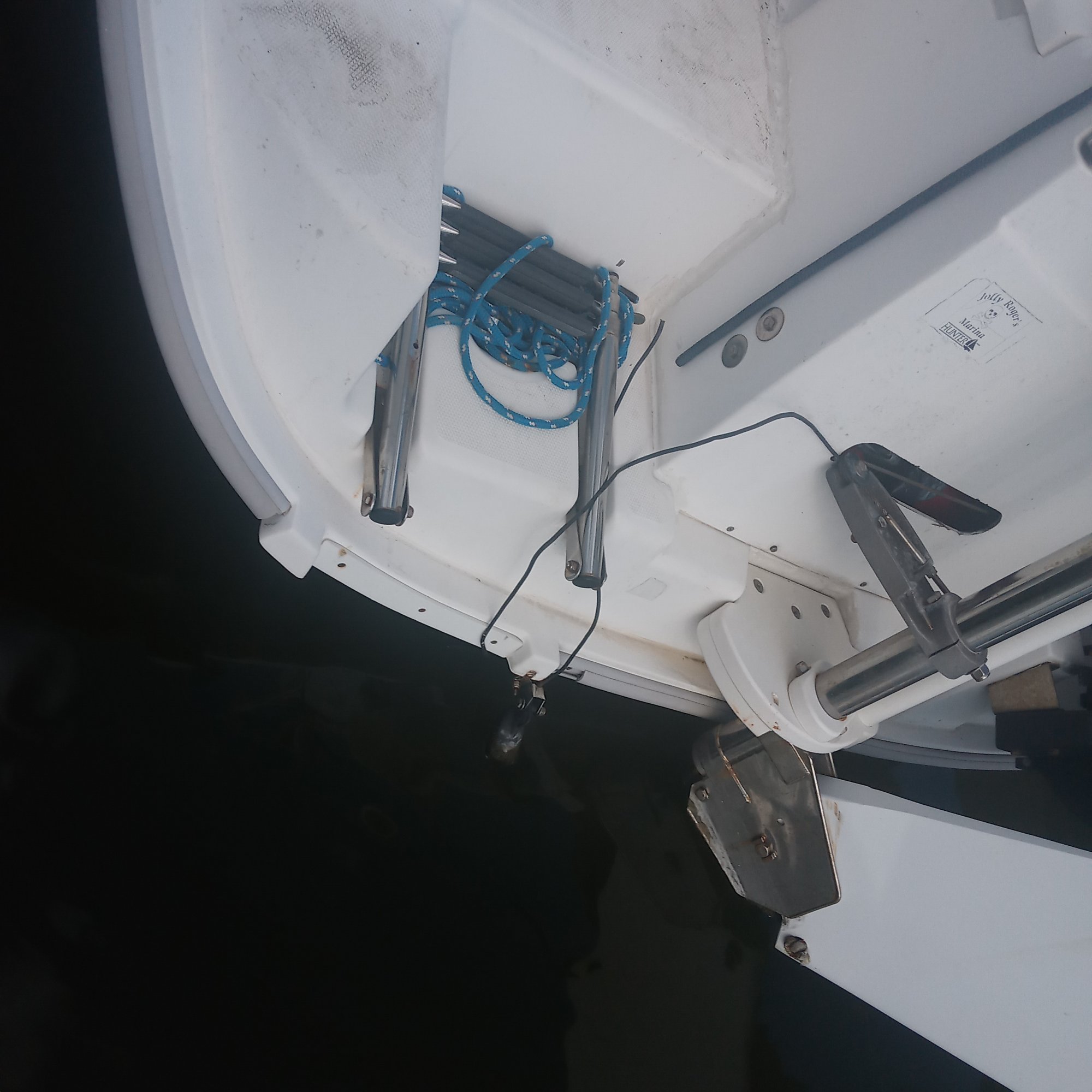

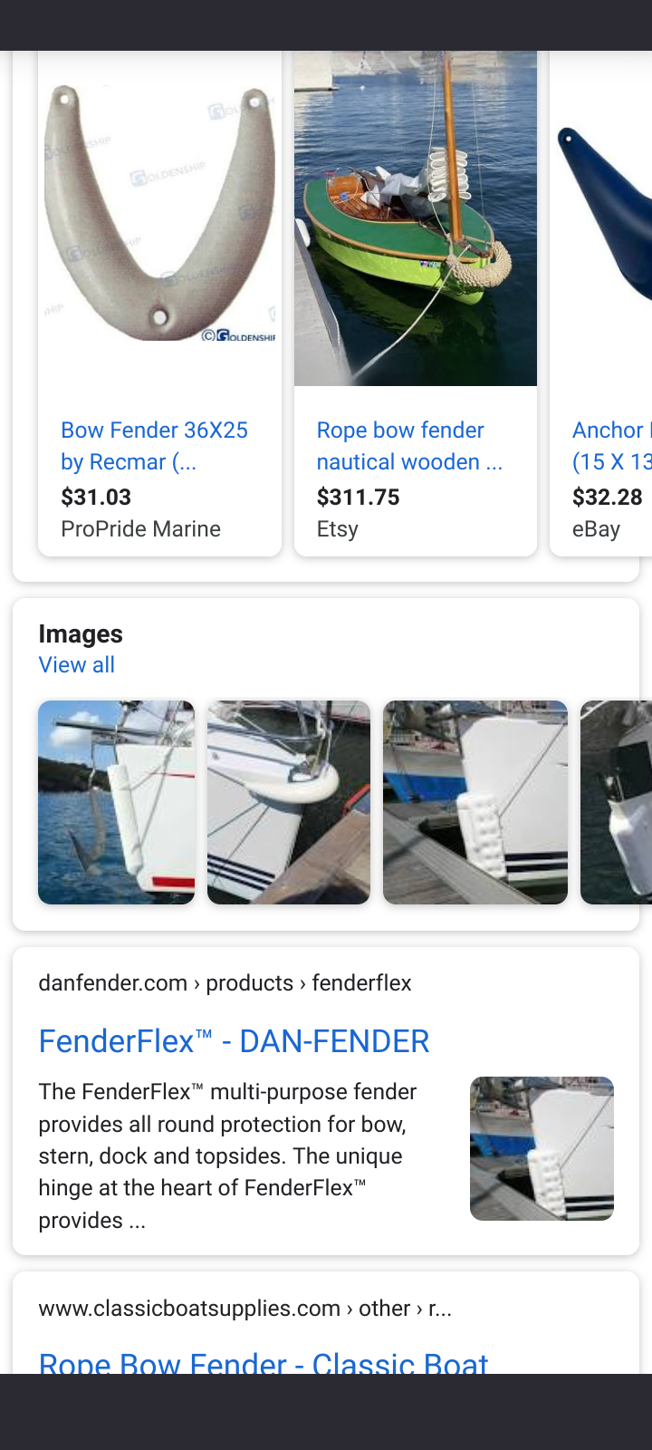

Trying to avoid scratching my new h260 I cut up 2 "pill" rubber fenders and sailbungeeball thingies, to homemake 2 bow front fenders, so can come into slip fast with less fear. Ha. I imagine in hi seas these might get ripped off. But seems to work. SEE PHOTOS. Is there a 2-3 foot store version that is proven to work on h260, what is model???

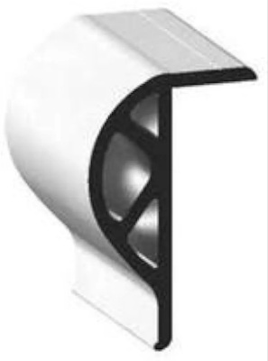

I've seen some people use a keel guard on their bow. They come in different colors and lengths and are hardly noticeable. Here is one version, but I've also seen ones without the ribs.

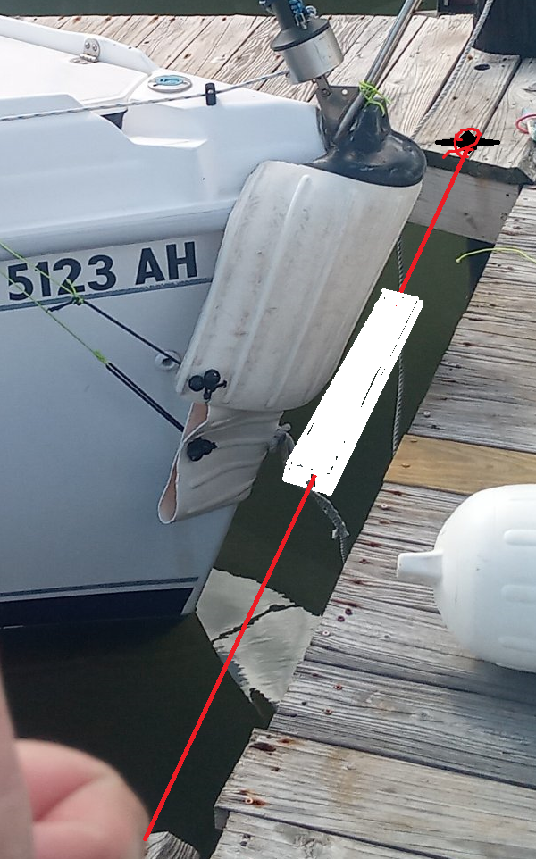

But if you want to consider an alternative.... here is what I did in my slip... (didn't have a photo so I mocked-up your photo). I put a very tight spring line a few inches from the leading edge of the slip... I also tied a fender on the line (horizontal). So when I come in too hot... the spring line slows me down before the bumper hits the dock.... The spring line also makes sure the bumper is between my bow and the dock at all times.
