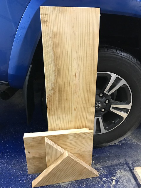

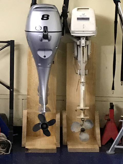

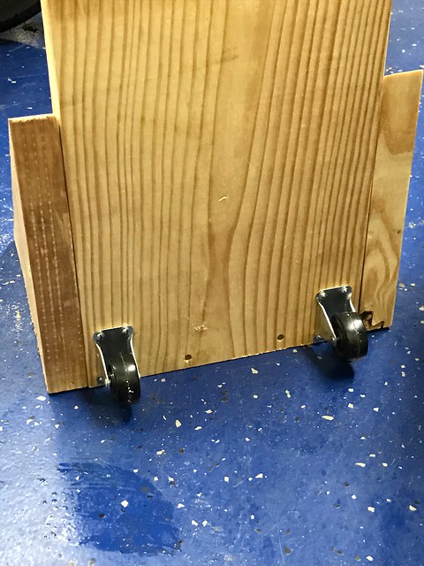

I needed a couple of outboard motor stands for the old and new outboards. Couldnt find any used and wasnt going to pay $80 or more for some flimsy and bulky stand. Im a strong believer in the KISS principle. Came up with this: 4 pieces per stand, and some good 2 1/2" screws. Works great and only cost $20 for the two. Well, add another $6 for the deluxe roller version w 2 fixed casters. Took less than an hour to make both.

I like that, need one too. Going to make one like such.
There is not much extra room in my garage, that slim design is just fitting.
Thanks for posting your idea.

Nice... Great Idea. Searching DIY outboard stands I saw this on Google Images. Love the simplicity and cheap materials.

What a wonderful idea. I'm definitely going to steal this idea. Sure beats laying the motor on the ground.

You're design has a great modern aesthetic that I really like. You might consider adding some type of cross grain support to help prevent the 2x12 from splitting as it ages and dries out. I really like the addition of the casters.
