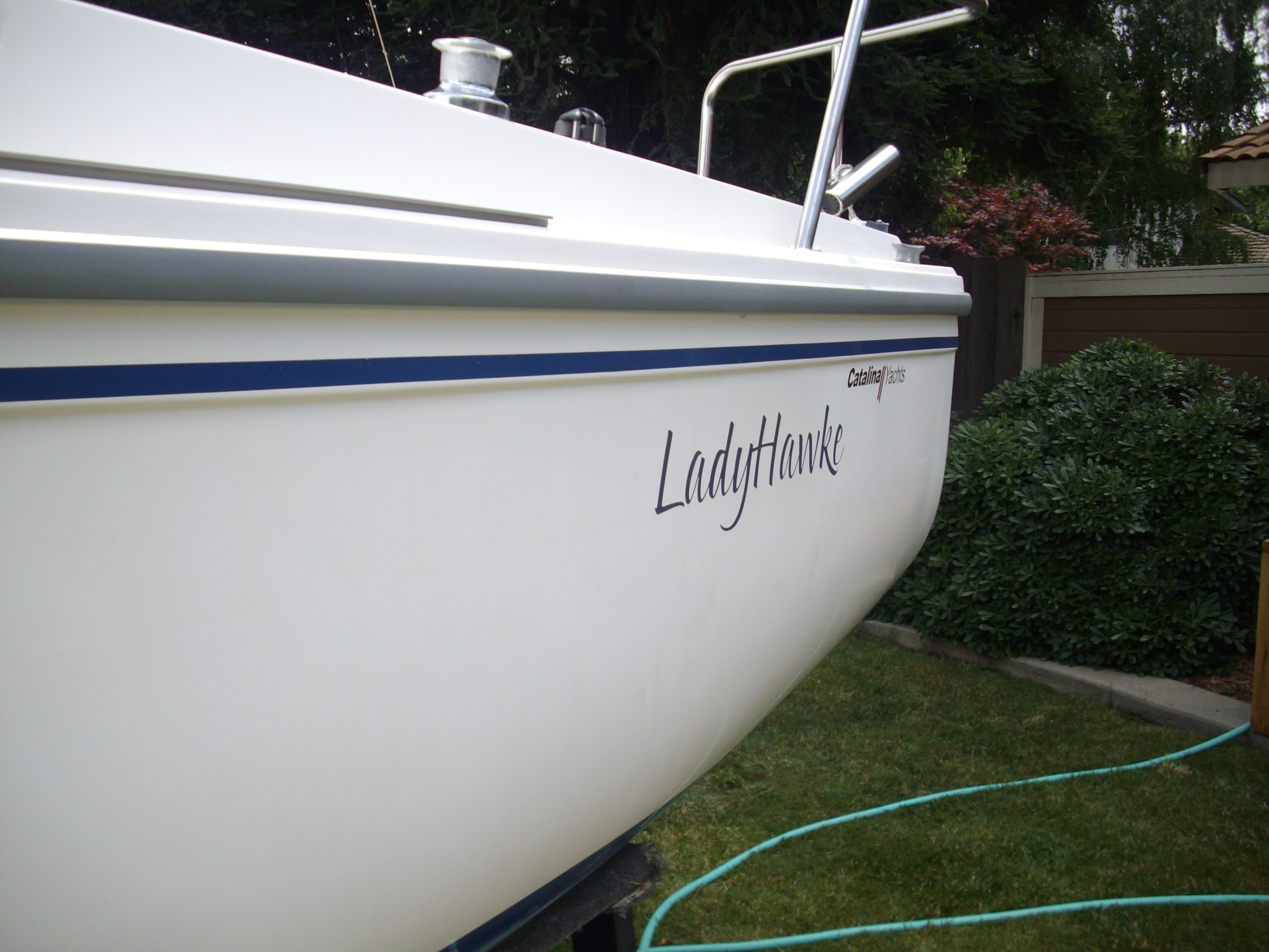

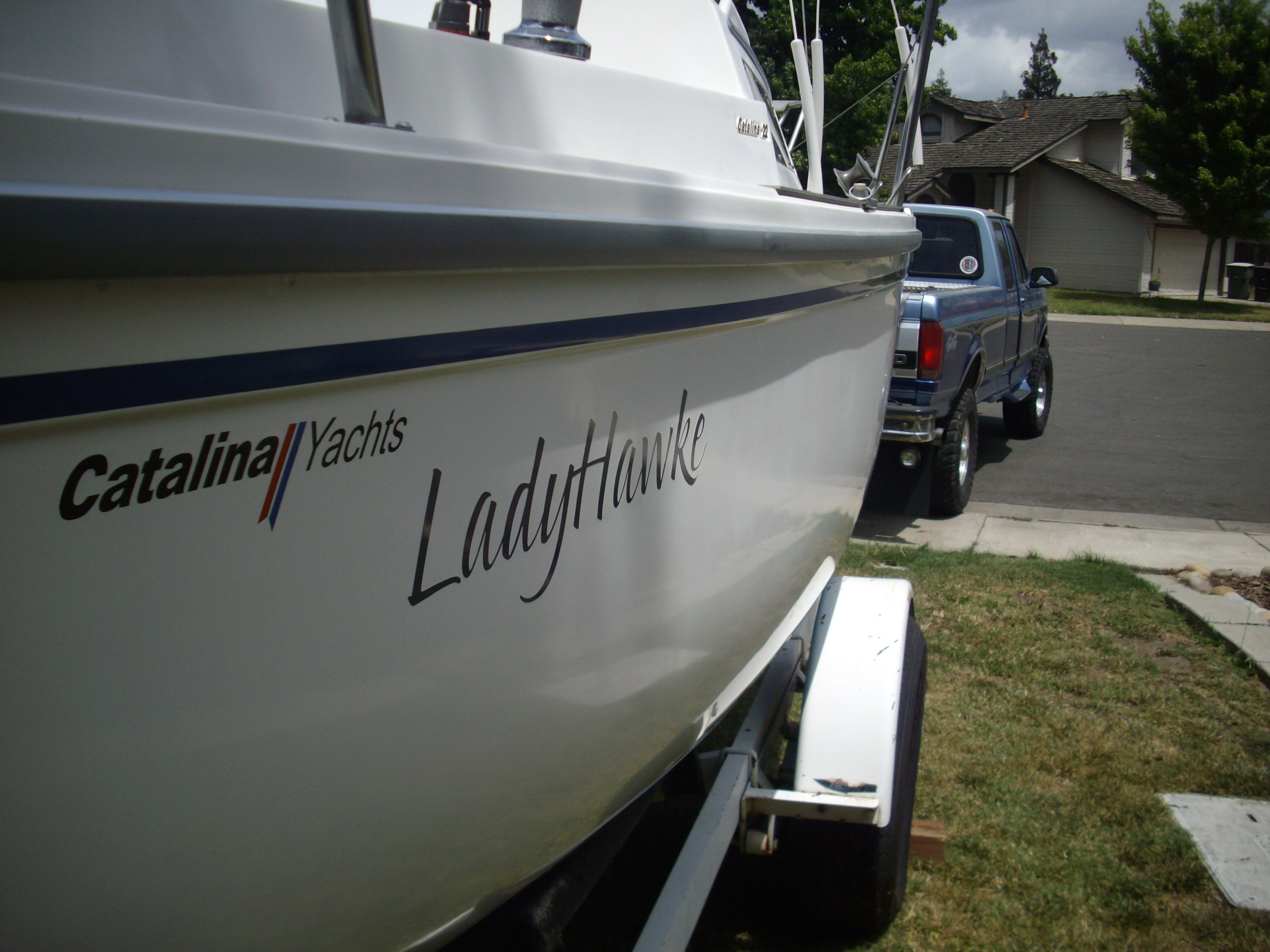

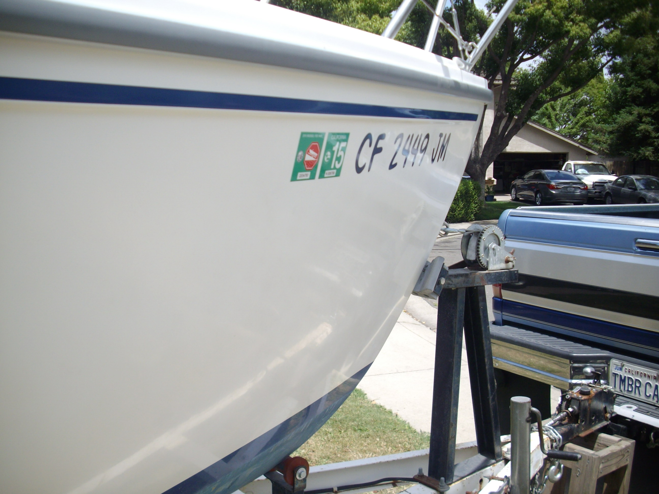

I'm happy with the results using Poliglow on my 87 C-22.
Before
After
After

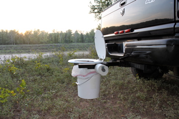

Or how 'bout this? It's only $69!
You could bolt it to a bulkhead in the head or attach to the transom. bumper dumper

Hey now, I like that bumper dumper! I think (I am still thinking) you won Peggy. I might go with the Thetford MSD with the 5 gallon tank. Since our marina is private and all slips are owned, we have our own pump out machine and pump outs are free and with my wife and I only going out 90% of the time for daily sails or 2 to 3 days max, a 5 gallon tank should be OK. I have the winter to decide now.

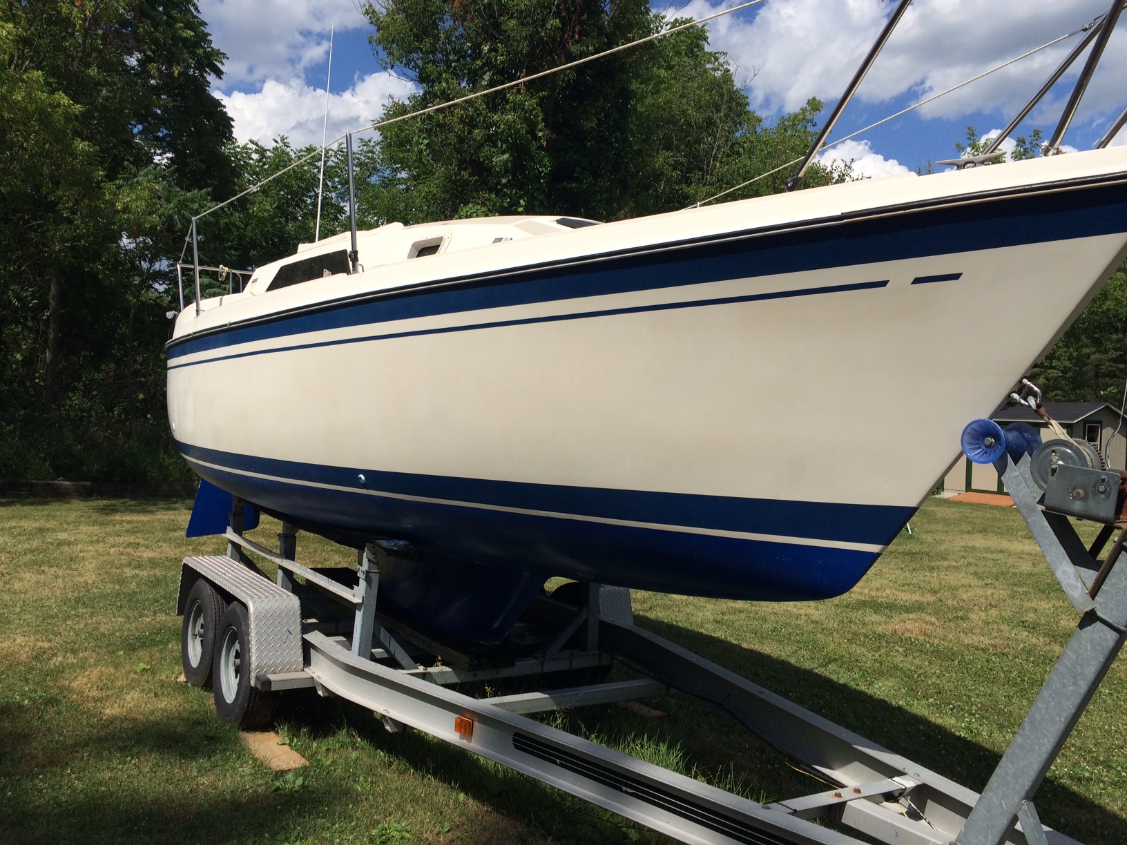

Recent hull picture after 800 wet and orbital sander (I moved fast and soaked it when I used the orbital sander). Moving to 1200 and then 1500 and ordering some Presta Gel Coat Compound, Presta Ultra Cutting Creme and Collinite #885 Fleet Wax Paste Version and 3M Yellow Wool # 05713 and we'll see what happens after I compound and wash it with FSR and go through the rest of the steps. I bought the Makita 9227C and a 3M super compounding pad. I'll hang onto the PoliGlow for now and only apply it if my compound and all steps still looks like crap.

Well, now I think your moving in the right direction. By going up to 1500 grit you'll have less compounding to do.
One last tip. I believe it was in Maine Sail's buff and wax article where I read the fleet wax was a bit harder to put on and remove than the 3M Marine Wax. While your resting your arms, might want to read through that again.
Take it slow and don't take on too much in one day and I will think you will be pleased with the results. That hull pic shows you got a good first round.

She looks sweet. I followed the article and I'm pleased with the results. The hard part is the small areas on the deck where the buffer can't go.
