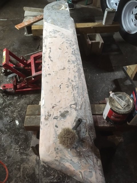

I have a 1982 MacGregor Venture with a swing keel. When we bought the boat we could see significant cracks in the glass for the keel but figured it would be somewhat superficial rebuild, but once we got the boat up we could see that the repair was pretty significant.
We haven't fully lowered and removed the keel yet just due to the logistical challenges, but will be doing so. We decided to pull off all the glass. The structure of the keel is an iron bar that had some bad corrosion and it's embedded into the lead weight. A wood form was abutted to the bottom of the iron bar.
The top was basically formed by bondo covered by fiberglass.
Here's what the keel looks like now:
The metal bar is embedded in what I assume to be a lead bulb. It seems pretty well attached.
So we are looking to basically rebuild the keel. Is the way this keel is built legit? Looking for general comments, advice on the best approach. I'm assuming I need to build a mold to recreate the top bondo? Anyone taken on a project like this before?

Looks like somebody had already made their own keel. That is not an original design. It is very creative though. Not a very stable design, which is why it started to crack apart. Here is what a Mac25 keel looks like. One solid cast iron piece. The earlier Mac's were made with steel plates all welded together and covered in glass mat. Similar to yours, and shared the same fate....cracking apart. What size is your boat?

Looking at picture. Is that a piece of wood. Not a factory job. '82 should have come with cast iron keel? PO must have redone once before. Look for cast iron without fiberglass covering. Had same issue with our '22. It was a bear. Good Luck. What part of country are you in.

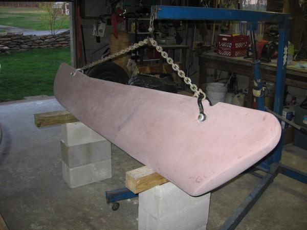

Oh my Nicole... you have your hands full! I just finished a V222 swing keel... if I can be of any help let me know. I just posted pictures. My only suggestion would be don't get to hung up on fairing. Yes you want it as fair as you can get it, but your boat, like mine will never be a racer and litterally the hours and hunderds invested will not gain you a half knot! Good luck and feel free to reach out.

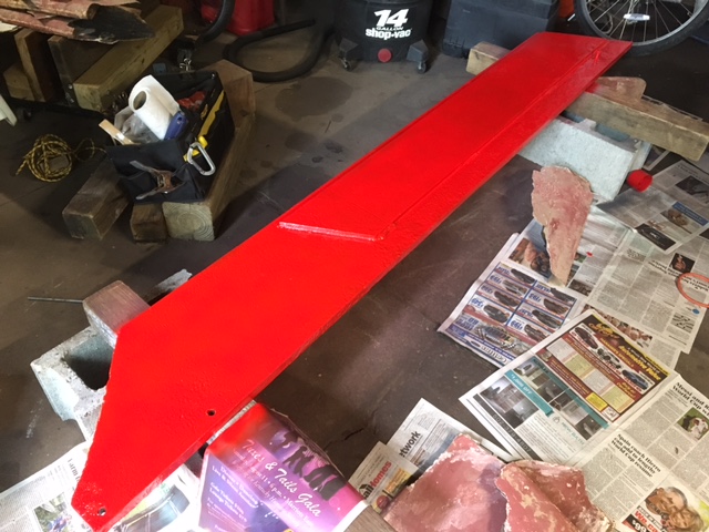

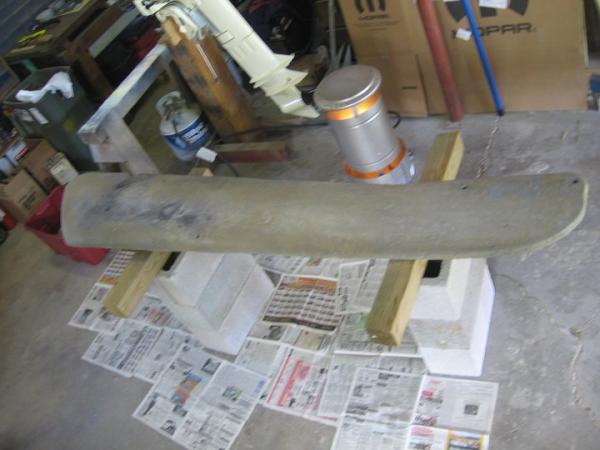

Another consideration is if the boat is going to be kept in the water or on the trailer. I know many sailors here might take exception with my keel refab, but I wanted to sail so I took the path of least resistance. I stripped the keel back down to the bare iron core, ground off all the rust and coated with Rustolium:

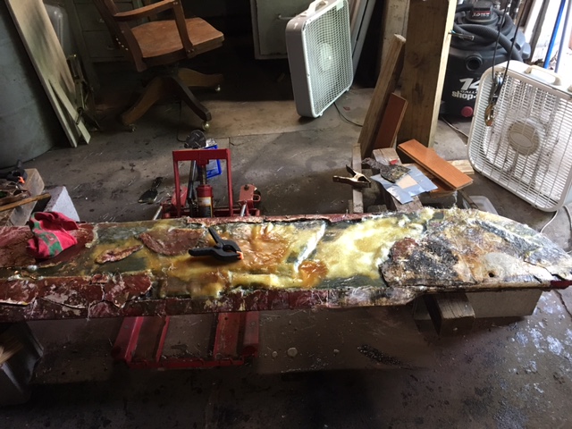

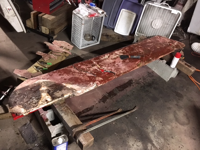

Then I assembled all the remaining pieces or at least the big ones:

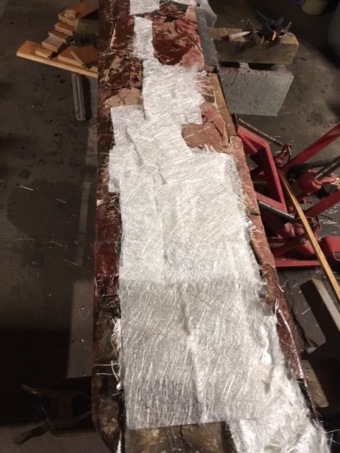

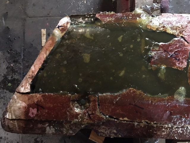

Then I attached the pieces to the keel with epoxy resin and filled any space with fiberglass cloth and polyester filler:
I know it looks ruff, but once the resin set up, I could shape it with a sander. The reason I went this route was to avoid having to rebuild the LE and TE. This is where your PO used the wood I suspect, somthing to add material. Without it, there is a lot of space to fill. I chose recycling the old pieces because most of the LE and TE was still intact and could be placed back on the keel.
Once I had the shape, I coated the entire keel with fiberglass cloth and a thick coat of resin and many coats of Rustolium.
Again, many will say I should have (insert opinion here) and they would probalbly be right. That being said, my route wasn't ideal and it will in fact rust again. But, I store my boat on a trailer and if I get a few years while I search for or have a new keel fabricated like you, at least I'll be sailing.
