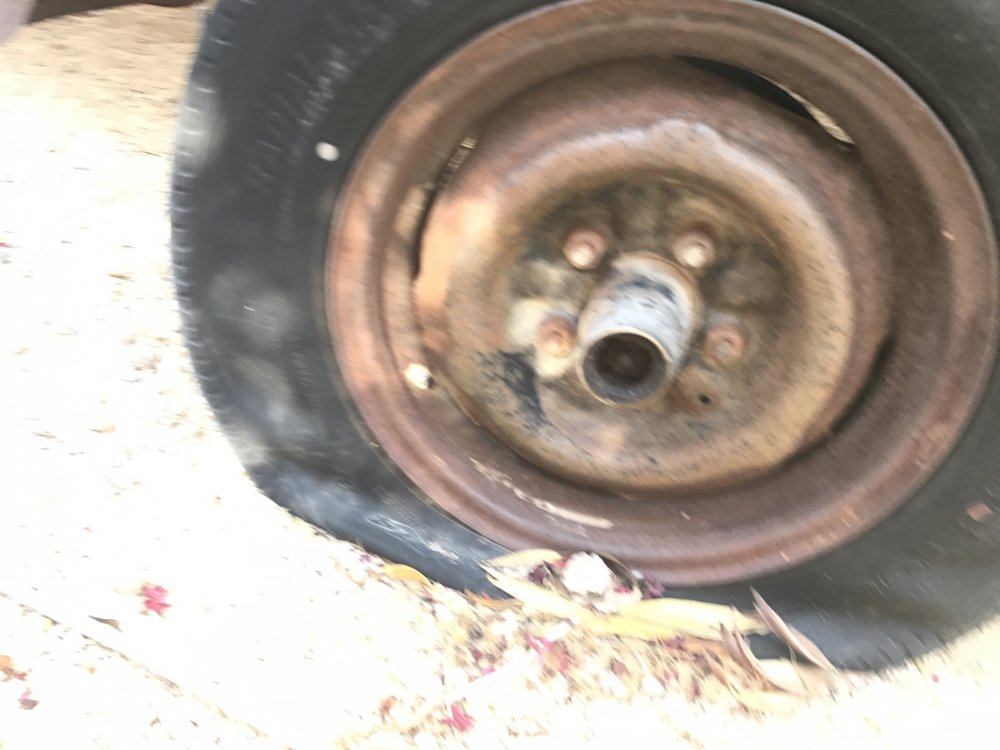

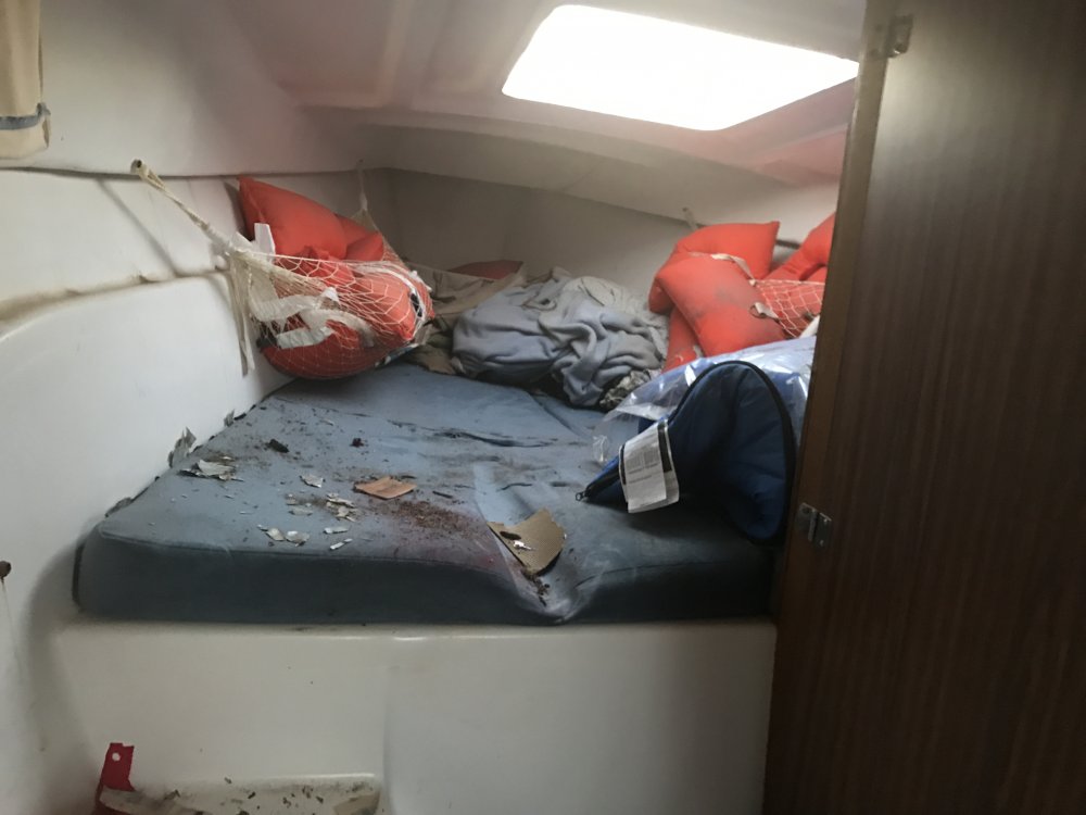

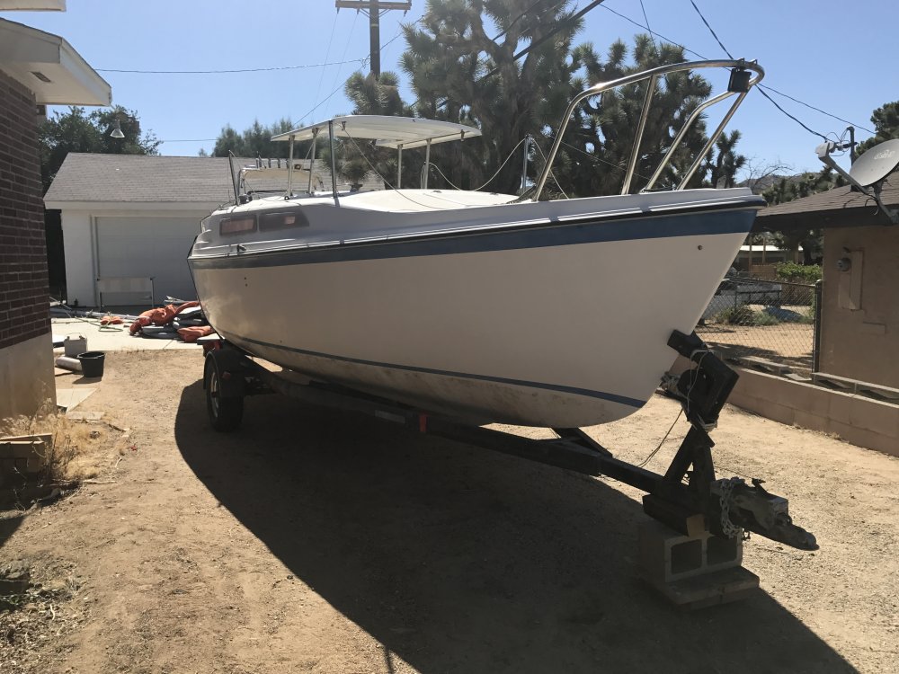

So, I bought a 1987 Macgregor 26D last week , with trailer, that has been sitting in the desert for over 5 years. Almost all of the hardware is rusted and the deck is soft on both sides of the forward hatch, but the pieces are all there. The port side shroud deck hardware was somehow pulled through the deck presenting a small fiberglass repair. After reading that you guys like to see projects, I hope I can successfully navigate posting pictures so I can here feedback from Mac 26D owners.
I bought the boat from a friend of a friend who needed the money, $3600, so I paid the asking price. It's been sailed primarily in the San Francisco Bay by the second owners, and I'm the 3rd. I'm new to sailing but not new to boating, but have been off the water for awhile. So I hope this project helps my 12 year old son and me learn repairs and rigging while I complete ASA 101 and 103 sailing courses, and offer me timely opportunity to learn to sail. I too would like to cruise with a live aboard in a few years while keeping this Mac 26 D trailer sailor ready to travel, Great Lakes, San Juan islands, San Fran bay, etc. , feeling it's best for protected waters. Anyways, here we go.
Jul 3, 2018
29
Macgregor 26D Trailer Sailor

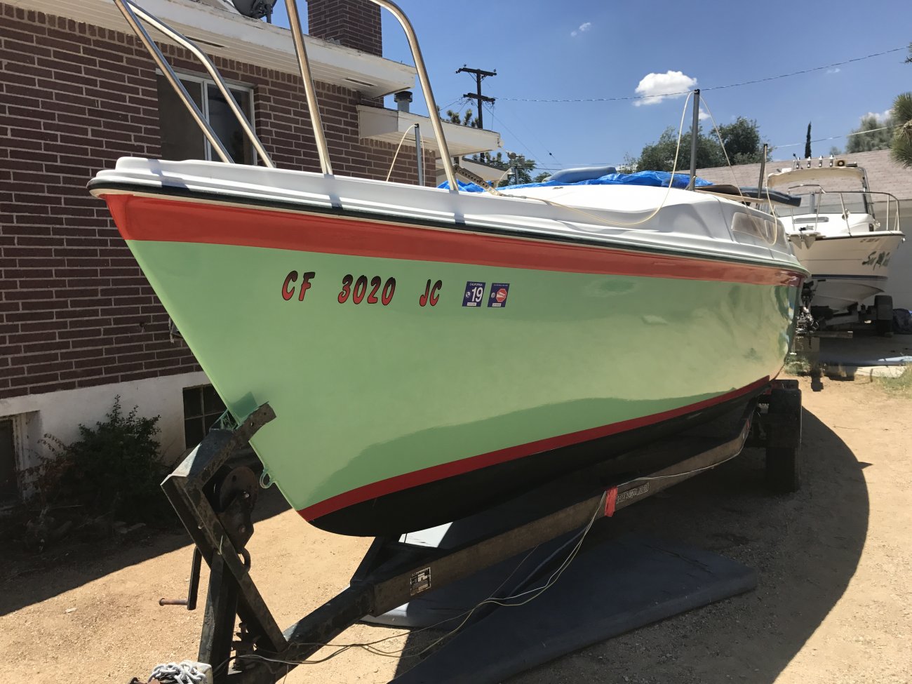

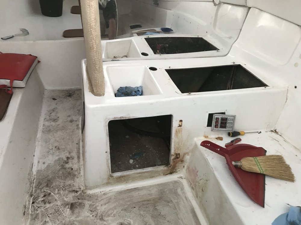

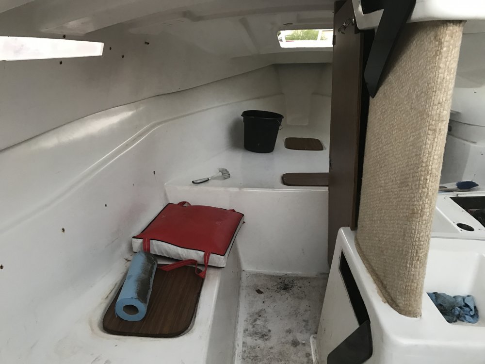

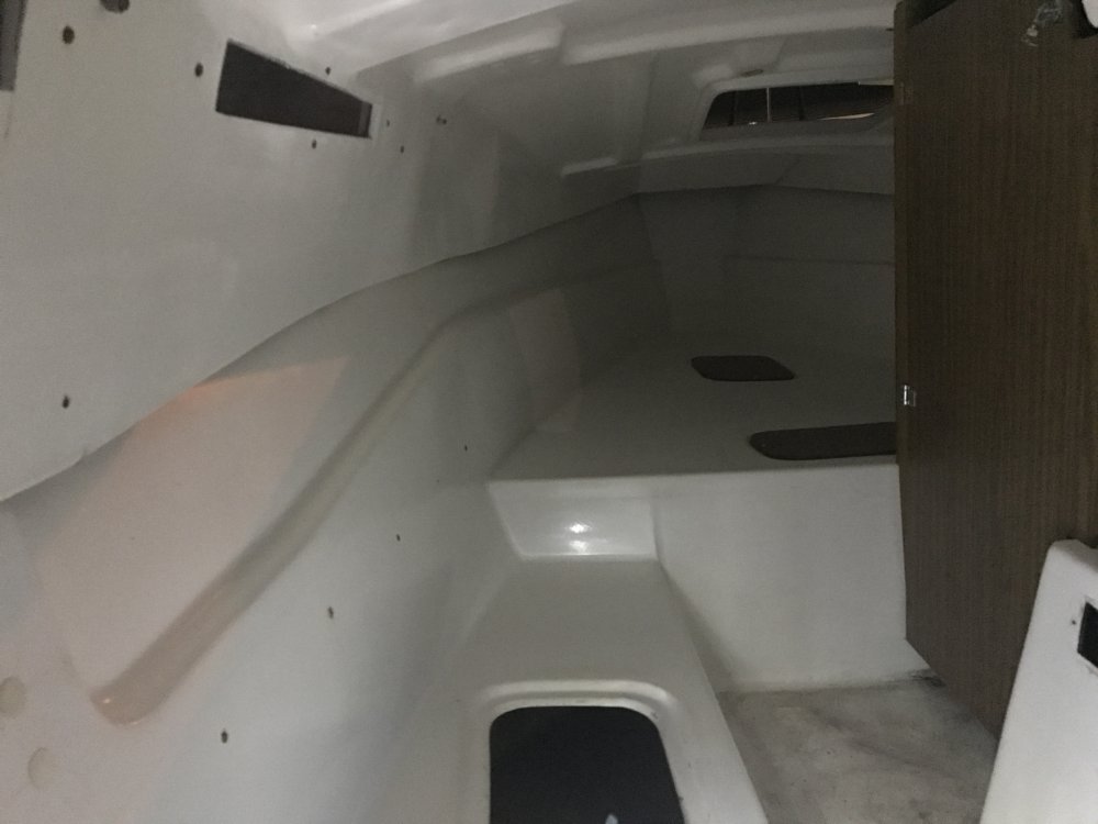

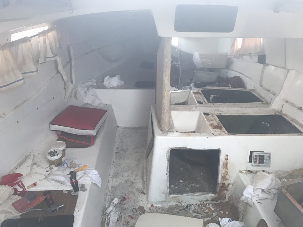

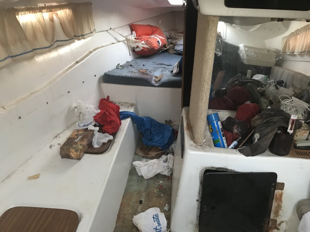

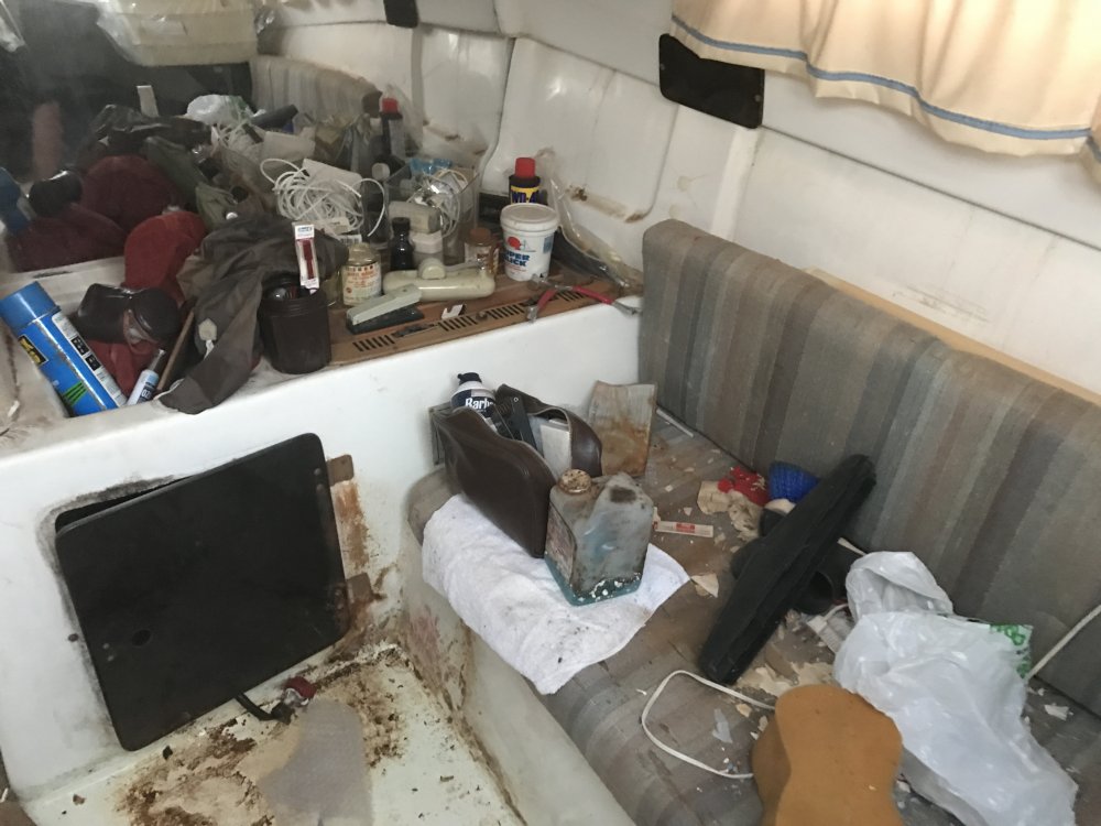

So, here are some pictures from last week. The boat was pretty nasty due to neglect so my first order is to clean. My plan is to assess, repair, upgrade, sail. Any feedback is welcomed, positive and/or negative.

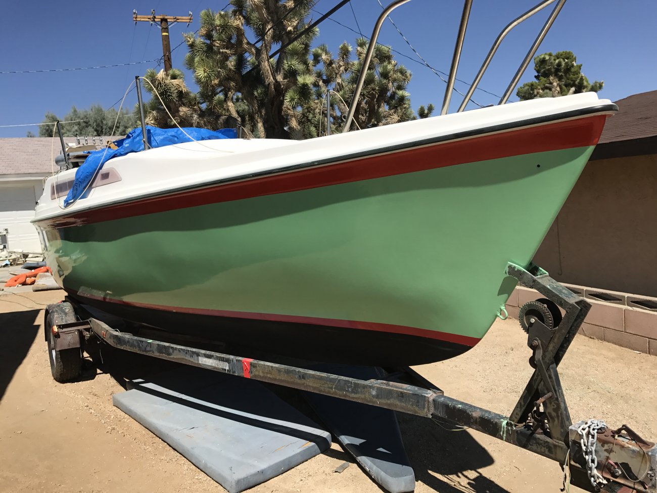

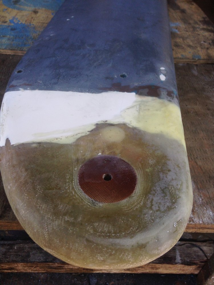

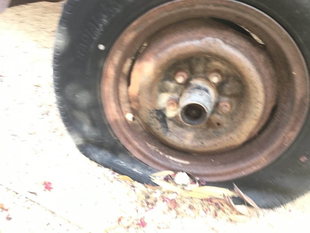

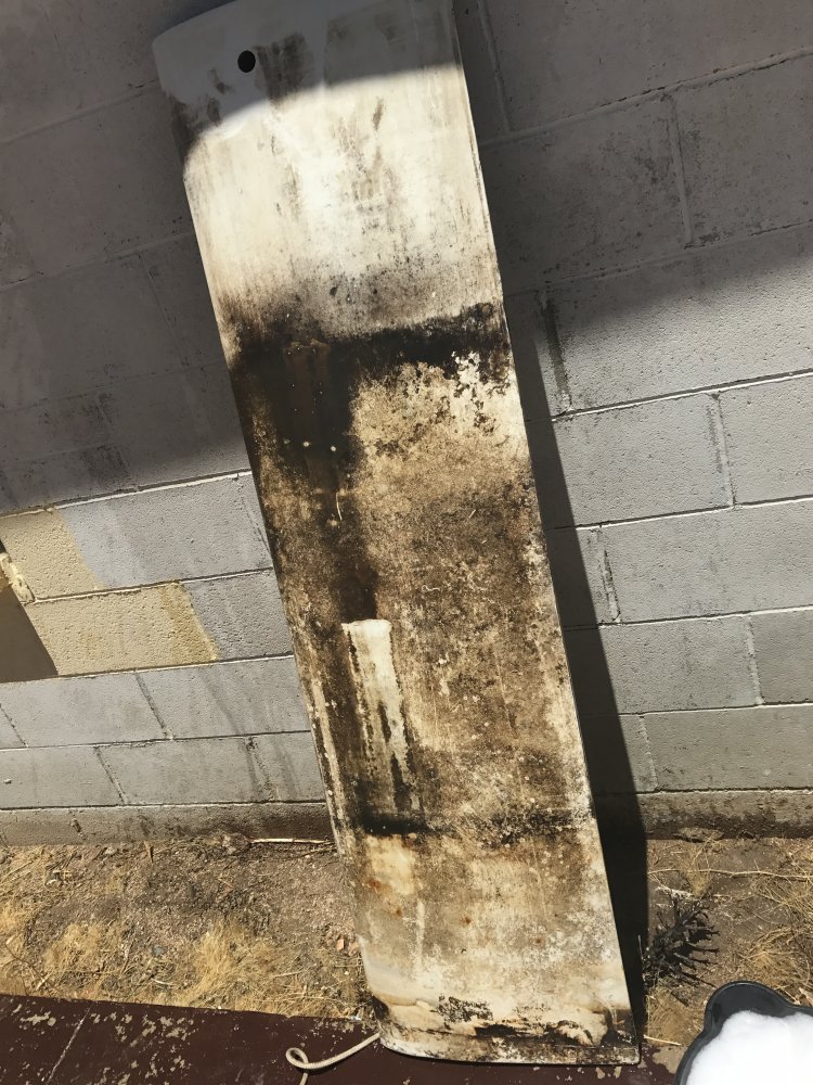

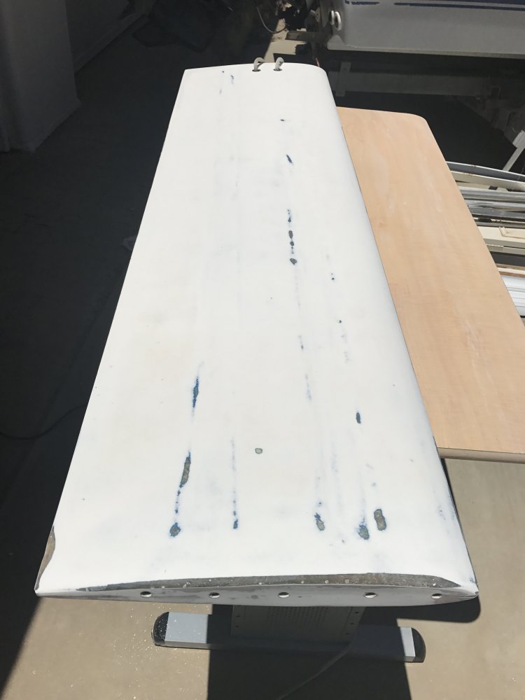

Here it is after a little work. I think the daggerboard is in pretty great condition for a patch and paint, showing a before, and then after sanding. I'm allotting $5400 for the boat project bringing the total cost to $9000, so any input on how to spend the cash would be welcomed also. I ordered me disk break assembly for the trailer and a few new parts like upgraded sink faucet with water bag, ballast sealing gasket, daggerboard rope, rudder rigging...

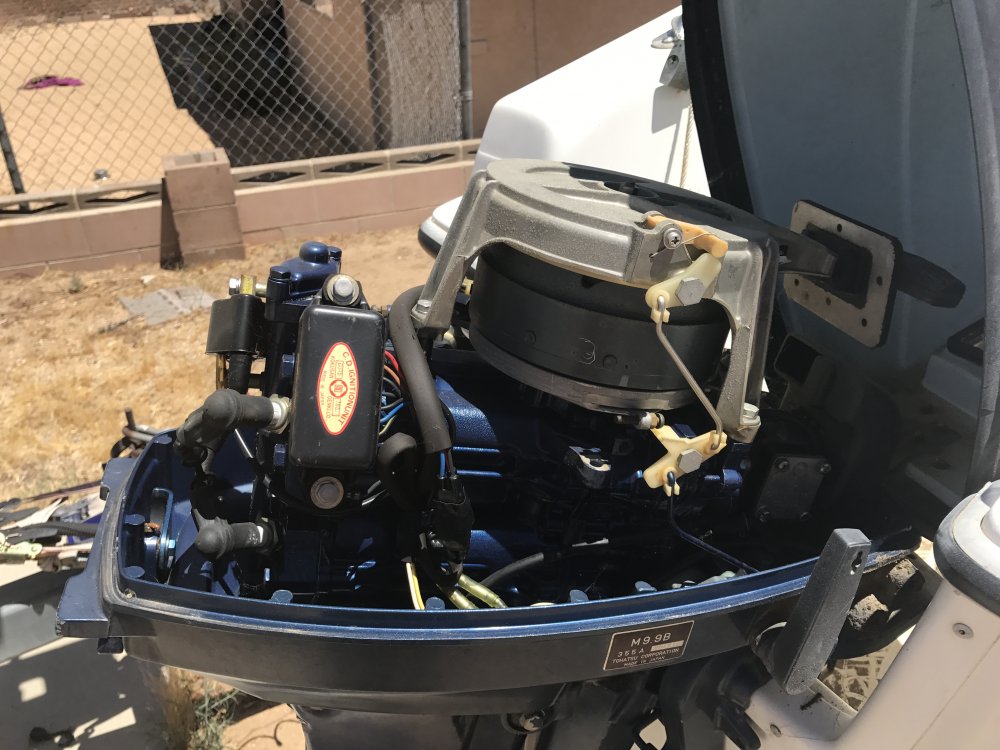

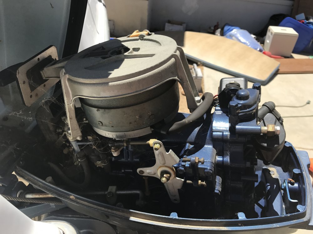

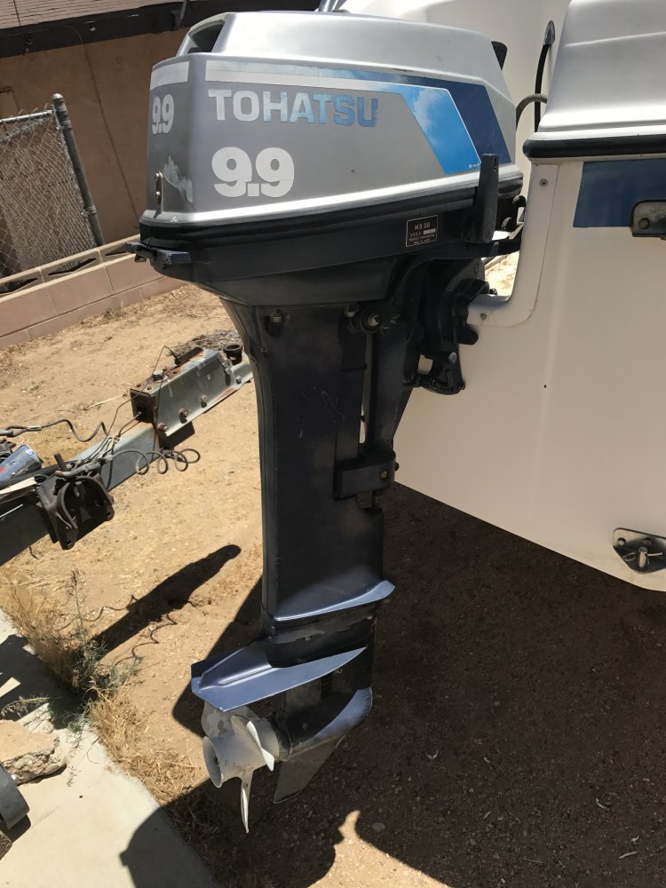

Hey Sumner, thanks for commenting. Yes on the motor 9.9 Tohatsu. I have the Manuel but it's disintegrating so I'm going to photocopy it and attempt initial maintenance to get it started.(pics).

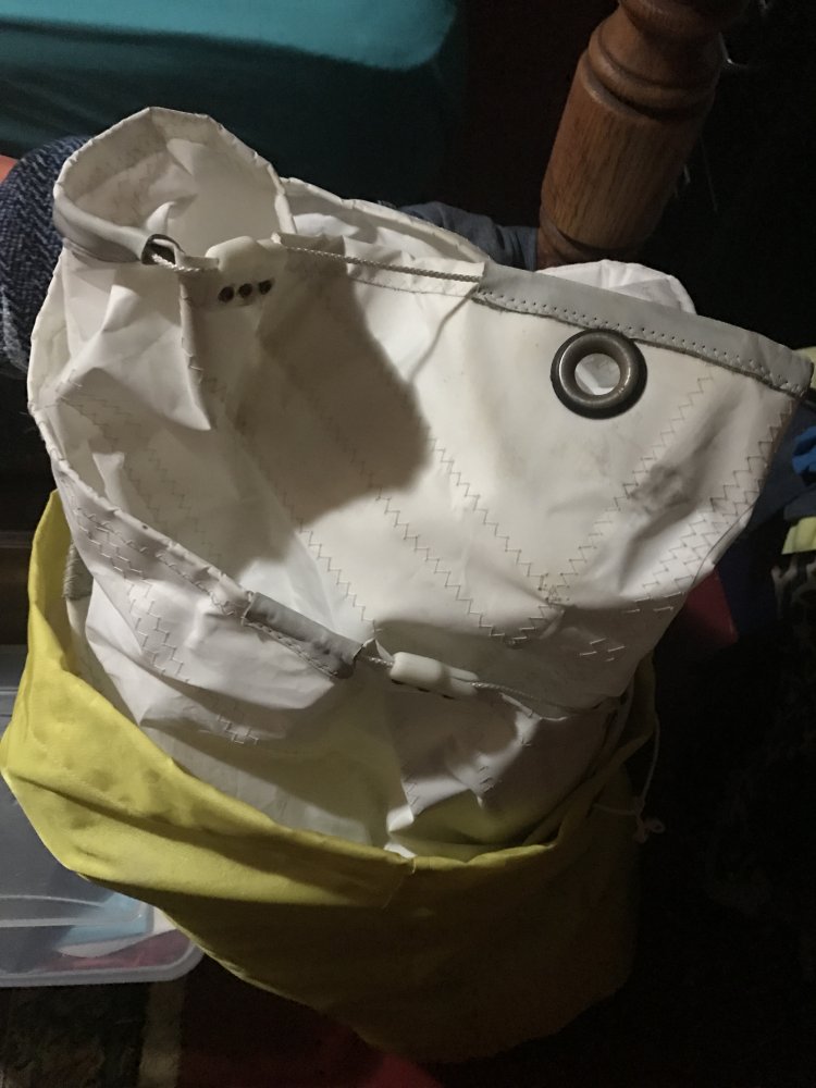

I have the main sale and jib. Feels crisp but haven't taken them out, previous owner said he did and said they're good. We'll see. I haven't taken them out until now know how to properly roll or fold them, seems to me rolling would be better than folding, I don't know. (Pics)

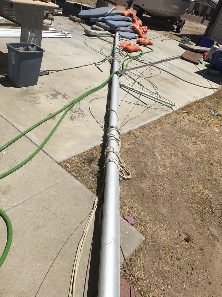

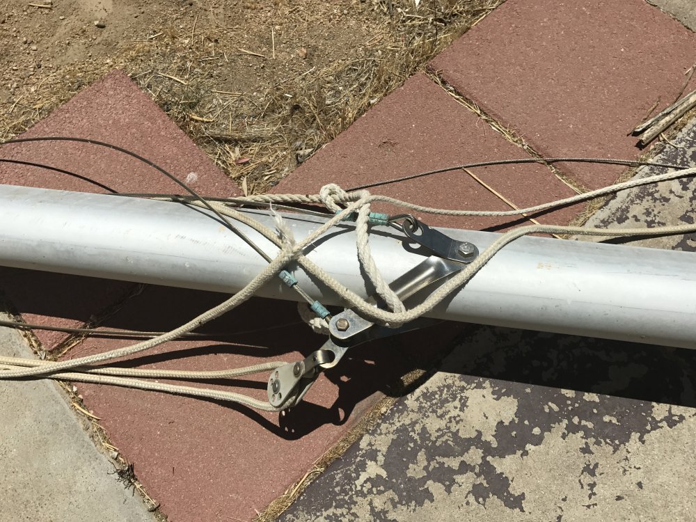

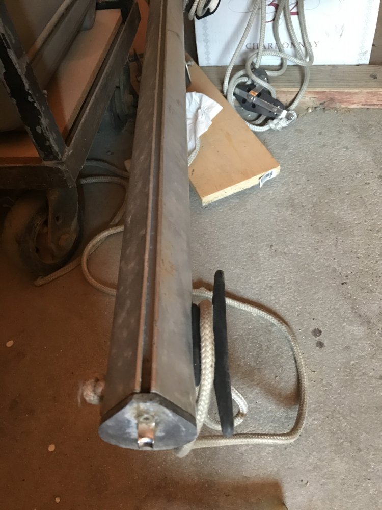

The mast appears good. (Pics) needs new rigging hardware, blocks?, the cables seem alright. Not sure if I should budget in standing rigging, will definately need new running rigging, mainsheet package, and I'm thinking a rolling furling system for the job. (Pics)

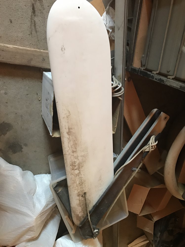

The rudder looks great, little paint chipping but I'll sand patch and coat it.(pics)

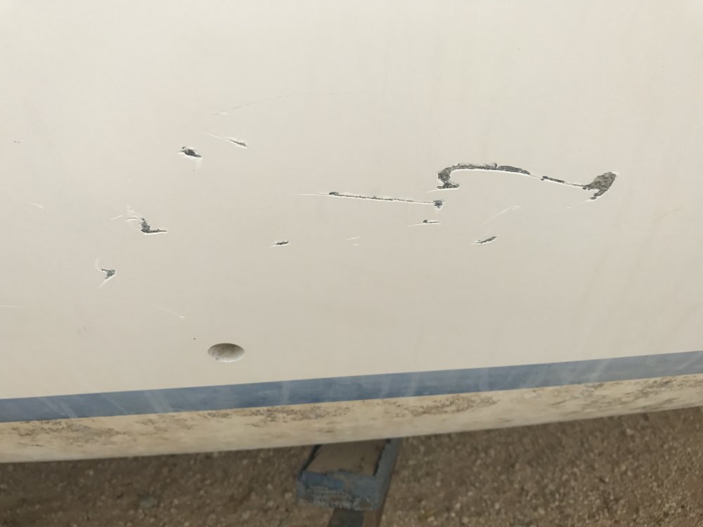

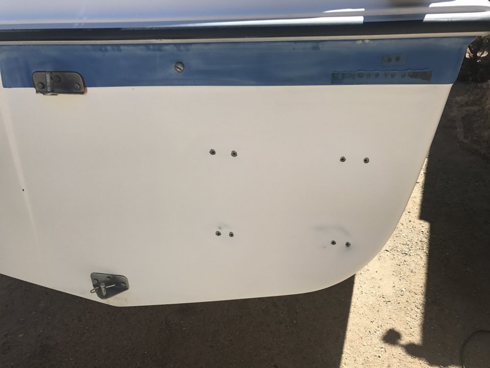

I also removed the aluminum swim platform leaving 8 holes in the transom to fill, I dremmeled them to open them up a little more to better receive the patch.(pics)

The outboard looks to be one of the older carbureted ones from the housing. Is it a 2 stroke or 4 stroke? Tohatsu motors are great so I'd expect it to still be fine. Change the lower end oil and the upper if a 4 stroke and I'd replace the impeller also as it could be old and maybe ready to come apart.

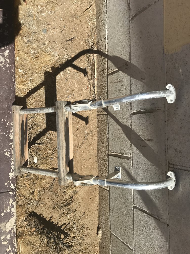

Was the swim ladder beyond repair? Really nice to have a ladder back there.

The Tohatsu is a 2 stroke M9.9B. Looks very usable, setting future sights on a nice new 7-10 hp 4 stroke.
The swim ladder could be restored. I didn't like the way it was mounted inside the transom, looked like a quick install using scrap fiberglass panels. Probably go with a stainless steal ladder if I put one on the stern, but may grab an over the side west marine special if the dimensions fit.

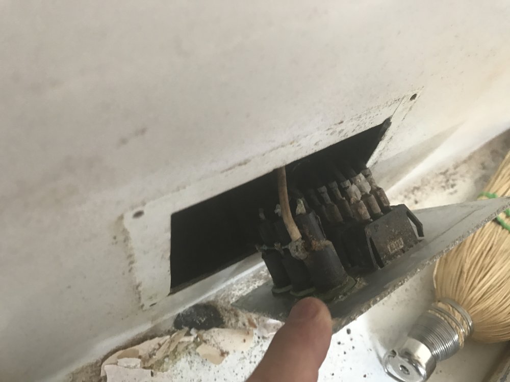

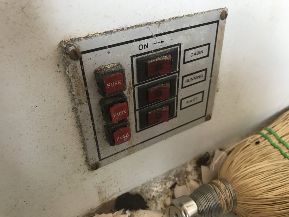

I watched one of your videos with the wiring mess. I'm dealing with the same exact 3 switch and fuse confusion but my wires want to break and disintegrate at the slightest movement. As far as I can tel the 3 fuses are soldered together in front of the switches and a lead from those fuses goes directly to the battery. Horizontally from the fuses, each fuse sends a short wire to the center prong on a corresponding switch. Each switch receives a positive and negative wire from whichever light that particular switch services. It's an opportunity for me to upgrade the wiring. I'm glad you guys showed up. Getting some good insight.
