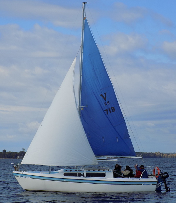

My 77 V25 was not a mast head rig.
Interesting. The notes on SailboatData for the MacGregor 25 says the Venture 25 was a masthead rig, but their page on the Venture 25 says it was fractional.
