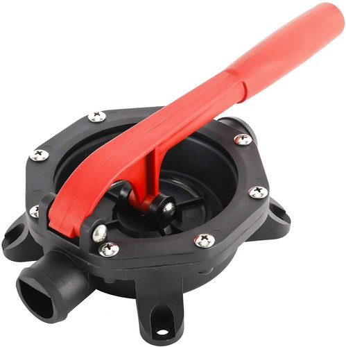

After replacing 2 expensive electric pumps I bought this 5 or 6 years ago. As near as I can tell it empties as fast as the electric.
Wow. That looks like a nice option but at $25 it seems too good to be true.
Sailm8
Feb 21, 2008
1,751
Hunter 29.5 Punta Gorda
That's not the acual one I bought. It was only $20 and I bought 2. Have never used the second one.
