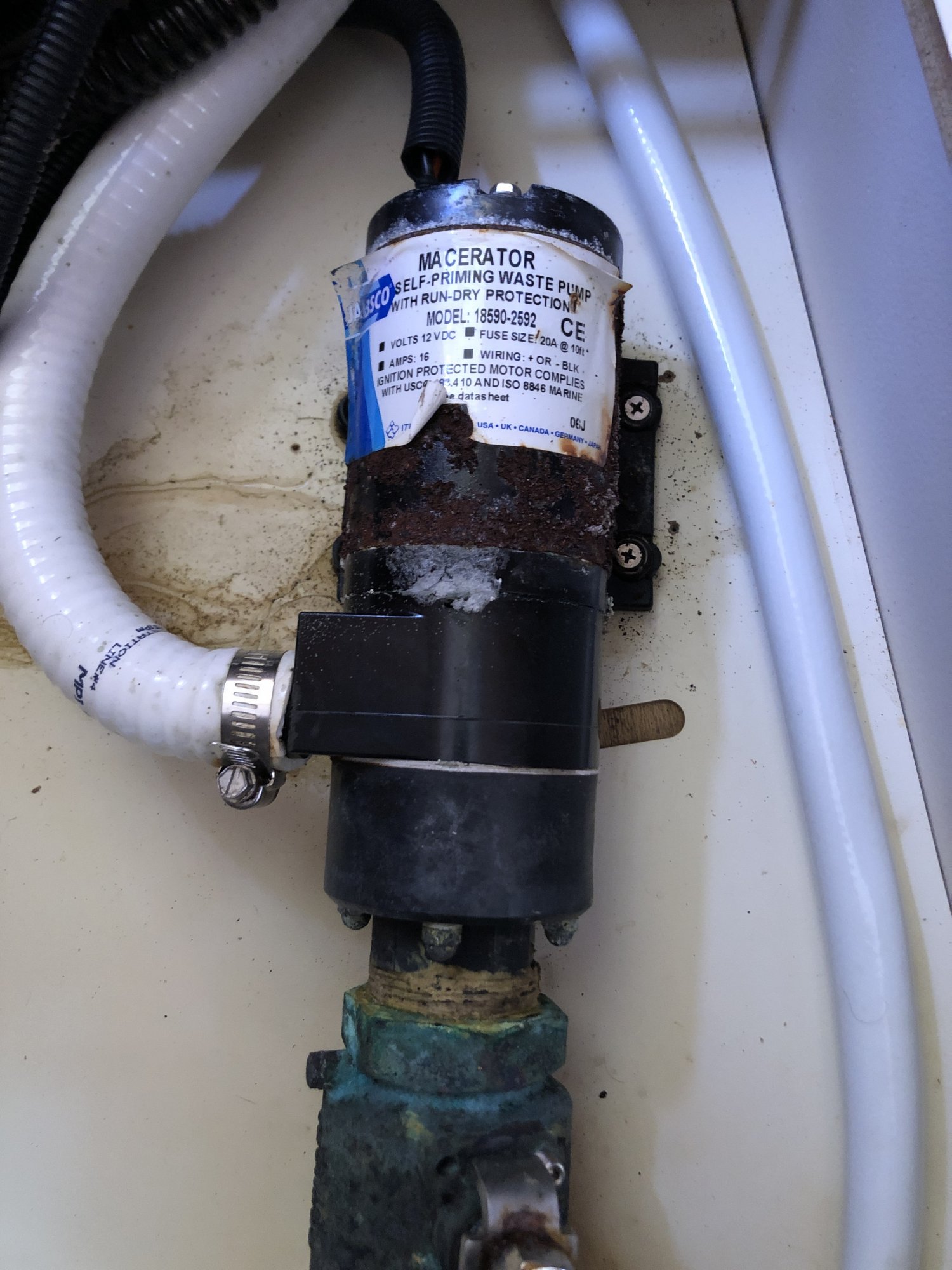

My jabsco macerator is leaking quite a bit and I’m assuming it’s rods have corroded like everyone else’s. I’ll be replacing it this weekend with a raritan model as I don’t have enough height in this location for Peggys recommended waste pump. Do I just use pipe dope to seal the threads when I screw the new macerator to that valve? Picture (before cleaning) attached. Thanks for the help!

If the threaded connection leaks, wrapping the threads on the male fitting with plenty of Teflon tape will seal the connection. But what's the macerator connected to? It looks like corroded iron!
Btw...the hose connection--all your hose connections-- should have TWO hose clamps, with screws 180 degrees apart.

Due to constraints with what adaptors were available locally I ended up having to purchase a replacement jabsco pump at west marine (price matched to defender). There just wasn’t enough line to move it much and if I pushed the valve any further aft it would be under cabin sole that’s basically inaccessible. I figure this one lasted over ten years (okay, its probably been leaking for years). Amazingly, only one of the rods was broken on mine.
Peggie - the valve is is corroded bronze. What you were seeing on the threads is some sort of thread sealer or compound that the dealer must’ve applied when installing the macerator as I know this is the original configuration. It was a real bear to break the seal on that!
