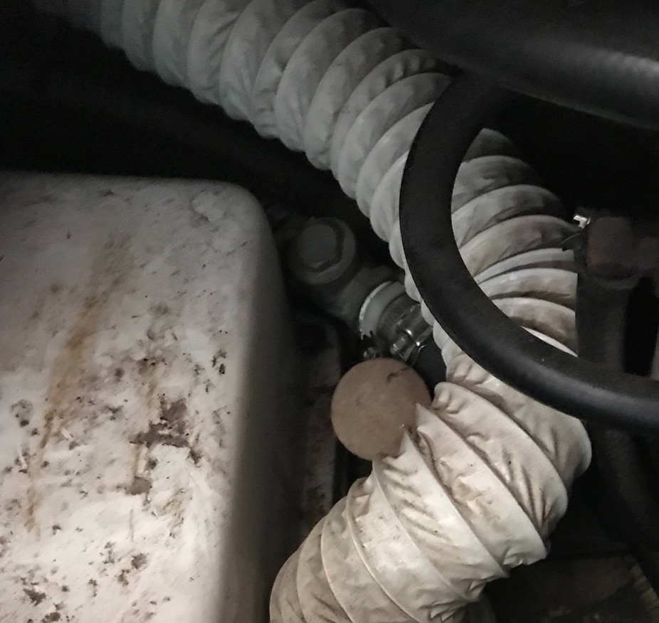

Nov 7, 2011
3,833
Check valves wouldn't be something that I think you depend on.
I don't disagree.
Here's a photo of it. It's to the top right corner of the aqua lift muffler.
Is it something else?
Dec 2, 1997
9,011
- - LIttle Rock
That wasn't the only bizarre thing about your plumbing when you bought the boat, Ward...I couldn't believe anyone could have done what I saw in your photographs! You've done an excellent job of getting rid of all of it and doing it right.
