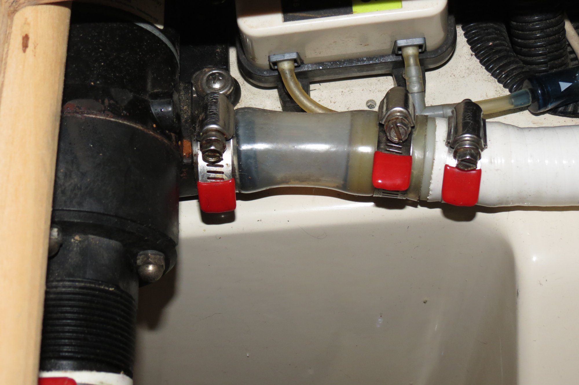

I put a short piece of clear vinyl tubing in the output of the macerator so that I can visually see when it is pumping. A flashlight shows the flow easily.

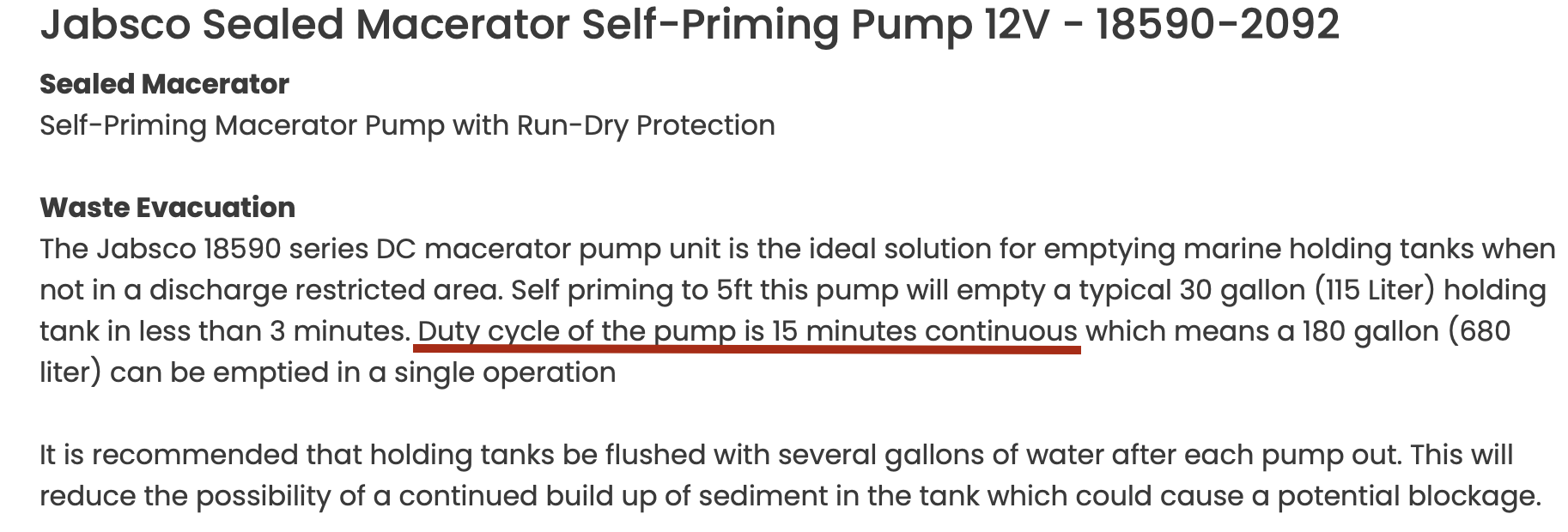

Cost now $190
Jim...
PS: I got one in 2021, $110 :clap:

Seems it would be okay since the discharge valve is shut when not in use. Kind of like the clear vinyl on the pumpout hoses I normally see. Still, though, one more connection for a possible failure point and a nasty one at that. @Rich Stidger what kind of hose did you use?
It is just 1" ID vinyl hose from the hardware store with 1/8" walls. Not reinforced, nothing special. I have had it in place for almost 25 years with no issues at all. It has a smooth bore so nothing sticks or accumulates. One of these days I plan to put a small LED to backlight the hose when the pump is running so I don't need to get my flashlight.
