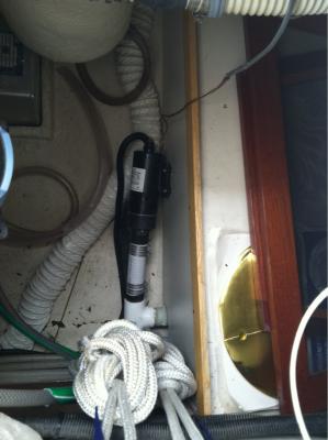

It is below the tank, but as boat access generally goes, it's relatively easy to get to.
gpd955
Feb 22, 2006
1,164
Catalina 310 Cape May, NJ

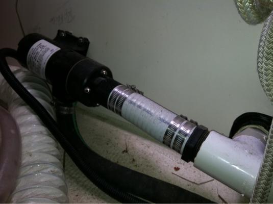

I don't know if this is an after-production installation but mine is mounted higher than the outbound waste opening. Although there probably would still be flow if there was waste in the tank.
I suggest you pump out first to limit the spillage and rinse the tank several times with fresh water while you're at the pump out facility. Maybe have some thru-hull plugs at the ready to cap the hoses off as soon as you remove them, and have some expendable towels to lay down.
I wouldn't pay someone. The wiring shouldn't be too difficult to figure out. It's pretty basic and if I can do it, probably everyone can!

Thanks guys...my installation is the original and looks just like your picture. I agree with your suggestion re the pump out. I interpret your comment to mean that given how high it's installed, there shouldn't be any leakage, but to be ready just in case.
