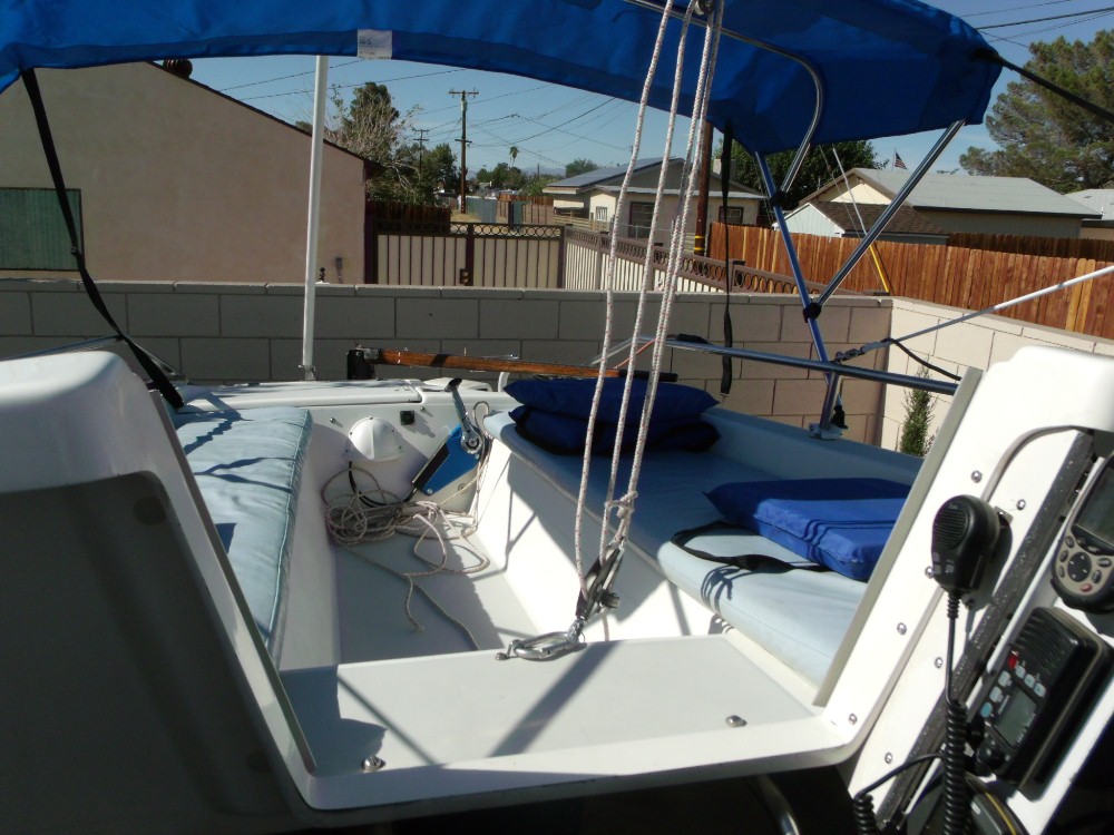

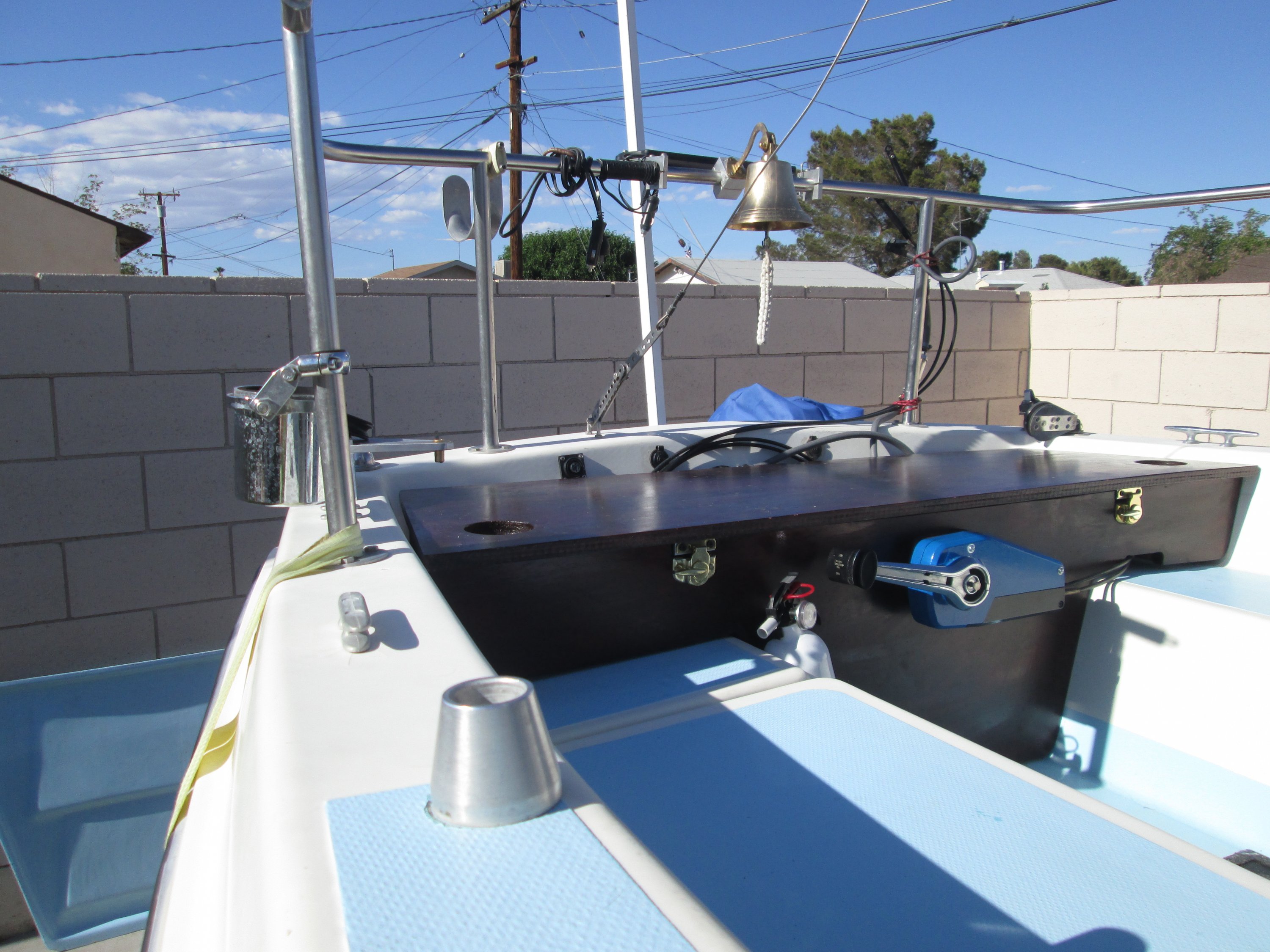

Budgates do you have a picture of your remote control box linkage setup of like to see that ???
Unfortunately I'm not as good as Sumner about documenting my work and I sold the outboard a year ago. Not wanting to reinvent the wheel, the new outboard that I purchased came with it's own remote control along with electric start, power tilt, fuel injection...
I'm assuming that you are more interested in the linkage but all I have is the a picture of the control box in each of the cockpits.

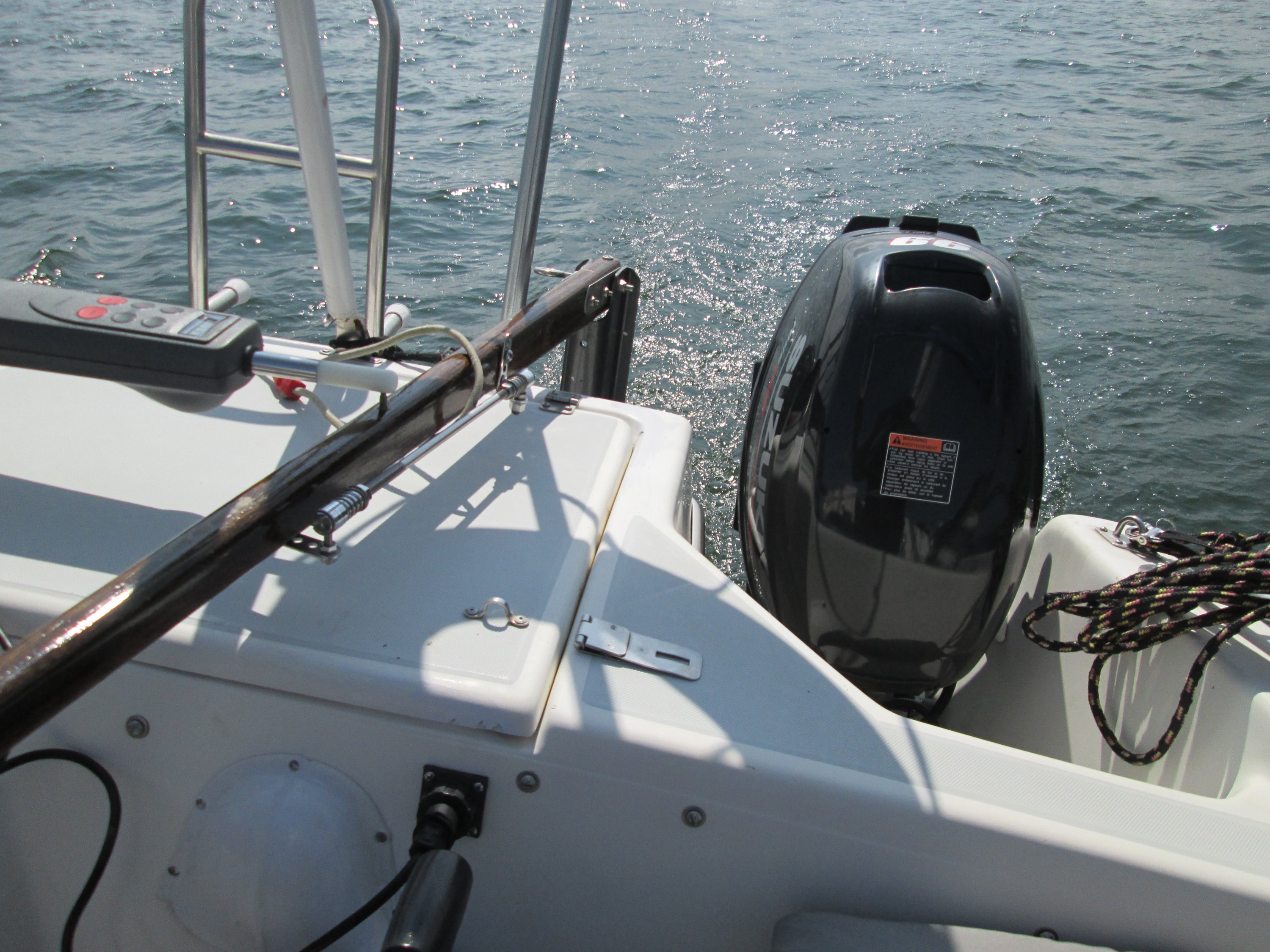

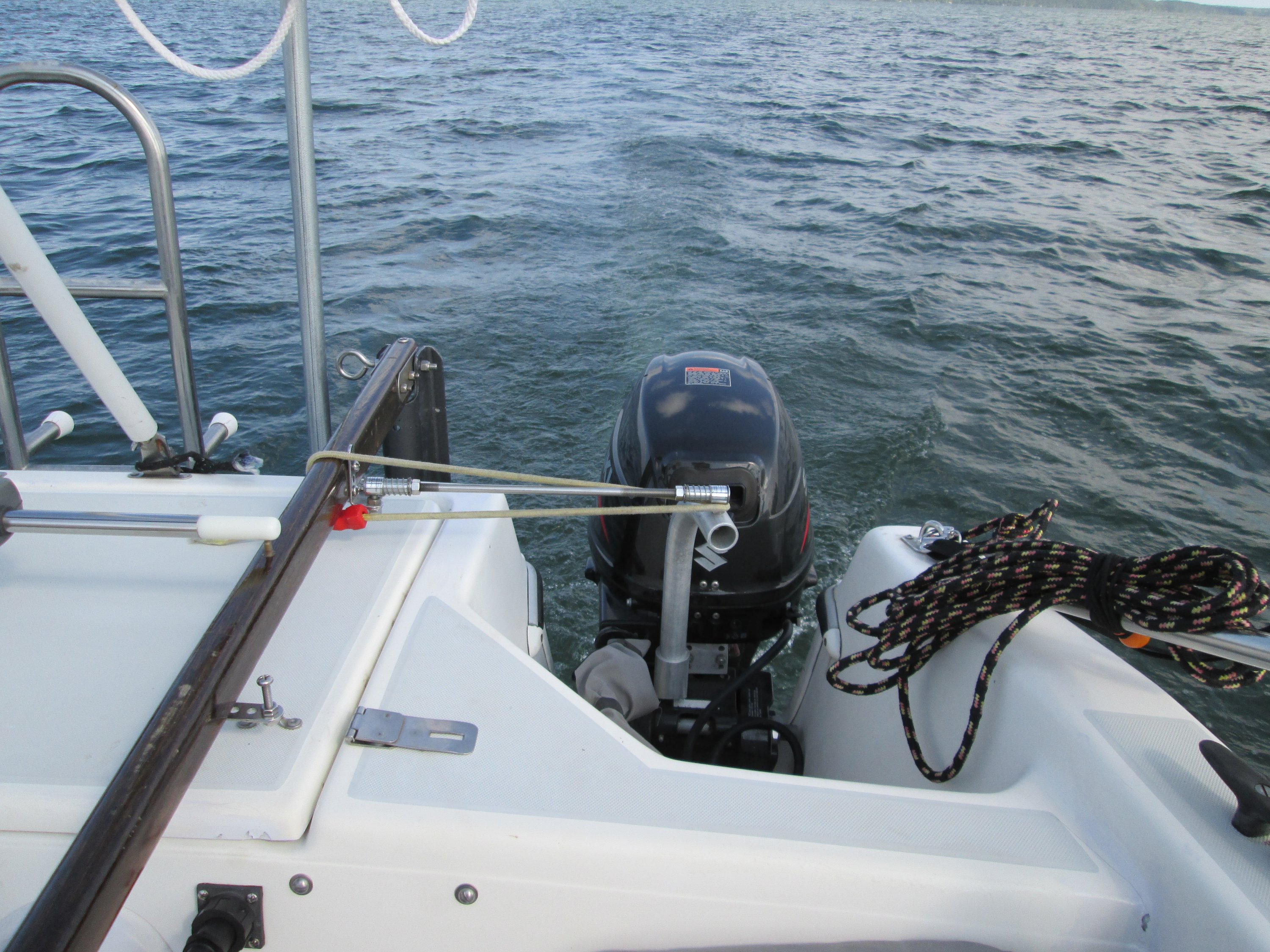

I finally got an opportunity to take a few pictures of my tiller to outboard linkage today.
Linkage in use:
Also shows the modified outboard tiller that allows full tilt and rotation.
The bungee cord helps eliminate rattling.
Linkage stored on tiller when not in use:
Linkage as purchased:
It's marketed for steering trolling motors but works great for linking the outboard to my tiller.

I used the same brand linkage Budgates did...which i figured out how to connect from what Sumner did... ;) In my case, i got a slightly longer linkage and bent it twice (two 45-degree bends) to make it reach down to where the front of the motor has a handle of sorts already cast in. I have some tweaking to do, but it works well enough to prove the concept.
I leave my rudder up (i have a line with pulleys to make it easy) and use ONLY the motor linked to the tiller when launching and final docking in the marina. I treat it like a power boat. I lock the tilt so I can quickly shift to reverse and gun it if needed to avoid a collision. Not a purist thing, but with the crazies standing off twenty feet behind me in their 35' center console fishing boats, i don't want to risk a maneuverability issue. I also drop the swing keel a hair.
Once I've cleared the docks and boats, I immediately lock the outboard straight, release the tilt lock, remove the connector linkage (both ends) and leave the linkage down in the motorwell in front of the engine. It's heavy and tends to stay put under the fuel line and such. I drop the rudder, secure the downhaul, drop the centerboard, and putter my way on out the channel, now steering with the rudder only.
