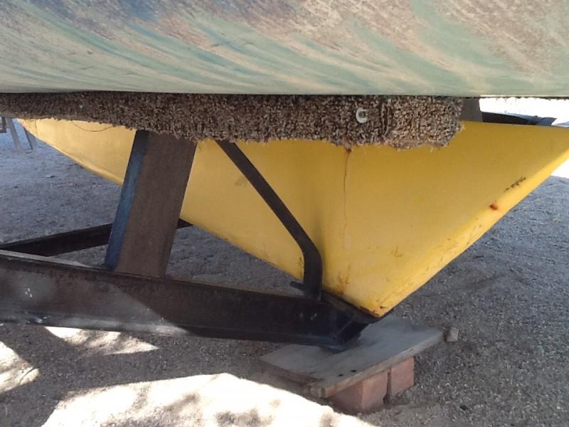

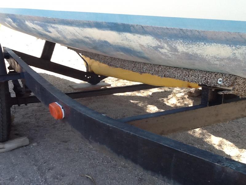

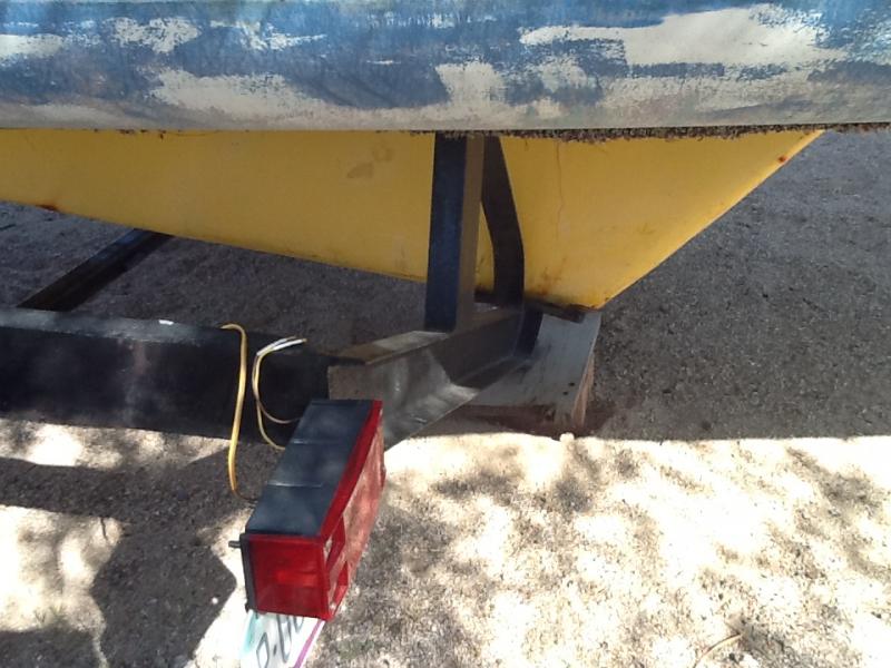

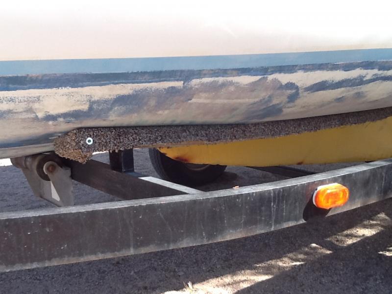

OK so now I have a trailer but the bunks are too low so the boat rests on the keel and the very front of the bunks when its on the trailer. I'd like to raise the bunks but how much do I raise them? What's the height from cross member of a trailer to the top of the bunks? And how far apart are your bunks?

Well the boat is about an hour away from home right now. Also it sits on the keel and 2 points on the very front of the bunks. That deforms the hull and looks like its putting a lot of strain on the hull so I'd like to get the trailer right.

Can you tip the boat to rest on one bunk and measure the gap along the other? When you float the boat onto the trailer to take it out the keel will be fully retracted then when ready for the road you will release the keel weight back down to be supported by the trailer during travel. The goal is keep the hull as low as reasonable and supported by the bunks and half the keel carried by the trailer(swing keel).
Dec 23, 2008
776
Catalina 22 Central Penna.
Measure where it now sits.
Without pictures, using your description of the hull resting on the front of the bunks, but the back end of the keel sitting on a cross member is lifting the aft end of the hull above the bunks will give you the measurements needed.
The ideal setup is that when the hull is resting on the bunks thus carrying the weight of the hull, the keel cranked up to it’s highest position would be above this trailer crossmember. The keel is then lowered down onto this crossmember to carry some of the weight of the keel, the hull weight must not sit on a swing keel! Again, ideally this clearance between the keel and the crossmember should not be very much, an inch or two, so that the boat is sitting on the trailer as low as possible to make for easier launching and retrieval.
The boat should ride on the trailer as low as possible, the keel should clear the trailer and bunks by a couple inches and then lower down for keel support after recovery.
From what you have described, I would measure to find the largest difference between the hull and the bunk. Add 1 to 2 inches for the clearance of the keel and then raise the back end of the bunks that much. If the hull is already touching the front of the bunks I would not change that measurement.
If after only raising the back end of the bunks, the boat looks like it is resting with the bow downhill, that would be perfect. Because of the angle of the launch ramp the stern always floats free first, the bow is where you have to back further into the water for it to float, so keeping the bow as low as possible is more advantagest. When the boat is parked on the trailer raise the trailer jack so the stern is level or lower to allow the rainwater to drain properly.
The distance between the bunks should be between 3 and 4 feet. The boweye attached to the front of the trailer will keep the forward part of the hull from moving from side to side and sliding to the rear. A strap over the stern attached to the trailer, near the area of the back end of the bunks will keep the stern from walking from side to side as the trailer bounces down the highway. I make this strap very tight and when I park the rigging I release some of this pressure until I tow again.

No, with the boat on the trailer is what you want!
Measure from the bottom of the HULL down to the top of the BUNK at a point where the hull sits on the bunk, not the trailer, not the keel.
Find the largest distance between the hull and the bunk at any point of contact!
Add the 1 to 2 inches to this measurement.
Remove boat.
Raise the back end of the bunks by the amount of this new measurement. Loosen the center supports of the bunks.
Place boat back on trailer with the keel all the way up. The keel should be 1 to two inches above the trailer cross member with the back end of the bunks raised this new amount.
Raise the center of the bunks up to meet the hull at that location.
Lower keel.
Tow.
